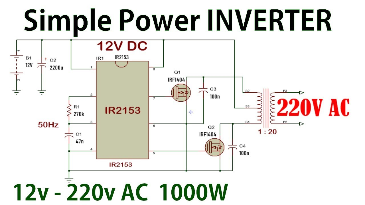

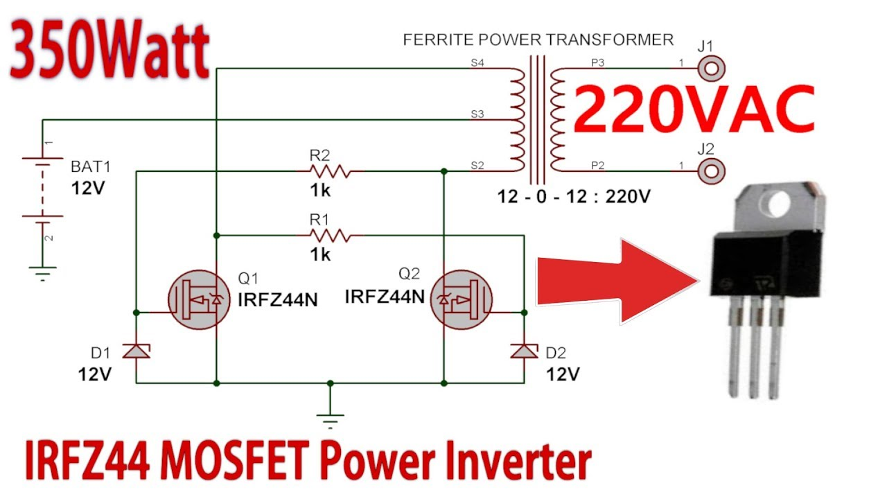

    google = self oscillating mosfet inverter
    Click image for larger version  Name:	image.png Views:	0 Size:	466.6 KB ID:	425154
    + https://www.tradewheel.com/p/high-vo...re-2043781/​
    change frequency to high (20kHz ) R1,C1 so you can use small ferrite core transformer.​
