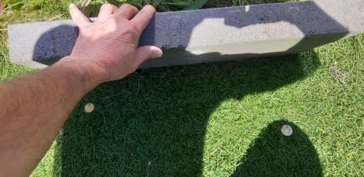

    I take two successive samples, TargetS and IdS. A level baseline TargetBase is created by low pass filtering (dynamic PI). The ID is the ratio TargetS/IdS. An ID baseline IDBase is created as the ratio of the low pass filtered versions of TargetS and IdS.
    A target temporariliy raises TargetS above the baseline TargetBase. The signal level is TargetS - TargetBase and it triggers a target signal, however, it is only accepted if its ID is different from IDBase.
    Two coins placed under a magnetically responsive tile:
    Click image for larger version  Name:	a.jpg Views:	0 Size:	47.1 KB ID:	425354

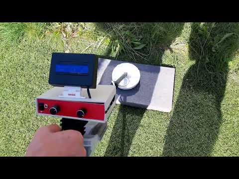

      Well done Teleno! Do you have to ground balance the detector or is it taken care of in your filters?
        You just move or hold the detector at normal working distance above ground until the beeping stops, then it's balanced.
        It takes some time cause the ID baseline filter updates slowly, so I've added a button that updates faster when you want to balance. For the impatient.
          Thanks, if you did the same test as in the video and then put a third coin in the grass, What would happen as you scan from the tile to the coin in the grass?
            I've just tried it and the coin in the grass is detected normally, then back to the tile and the other 2 coins were detected too.
            The behaviour is expected cause the ground ID is memorized, while the coin IDs are different. Only the ground ID is ignored.
                A test with a 0.7g (11 grain) gold nugget slightly above the center of the tile and a 22kt gold chain near the top left corner.
                  This GB seems realy stable. After 15 minutes of operation the detector was still balanced.
