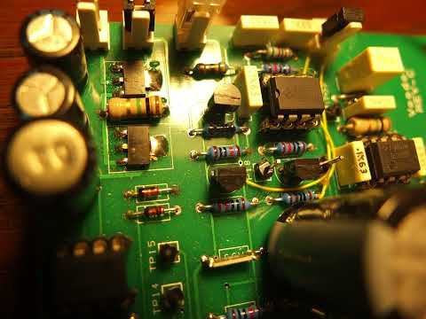

    I build a voodo metal detector. but it doesnt work. IN PI mode the damping of the coil is constantly changing.(you can see tp 2 and tp 5 in the video)
    I dont know where my mistakes are. pleas help me

    Do you have any photos of the PCB?
      Ok I am happy to give more informations.
      I have this problem wit all the coils i tried. the PCB is made by JLPCB and I only used new components. the display and the microcontroller work. tp 2 is ok too.
      here are some photos in a video because I dont figure it out how i can upload photos here

          I simply populate the whole board. My power supply is perfect
            Bad solder joint? Or bad connector contact?
              I cant see a bad solder joint and the connectors seem to be ok too
                R6 looks a little suspect, try replacing it with a short. A bad solder joint isn't always easy to see, try re-soldering joints especially right around the coil & TX. Try hard-soldering a coil to the TX pads, anything from 250uH to 1mH.

                  R6 works. On Friday I will try resoldering the joints and I will try to hard-soldering a coil to the TX pads.then I telled my results.
                  Could it be a problem that i use a cheap multi turn trimmer as damping resistor?
                    Possibly, trimmers are not intended for such a high voltage. It could be arcing.

                        i found the problem. the problem was the multi turn trimmer as dampging resistor in a few hours i give more deteils
                          I first measured the value of the trimmer when the curve is critical damped. I was very confused that the value was 2 ohm. when I changed to test, the to 2 ohm adjusted trimmer with a normal 2 ohm resistor the curve was completely different. then i used a normal 500 ohm damping resistor an i had a great curve. I the original trimmer I cant find, but they were similar to this trimmer https://www.amazon.de/GTIWUNG-Potent...9&sr=8-10&th=1
                          What is the problem with this trimmer. I use this trimmer in other places in my voodoo detector to. will that make problems
