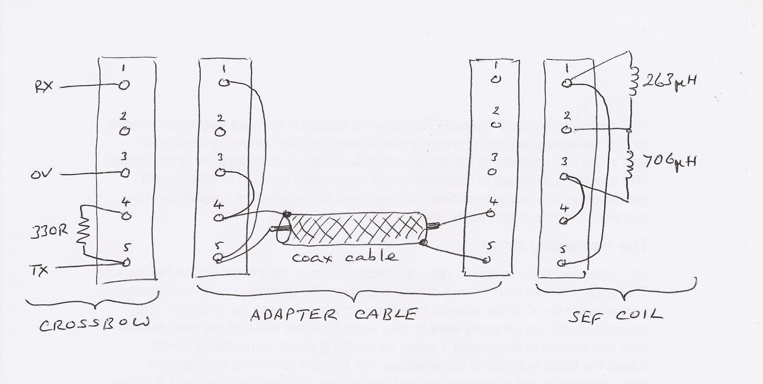

            Finished the board and was successful, I am now looking for a suitable coil as this will be mostly a beach machine. Is there any advantage to an open pi coil design like the 12x15 sef detech vs a flat wound coil like the coiltek elite series? I see the flat wound coils on detectors geared towards nugget hunting no so much coin shooting and beach detecting like I will be doing. I’m looking for commercially produced coils geared more towards the gpx line as I already have a shaft that will that coil ear mount spacing.
              This might help (see attachments).

                      Yes the coil was connected. I’m using a gpx coil With the 470r resister on pl3 between 0v and rx.
