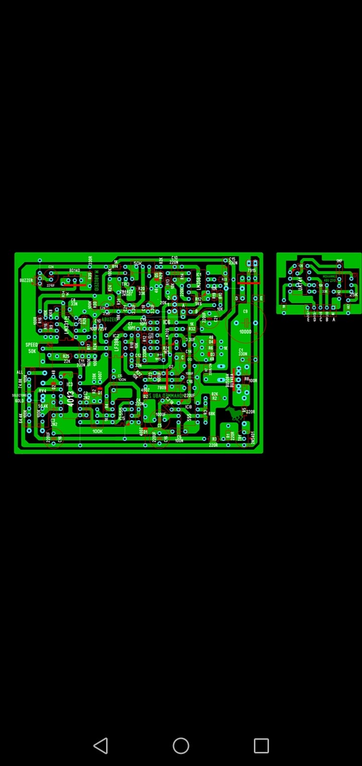

    I'm asking you, I'm looking for a TL12000 detector lay file, please help me. I made three different files from the internet, but I couldn't run them.
    hi

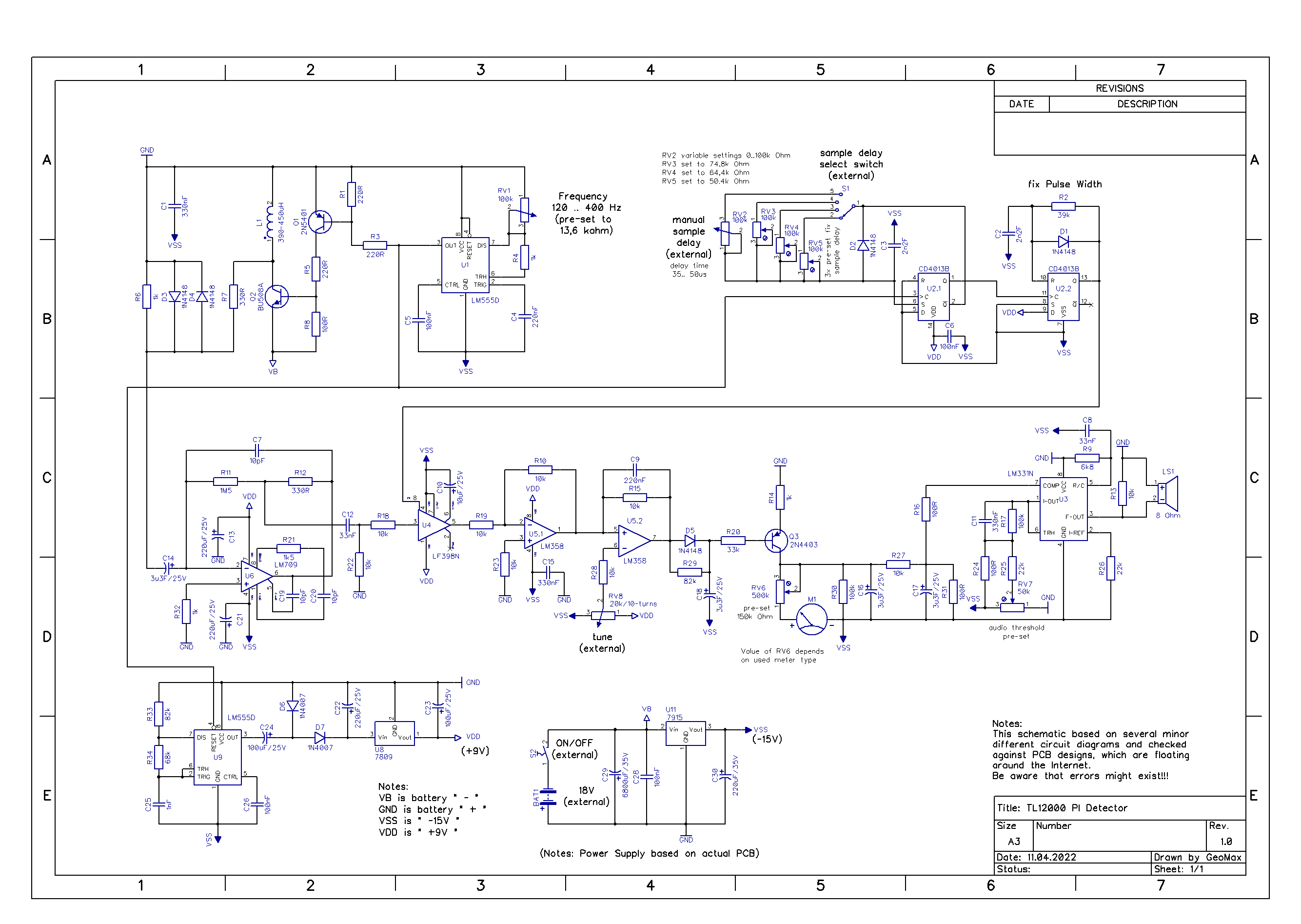

    The circuit schematic is wrong, but the parts are correctly placed in the printed circuit board.
    What is your problem exactly? ​
      Here you have a gerber file.

        Hi
        The schematic is NOT wrong because it is NOT based on the same PCB or the component placement file you posted above!!! Please READ the information on the schematic!
        After reading the notes you will know on what basis this schematic was created. Also note that the schematic file name called "TL12000x" this is also a hint that it is not the "TL12000" schematic.
        Actually there are many more TL12000 schematic and PCB versions of what is posted to be found in the Internet. The above schematic is the most reasonable schematic where errors and mismatch between all circuits were corrected. In order to get a working TL12000 you need to make a new PCB from this schematic. NON of the PCB's which are floating around the Internet are matching 100% this schematic. I analysed all available TL12000 schematics from the Internet and all schematics I found had some errors or circuit design issues!!! Some schematics might work (some how) but they still contain circuit design issues.

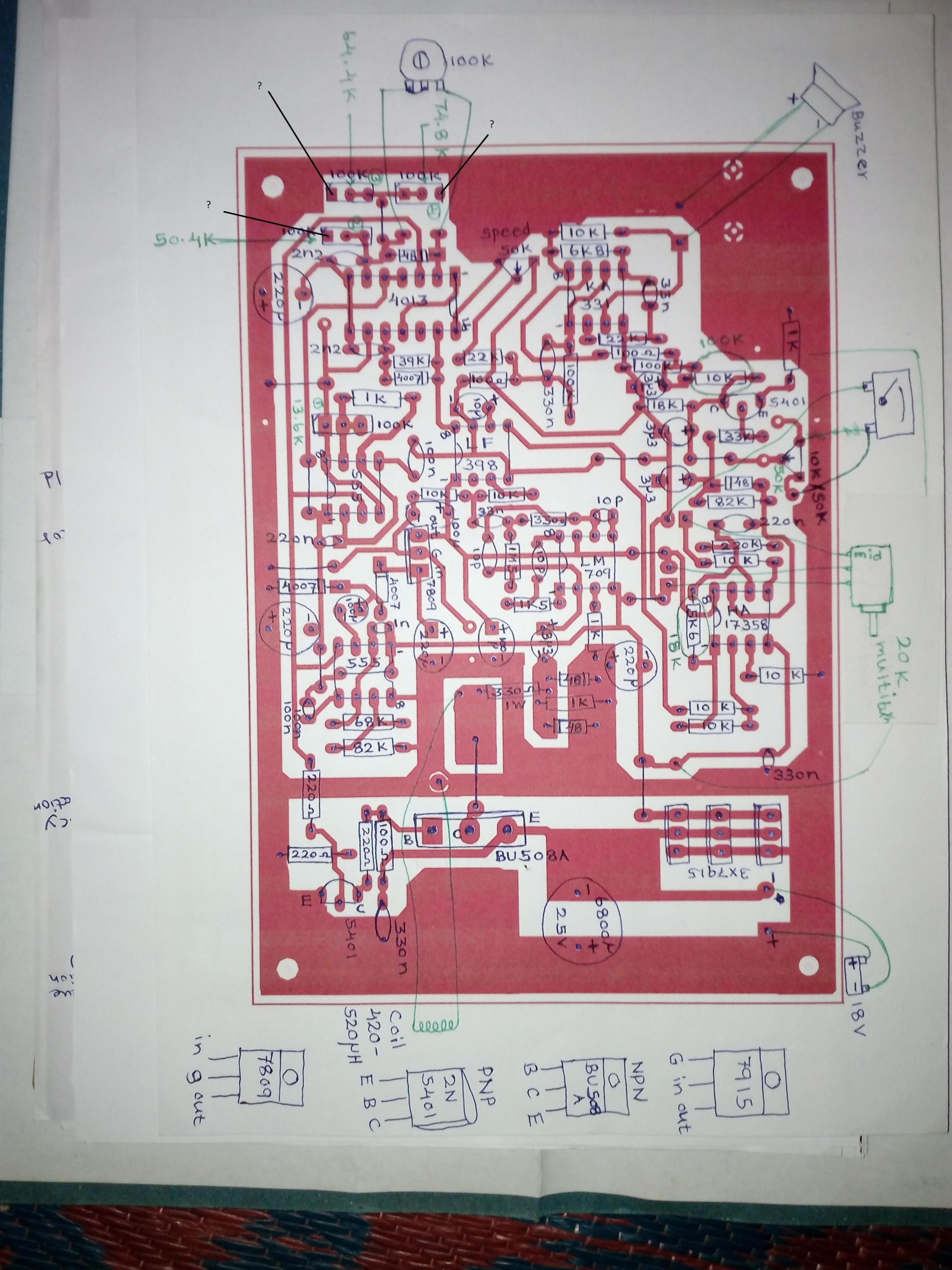

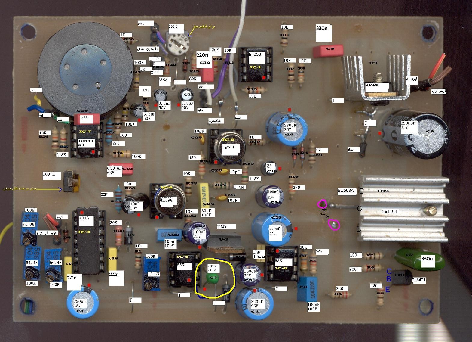

          I found a new lay file, I did this, but it still works, the potentiometer is on, 555 is on, I don't understand - 15 7809 + 9volt potentiometer is connected, why?

                  TL12000_Mohammed.pdf
                    Hi haylaz0036
                    no, I do not know a working PCB layout. And I never made a PCB for the schematic as well. I re-drew the circuit only for reference.
                            Hi
                            Is it possible for you to upload a clearer picture of the fiber circuit?
                              Mr. Roshik here is the pdf
