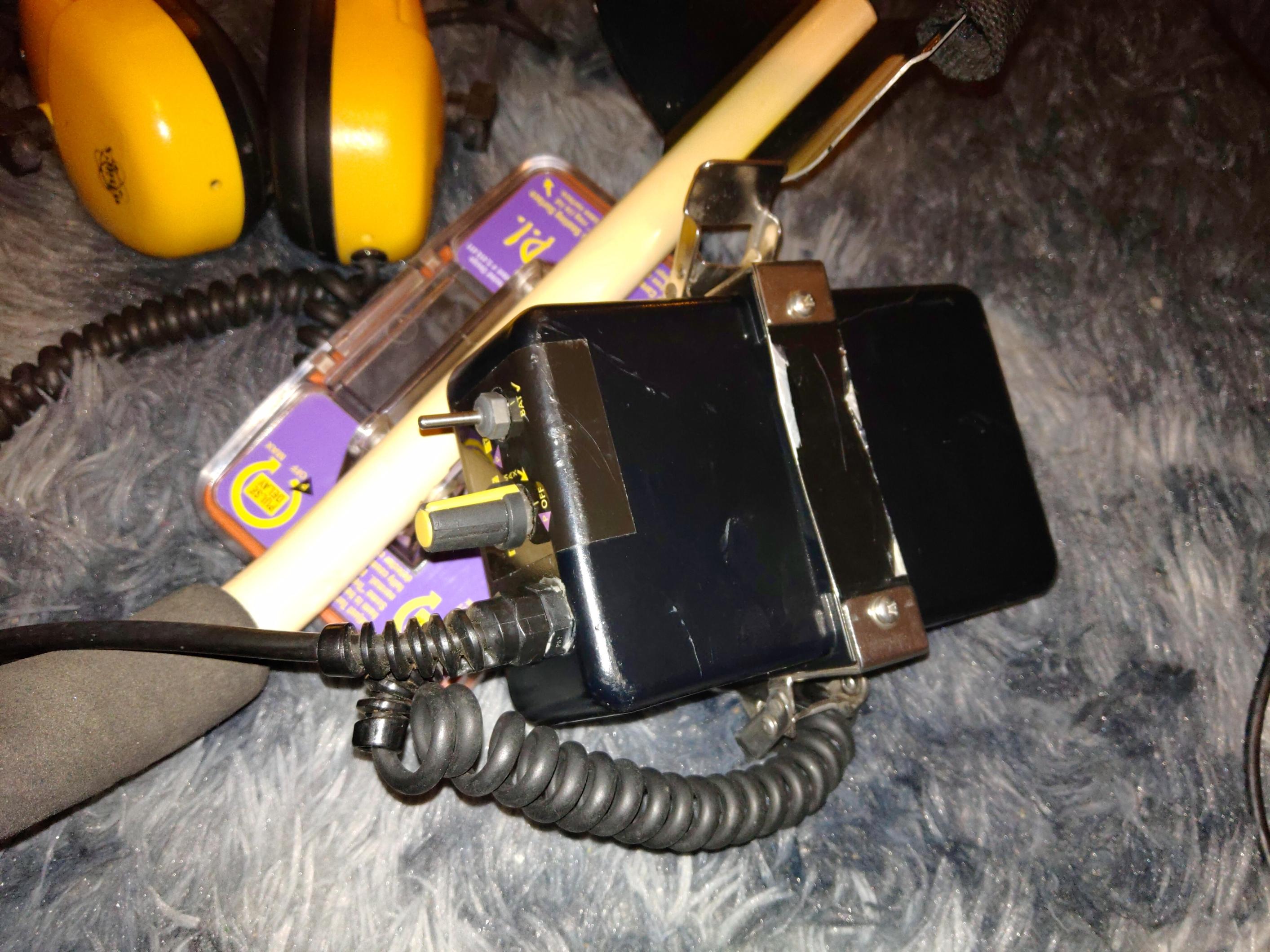

    Hi all.

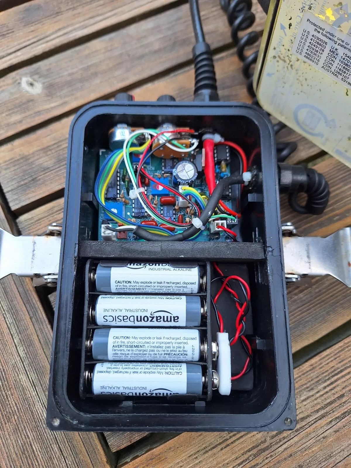

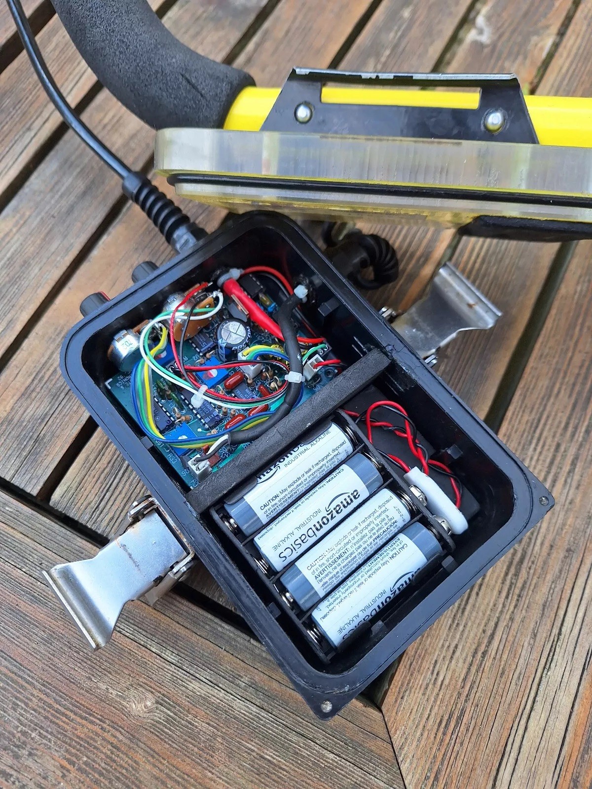

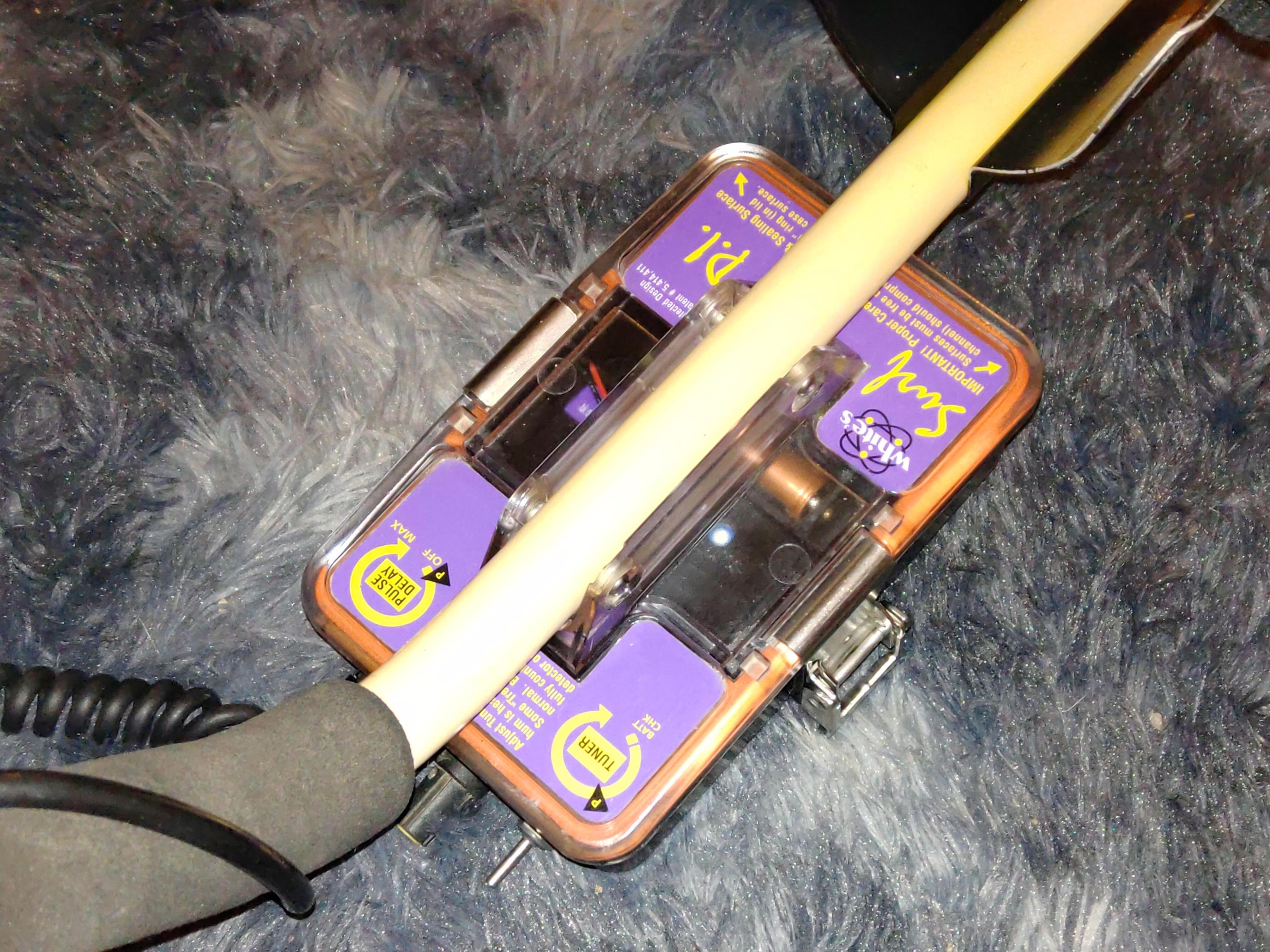

    i was wondering is anyone in the UK has this PI detector and can tell me what in air depth that they get on a copper 2p coil. i bought this machine for £20 last week. it needed a good clean as the person i got it off. the detector had been in a shed for quite some years. i did have to get a new battery holder and replace the battery terminal cable with the plug end on, as they both had a lot of green corrosion on them. also there was a small part on one of the traces on the circuit board that had corroded away that i had to bridge with a wire. the machine seems to be working now, but with not owning one of these machines before. i don't know if the detection depth on it is correct or not. it seems a bit on the low side to me. i get at a push 7" with the 2p coin in air.
    thanks in advance.....​

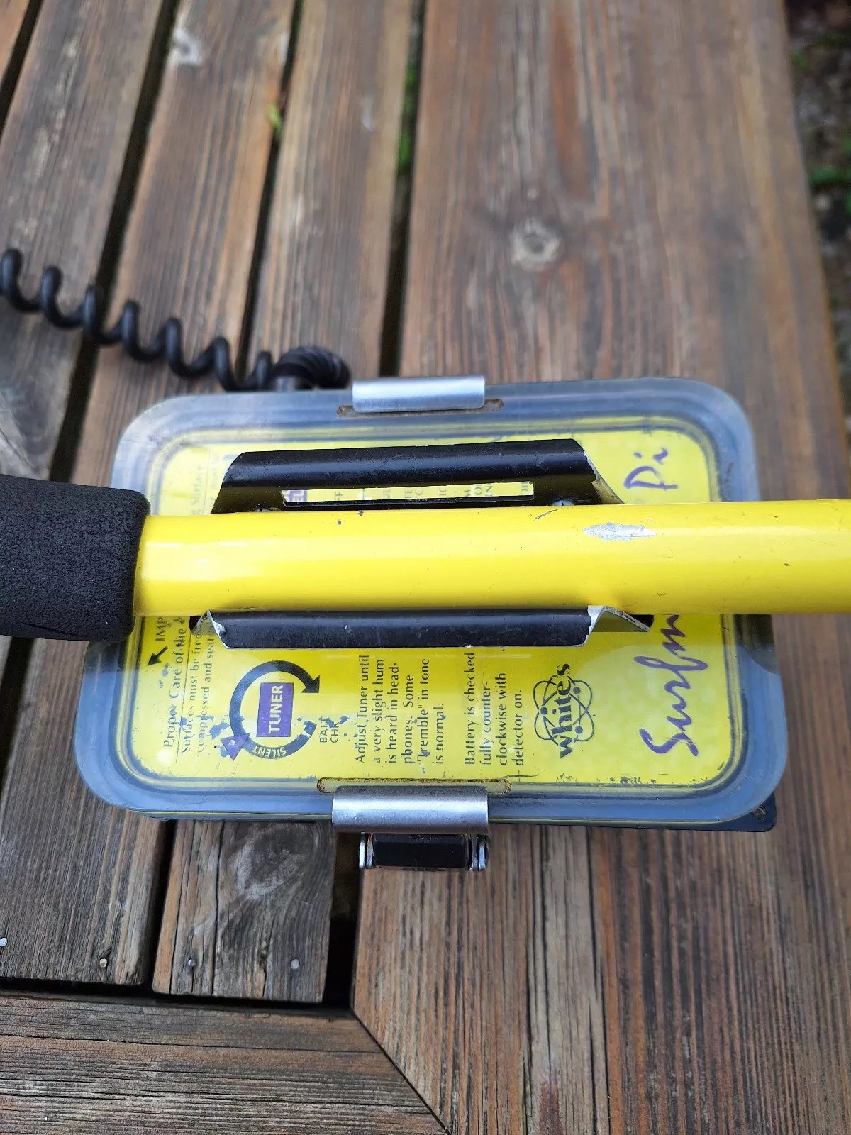

    I have the same detector, except that it has the yellow control box. I think your detector is a slightly newer model.
    A copper 2p coin is loud at 7", definite signal at 10", and faint at 11".

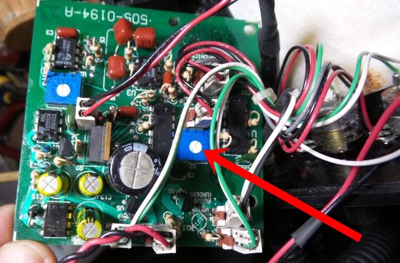

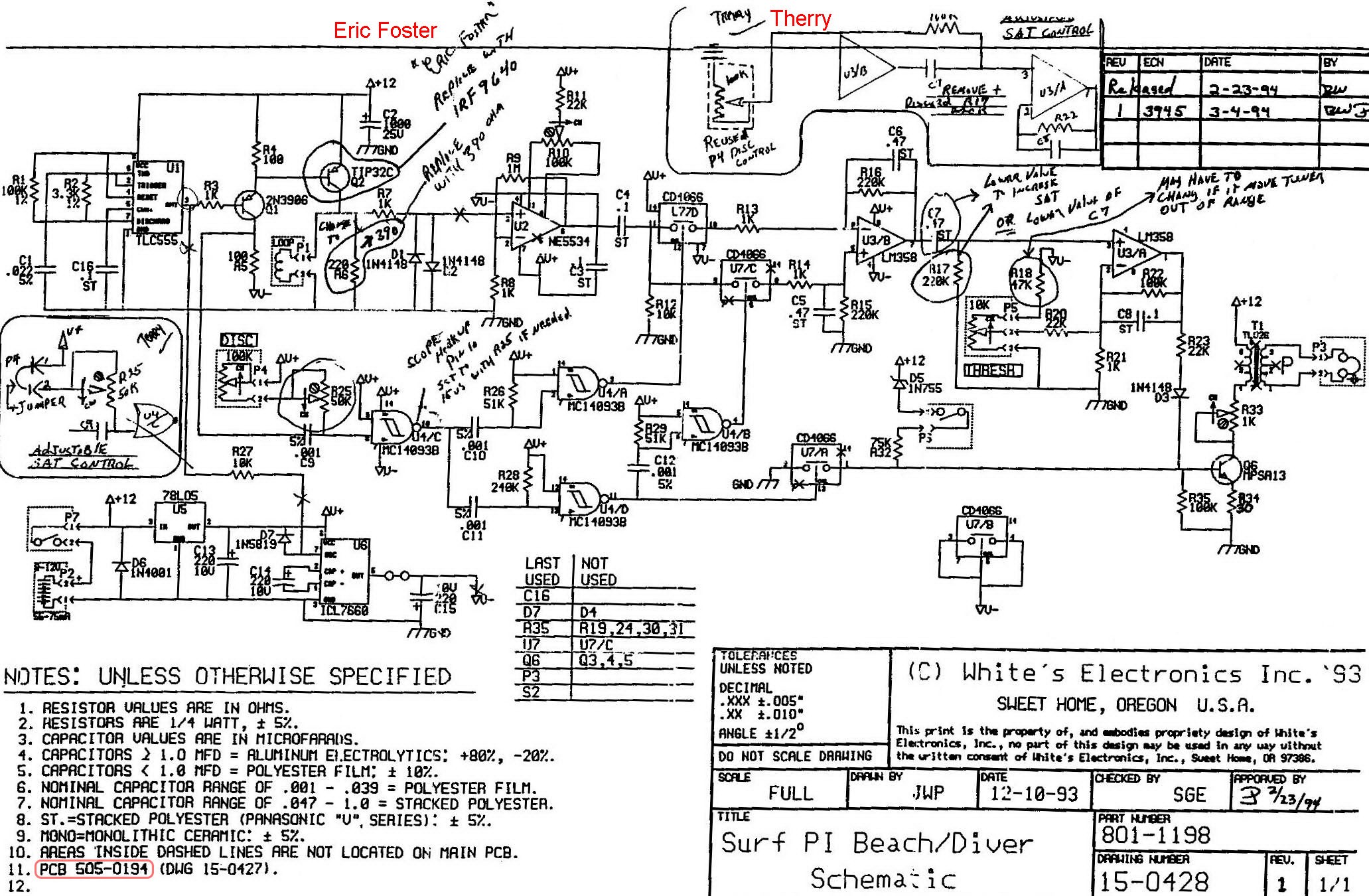

            If you have an oscilloscope, then you could check the calibration. Perhaps someone has messed with the DISC trimmer. That's the one in the middle of the PCB, and it affects the sample delay.

              not my board, but do you mean this one.

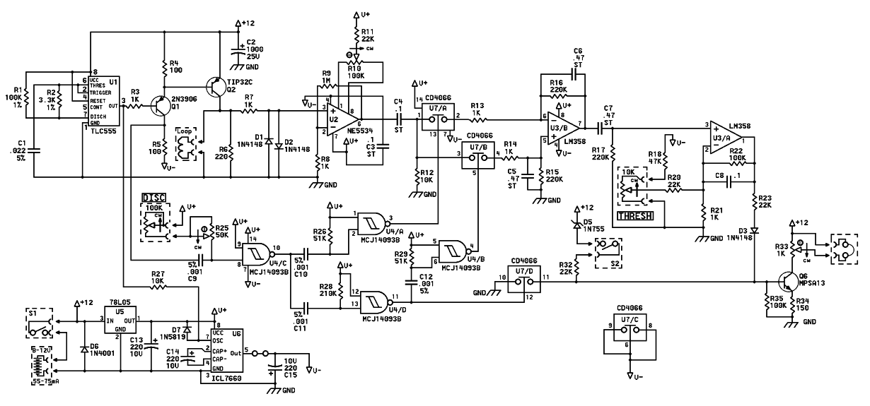

                That PCB looks different to mine. The one I have has 3 trimmers.
                One is next to the NE5534 (preamp) to adjust the null offset.
                The second is next to the MPSA13 (audio output transistor) to adjust the volume.
                The third affects the sample delay. It's labelled DISC on the schematic, and should be near the 4093B IC that controls the main sample and EFE pulses.

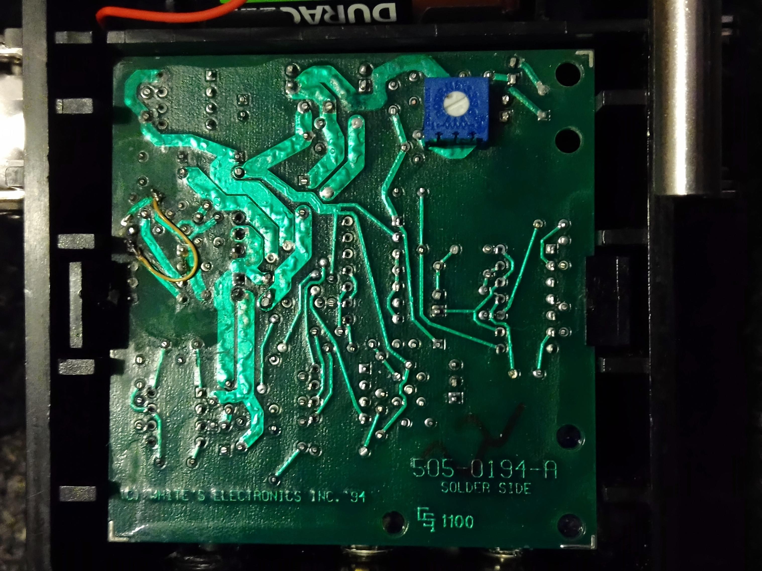

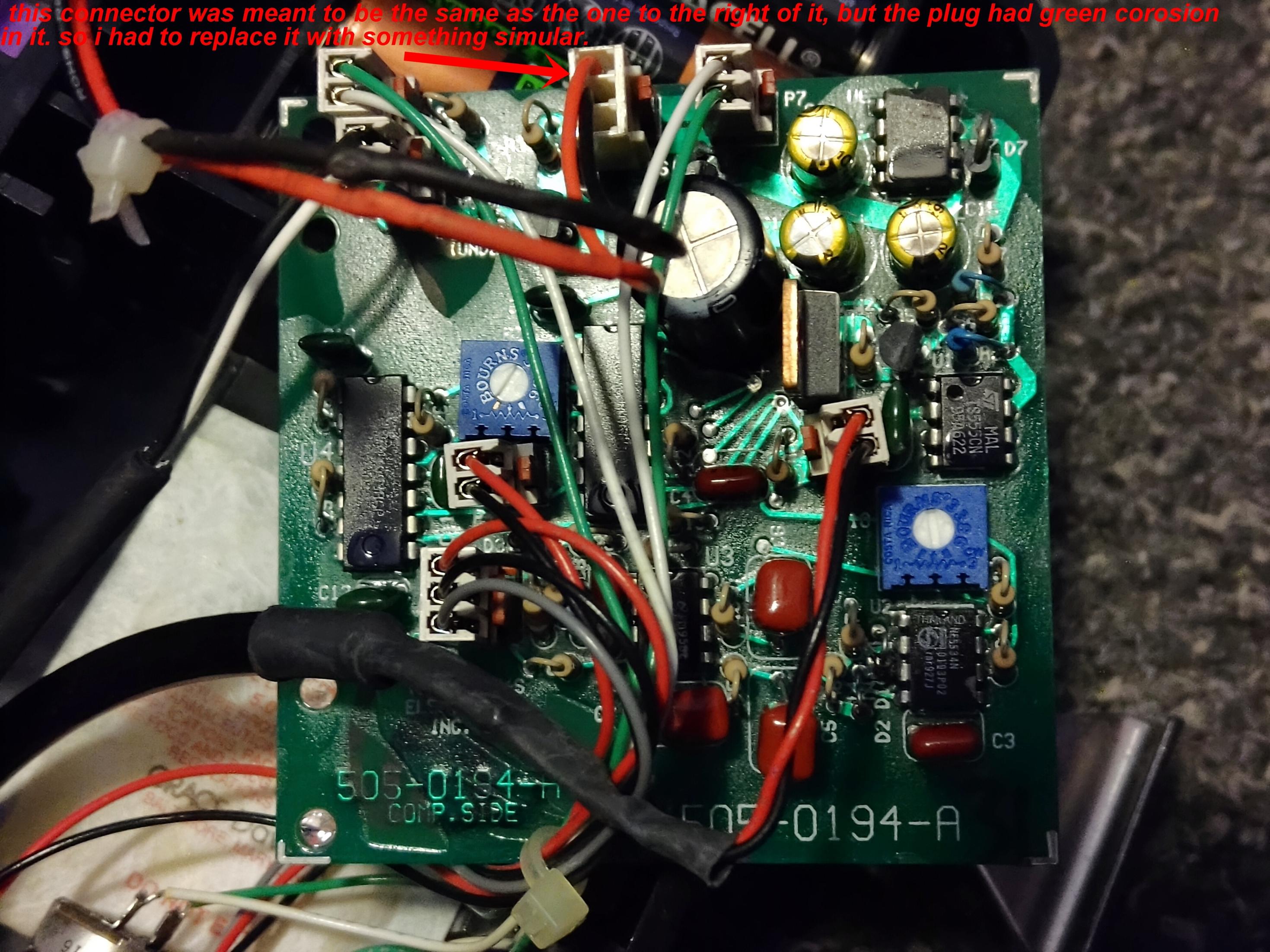

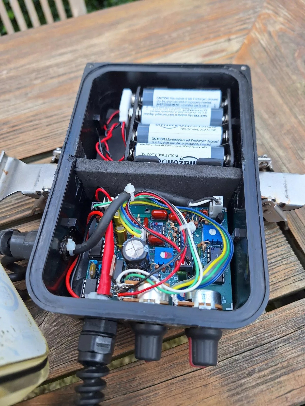

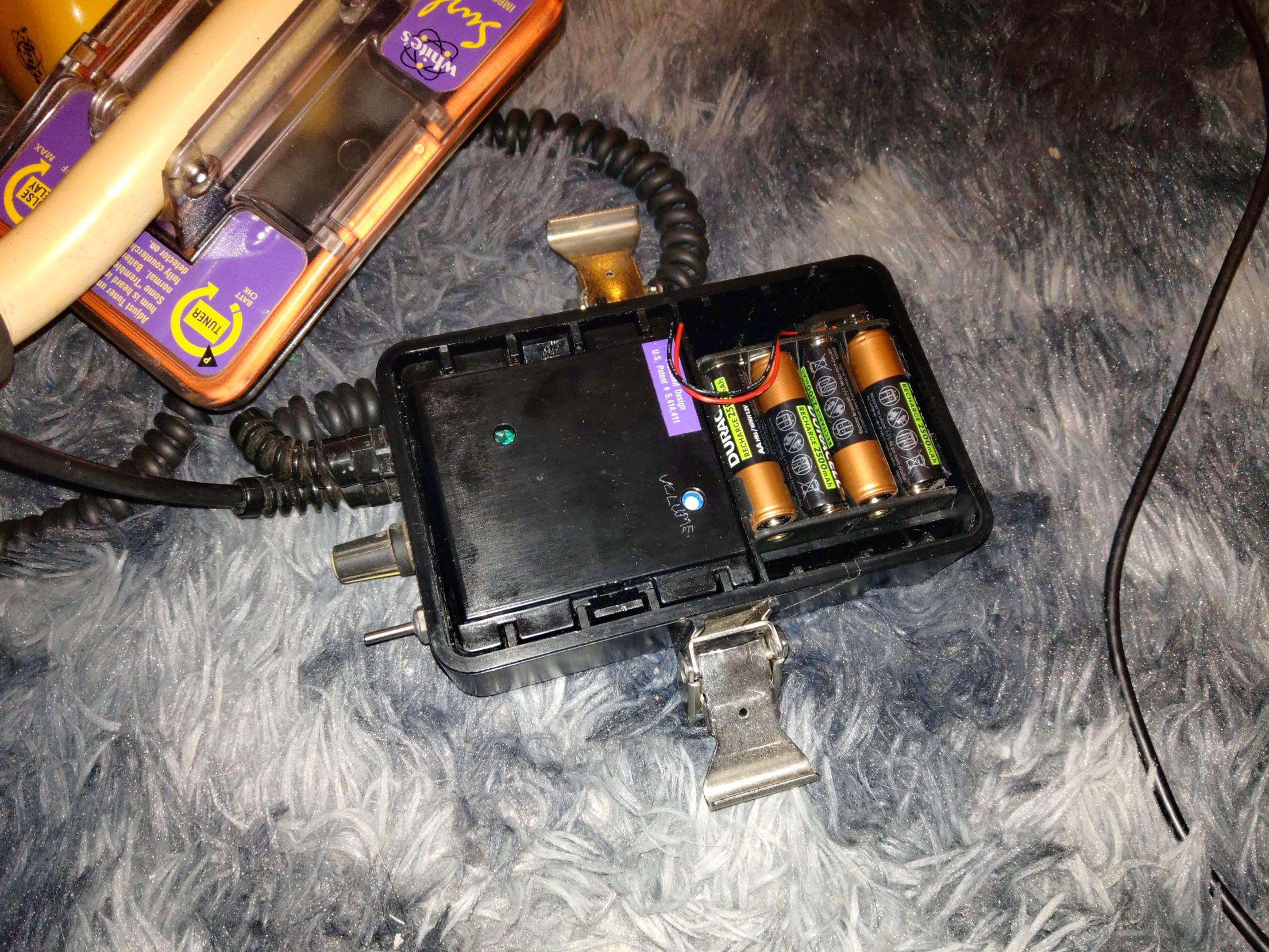

                  i will take out the board in mine and take some photos......
                    here is two photos of the board.....
                      The pot on the right adjusts the offset of the preamp (NE5534). It's halfway which is about where it should be. Messing with this is unlikely to affect depth at all, until you go too far and you lose a lot of depth.
                      The pot on the left sets the minimum sample delay. What you might try is to set the user control for the sample delay to minimum, and then adjust this pot and see if you can squeeze out a little more depth.
                      The pot on the back side adjusts the volume.
                        the IC chip in the top right corner of the PCB looks a little damaged... Maybe there is a problem there too. ​The three capacitors in the top right corner also don't look "healthy" or it's just the angle of the picture. I would check them too.​
                          what type transistor you see in TO-220 enclosure? thx for pics, it is 505-0194 board.
                            schematic with mods. Click image for larger version
Name:	surf PI mod_sch.jpg
