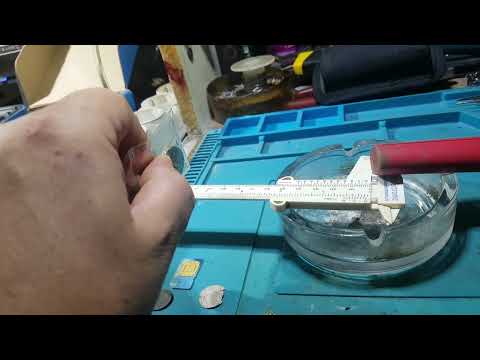

        I did this 10 months ago.
        Sens is not at maximum I think:
          Bad batteries, I forgot when I put them in the PP.
              Many thanks Ivconic, much appreciated. Looking at yours the performance seems similar to mine.. I will try and do some measurements. I've purchased and await some US coins so I can compare mine with some of the US youtube videos too. Thankyou!
