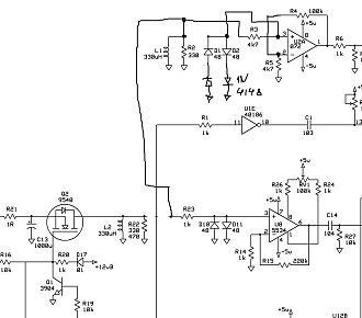

    Despite the pains, boredom is a much stronger "pain"; I tried to draw a schematic so that it would be clearer. I probably made some mistake, it should be checked. (Click to enlarge)

      Your scheme turned out to be completely different.
        Yes, I probably mixed it up, I drew it out according to the "hybrid vlf ver 1.22.2.pdf " document.

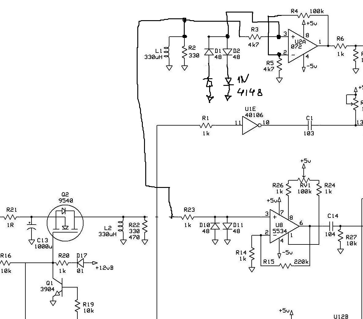

                            This project not died! The problem of this project is lack of Ground Balance feature. In my new topic "Bipolar PI MD with GB and DD Coil" from 04-16-2025 this feature is added. Some detectorists like Ivconic think that ground balance feature is not very useful for PI detectors. Other detectorists like Riss think that this feature is very important. Only your practice at your local ground conditions will have the last word for your choice.
                              This connection minimizes the ground effect. Tested with DD and OO coils​

                                Hi scs-bg,
                                The original schematic of hybrid detector from DFBowers ( version 1.07) uses 300uH TX coil and 300uH RX coil. You use 2 x 330uH coils with DD or OO configuration. It is interesting for experimenting. Thank you for this information.
