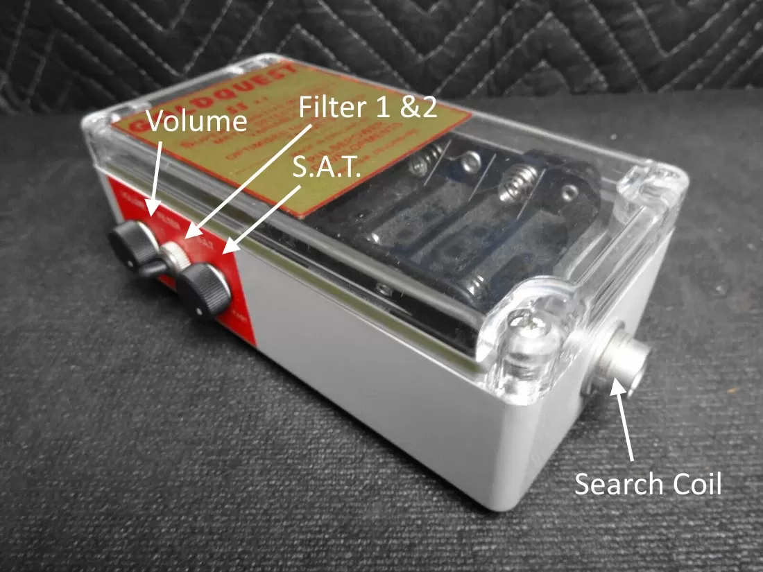

    Below I have some questions about filters 1 and 2 in GoldQuest SS V2.
    Eric Foster built the GoldQuest detector in various versions over several years. There was the GoldQuest, GoldQuest SS, GoldQuest SS V2, and GoldQuest V3.
    Compared to its predecessor (GoldQuest SS), the GoldQuest SS V2 features an additional filter 1 & 2 functionality.
    Reg Sniff once commented on these filters 1 & 2 as follows.
    “… The GQ and the GQ V2 are again, almost the same except for the addition of a second filter and maybe the changing of the coil connector. Again, the controls are fundamentally the same.”
    And that this dual filter is supposed to suppress interfering ground signals.
    “… and the dual filter to minimize bad ground signals.”
Name:	Goldquest SS V.2 Pulse Induction Metal Detector Made by Eric Foster (2m).webp
    Image of a GoldQuest SS-V2 detector
    Now my questions.
    1) Which "bad ground signals" are suppressed by these filters 1 & 2?
    2) What signal frequencies are suppressed?
    3) What might such a two-stage/dual filter circuit look like?
    4) How does it work together with the S.A.T. function?
    Any ideas? Thank you in advance for your input/help.

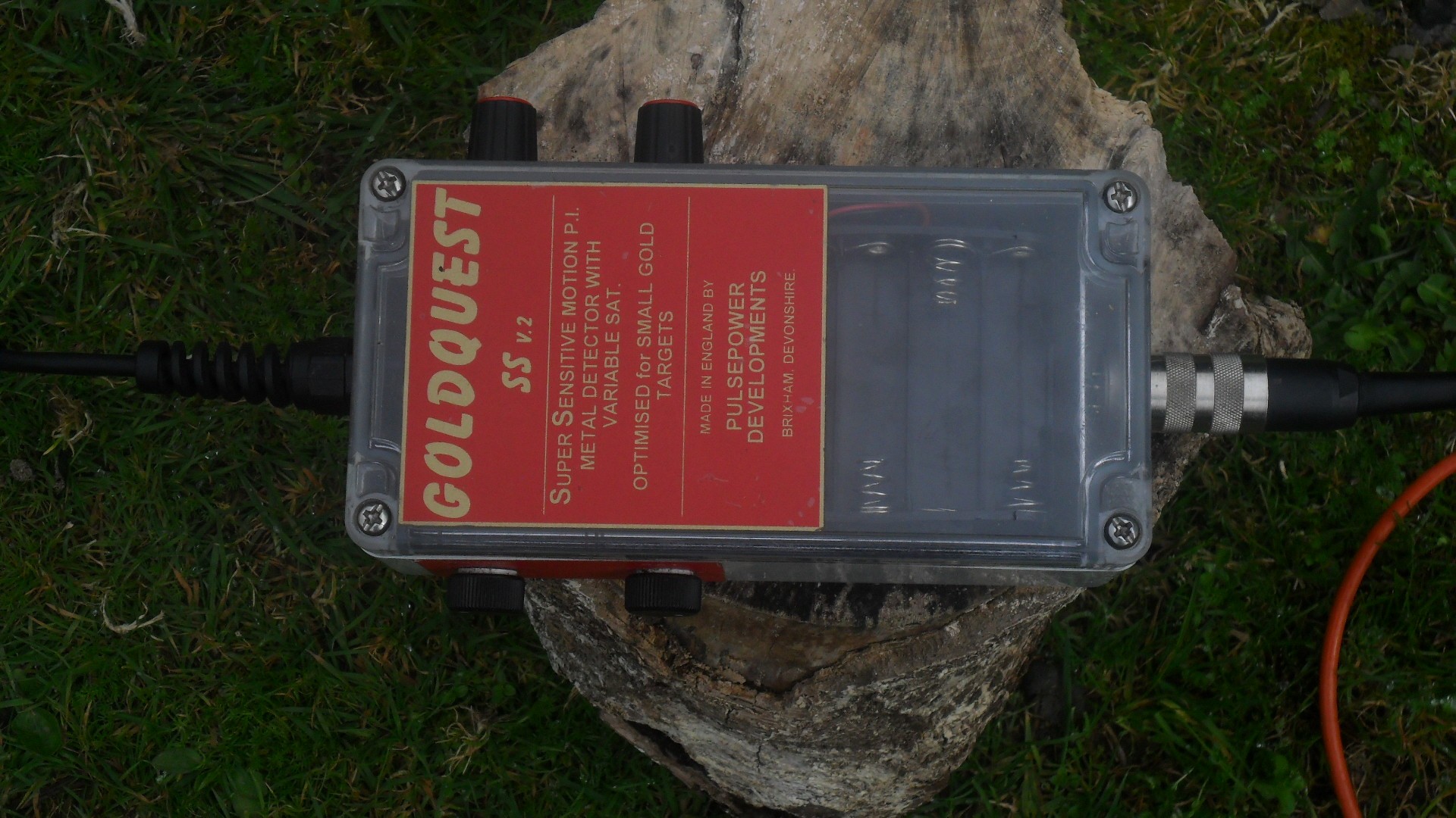

        Are you sure that this is GoldScan SS V2 picture? I have picture of GS SS V2 from one guy from NZ. Hi sold this type of MD and hi attached the picture. In this picture no switch for "Filter 1 or 2" choice. Attached is this picture. Unfortunately this not answer for your question for the real function (difference in the settings) of this switch.

            Yes, it's confirmed: GoldQuest SS V2. I checked my pictures. It seems that Eric probably built two different versions of the GoldQuest SS V2. One with Filter 1& 2 and one without these Filters. While checking my pictures, I also found two different versions of the GoldQuest SS. The GoldQuest SS Version 3 looks completely different from the case, but also has these filters 1 & 2.
