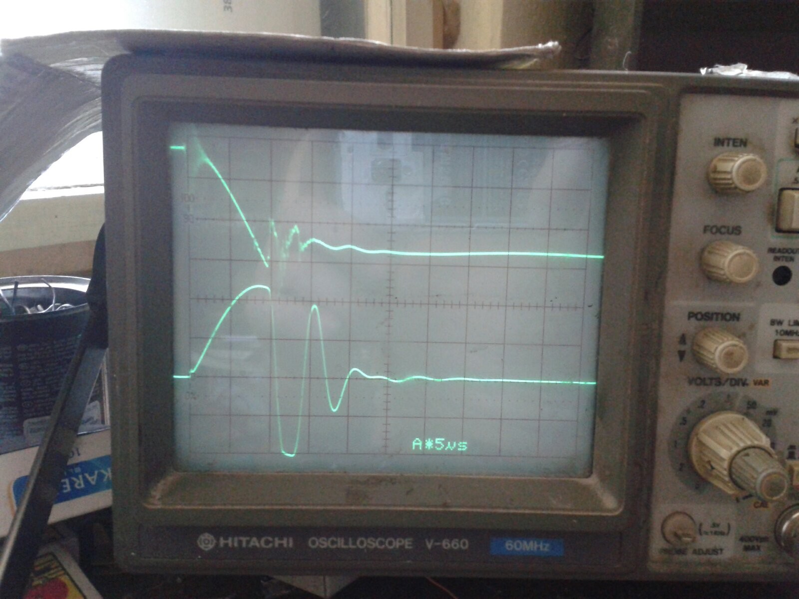

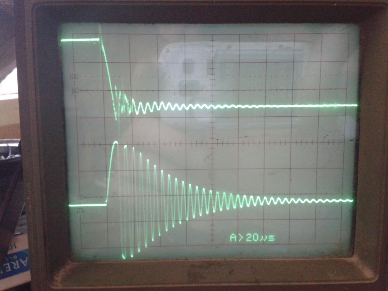

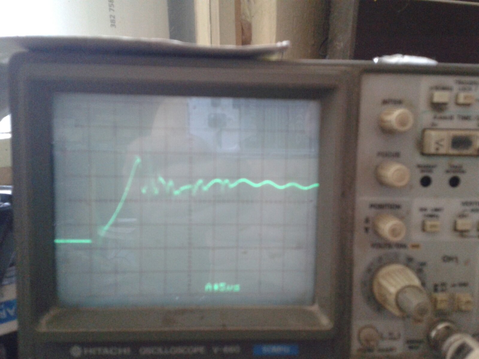

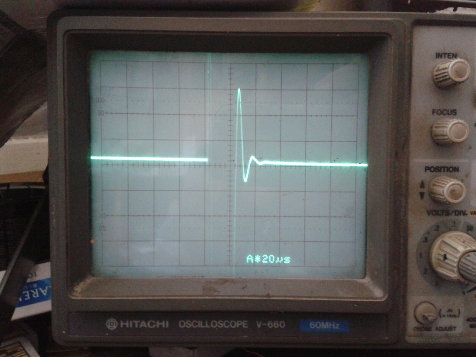

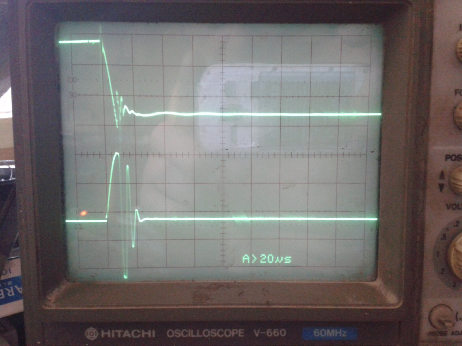

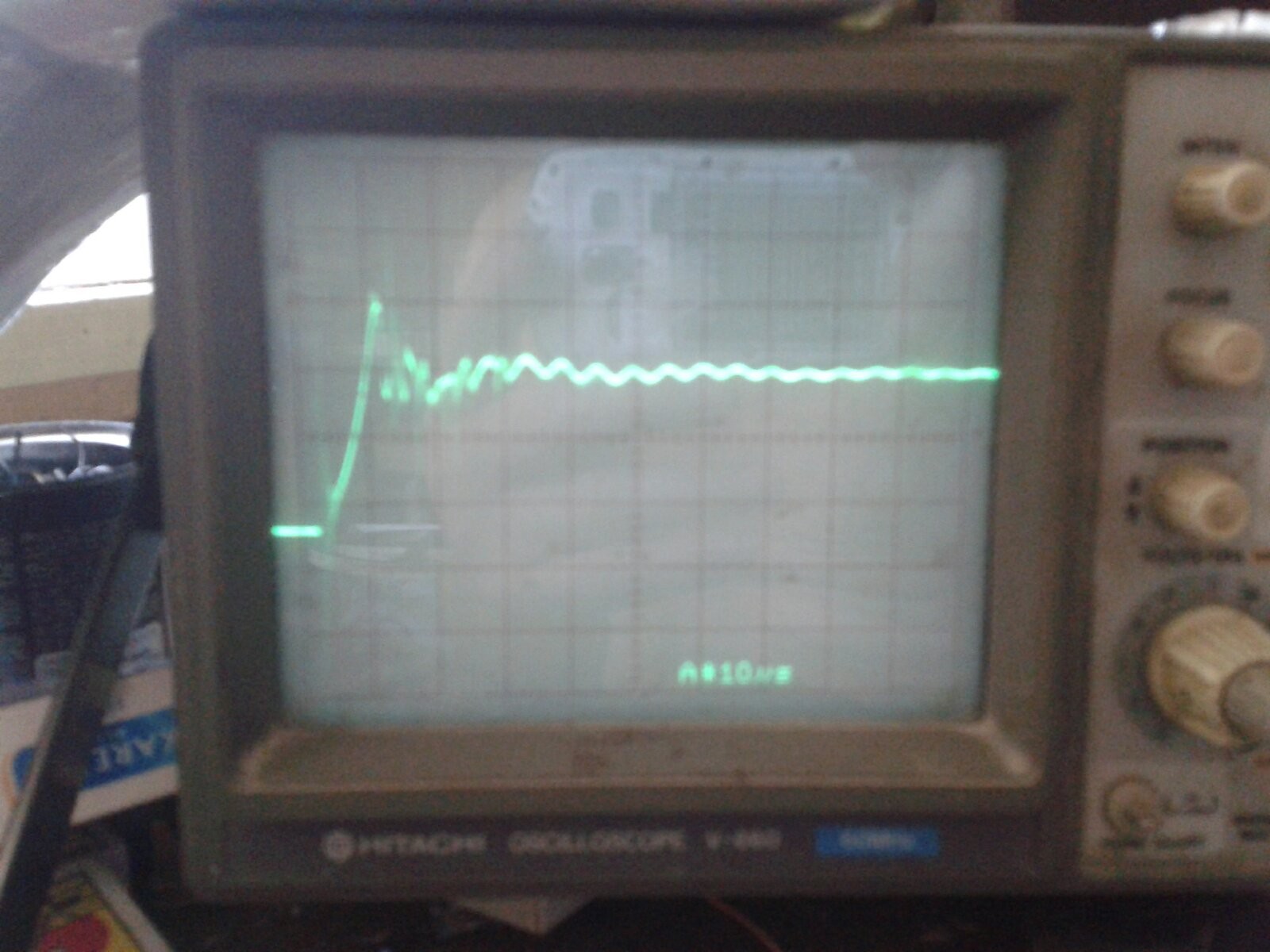

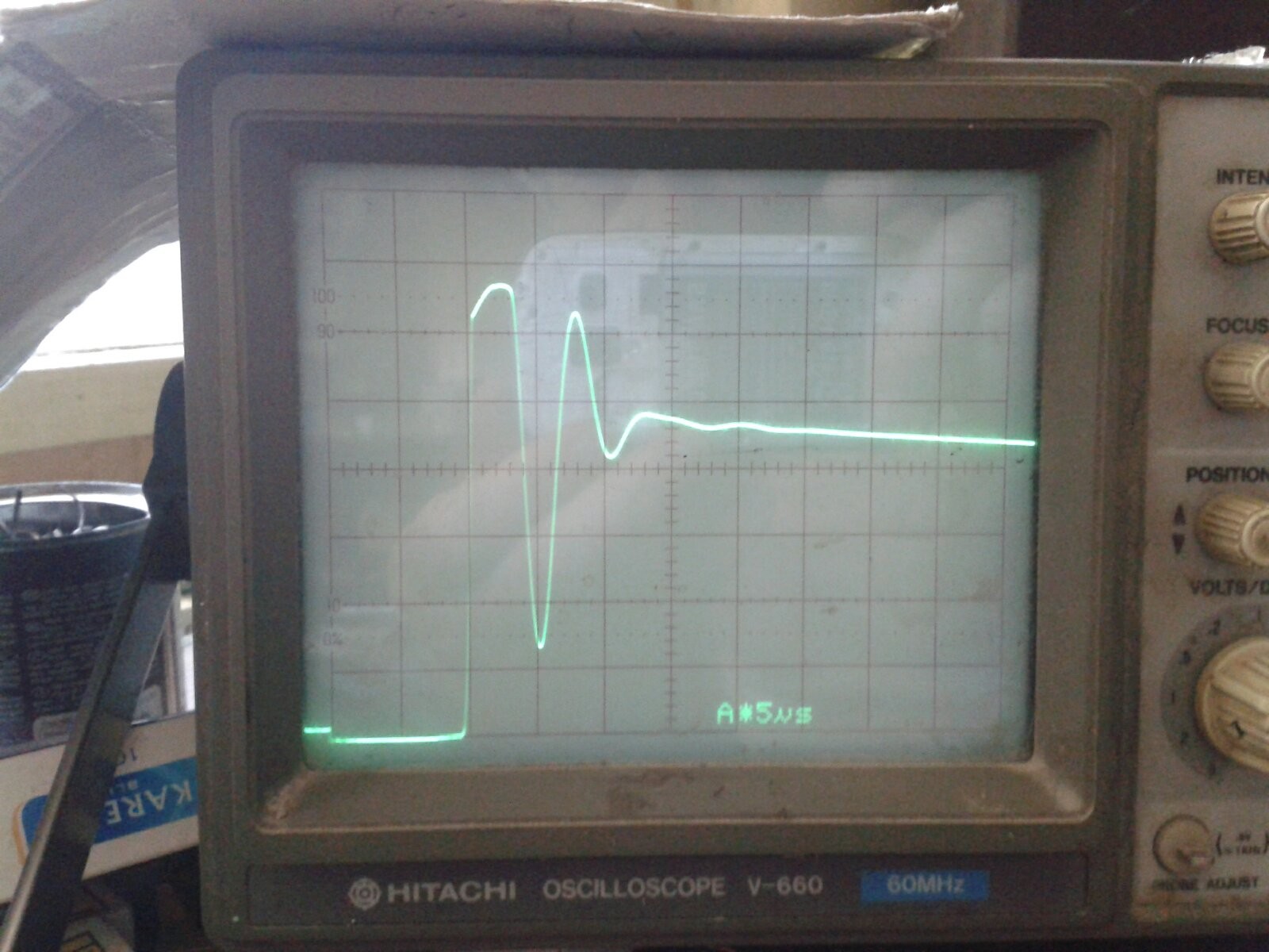

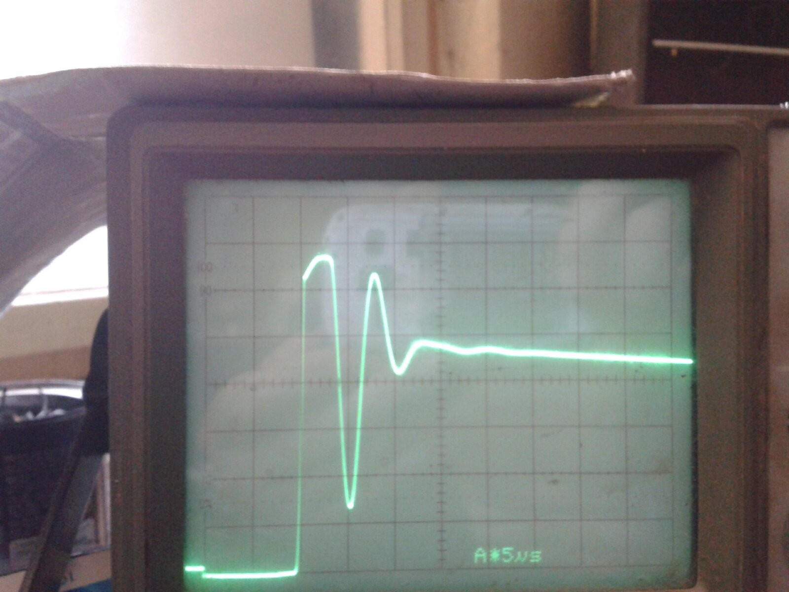

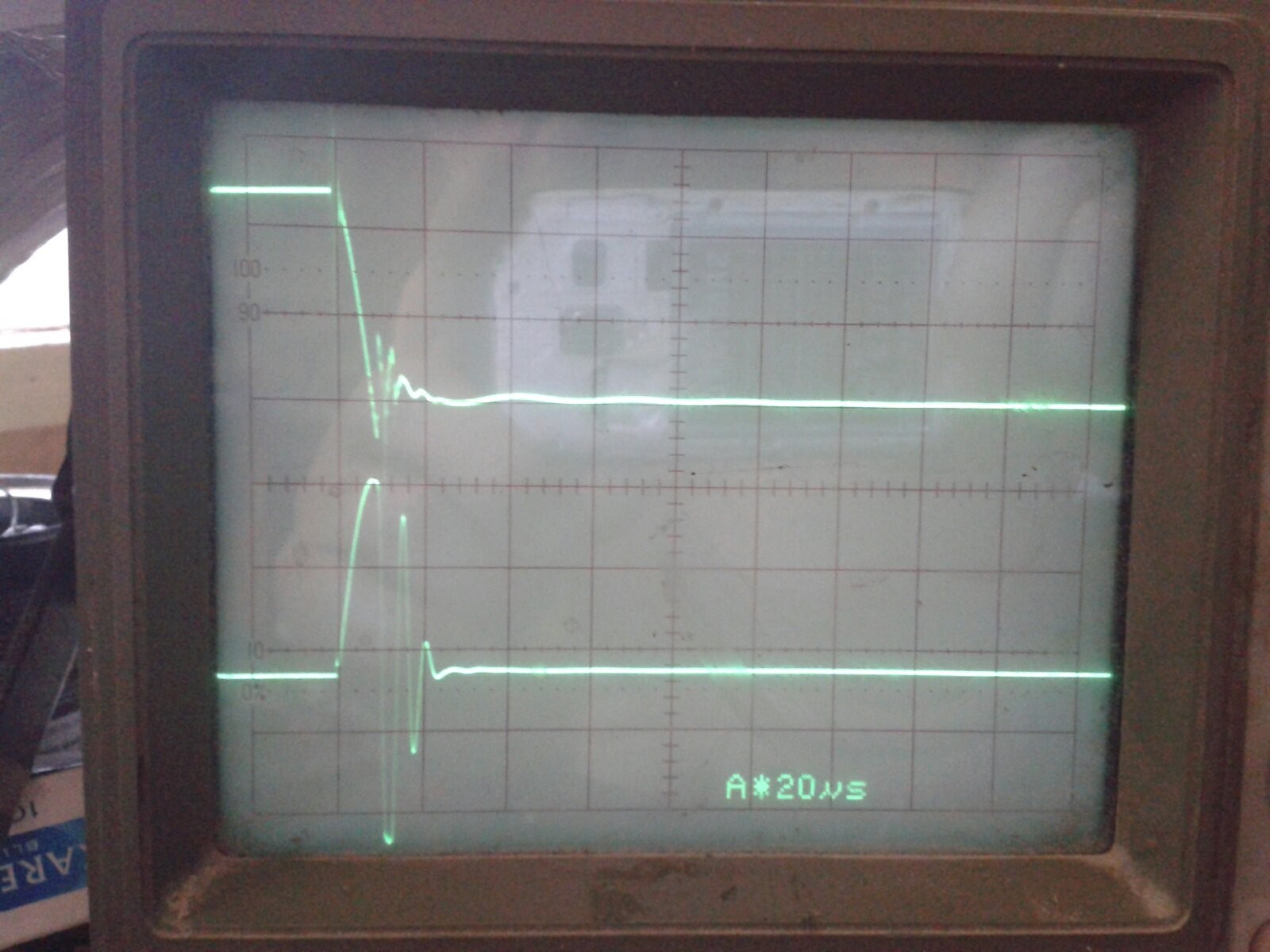

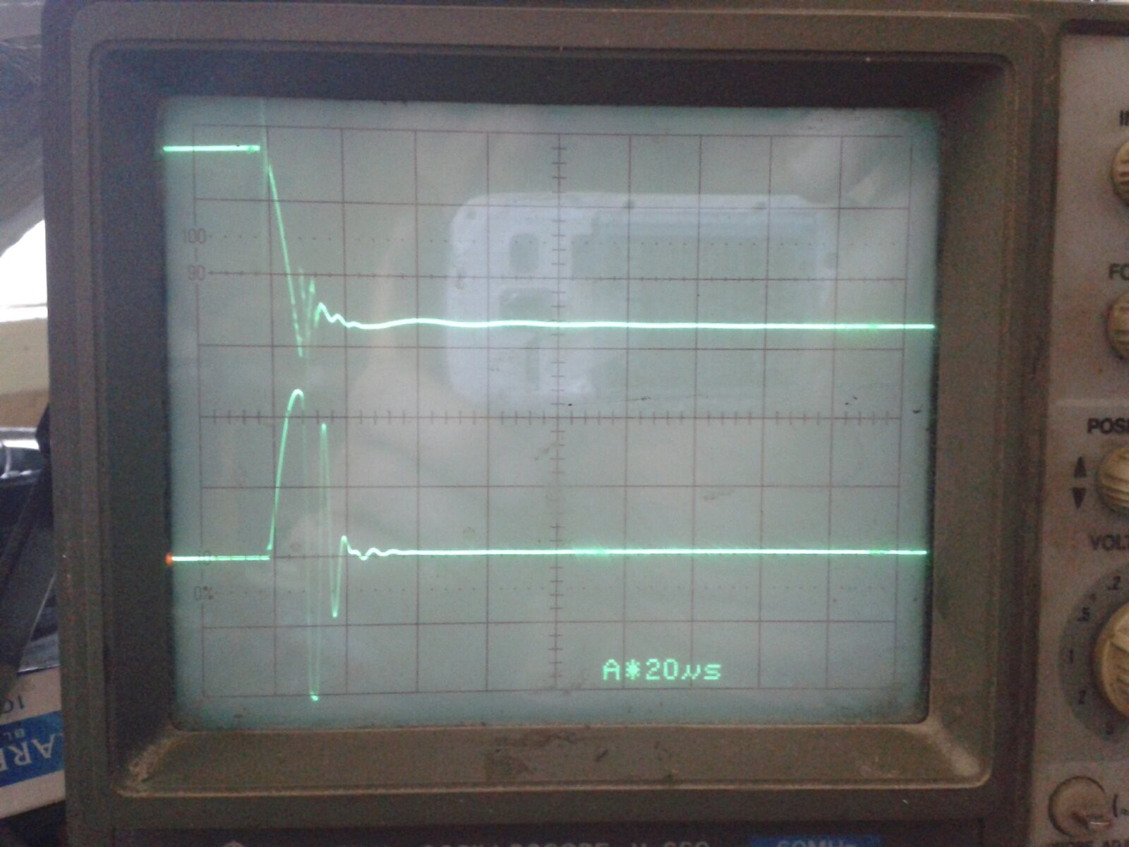

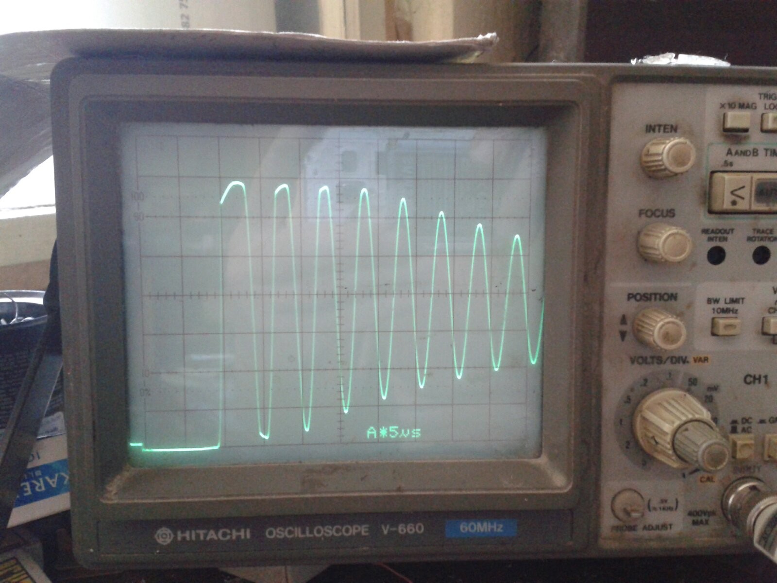

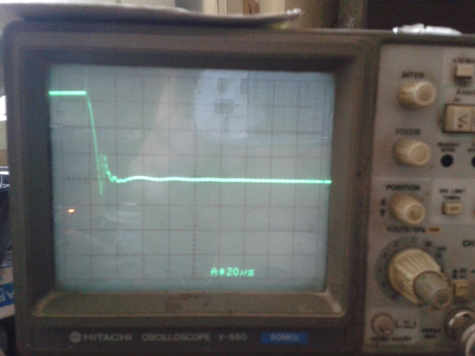

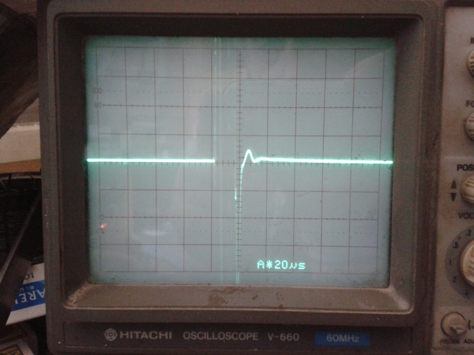

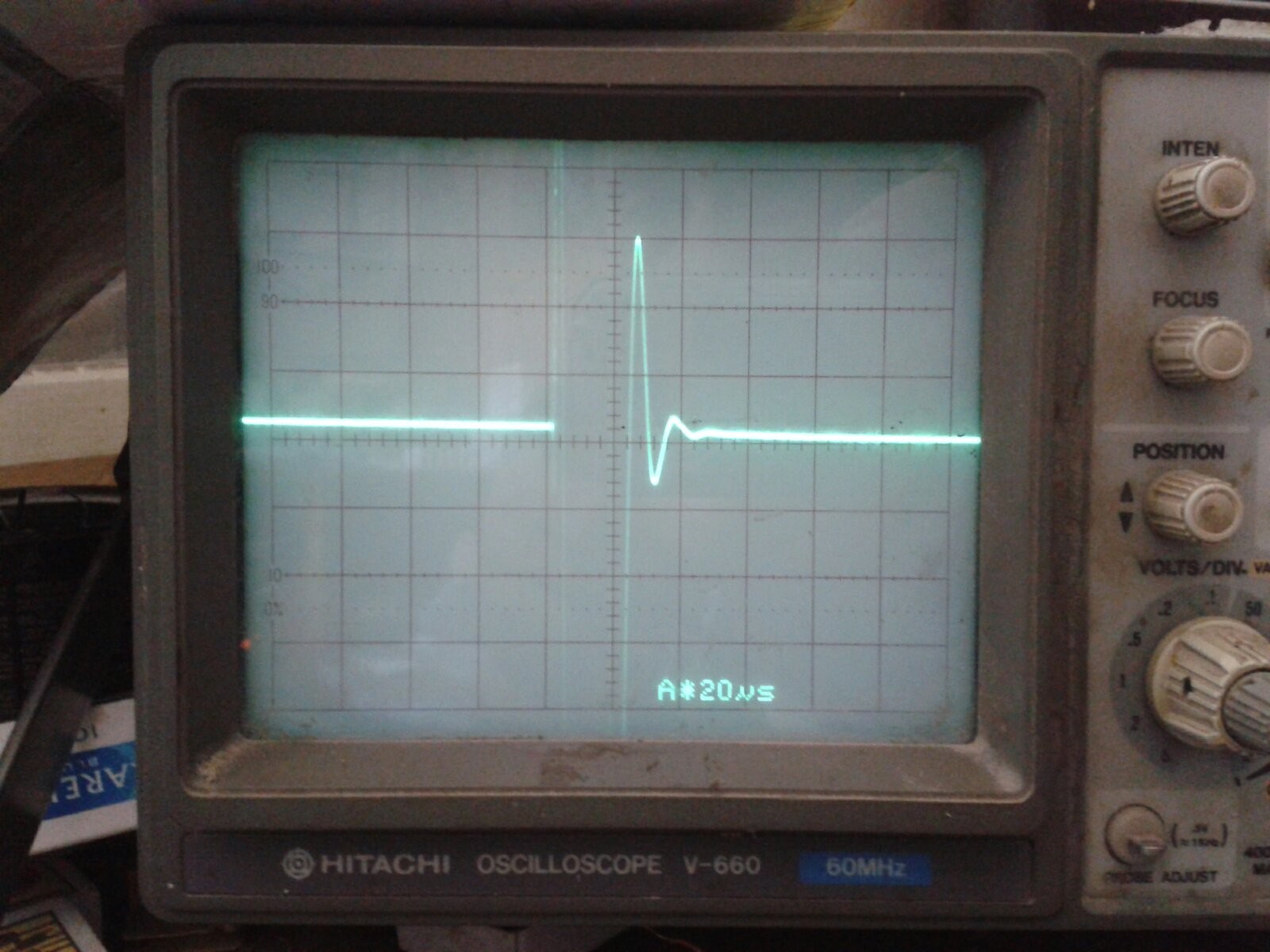

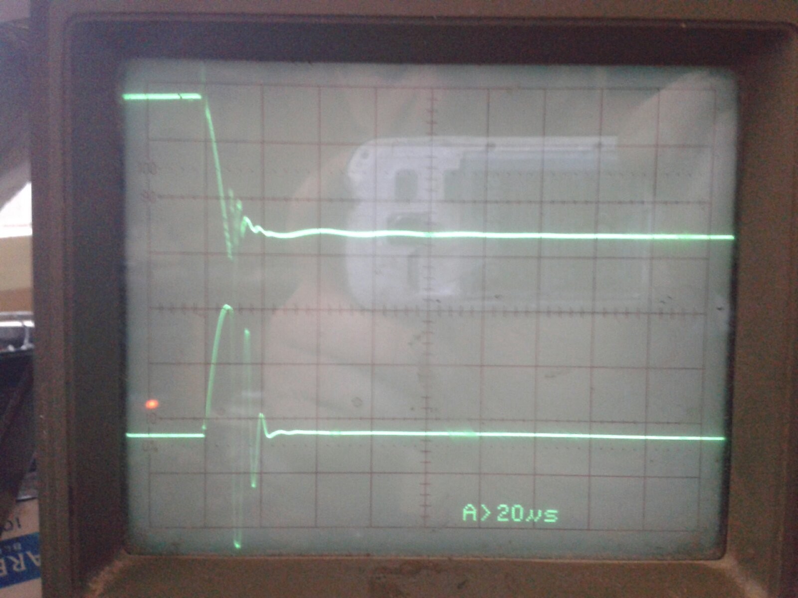

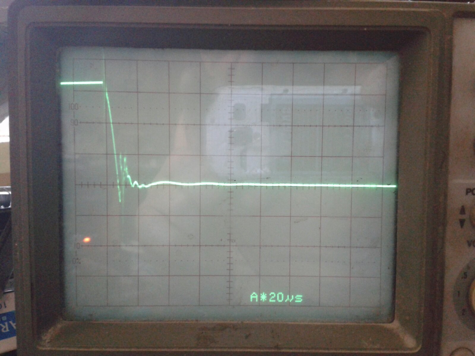

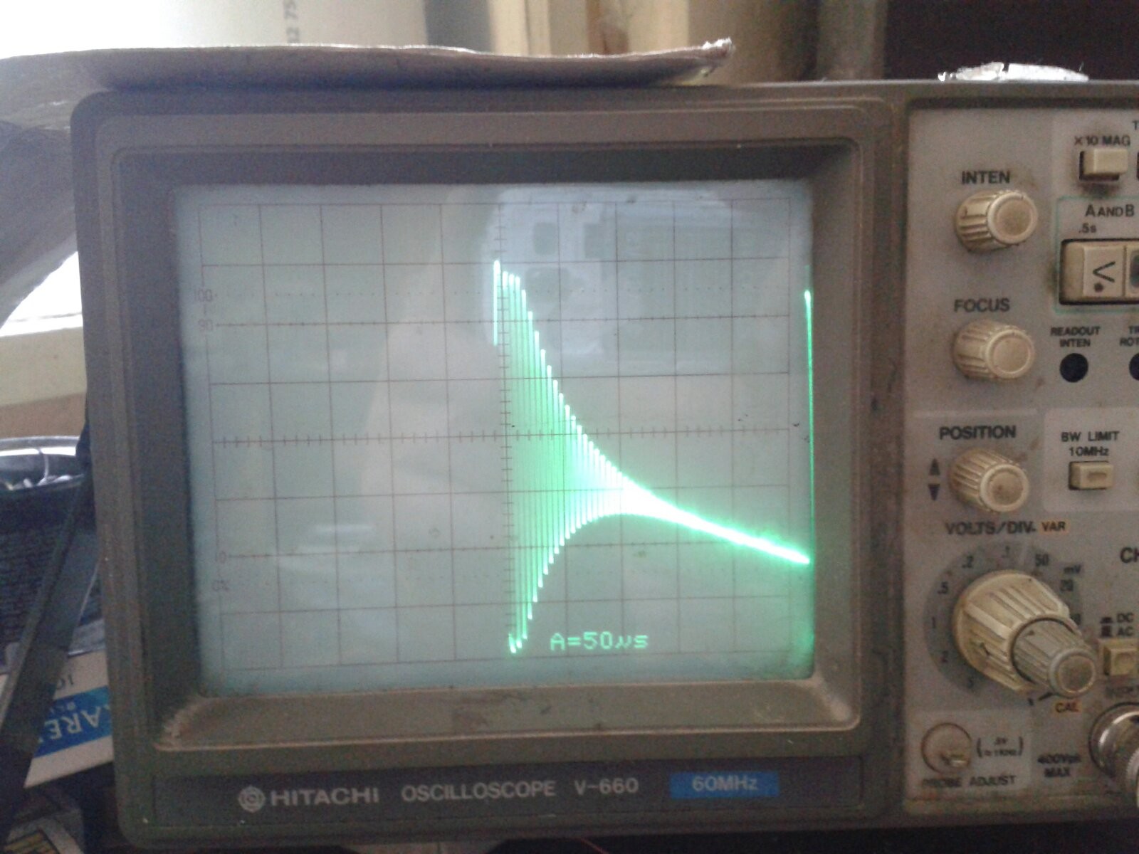

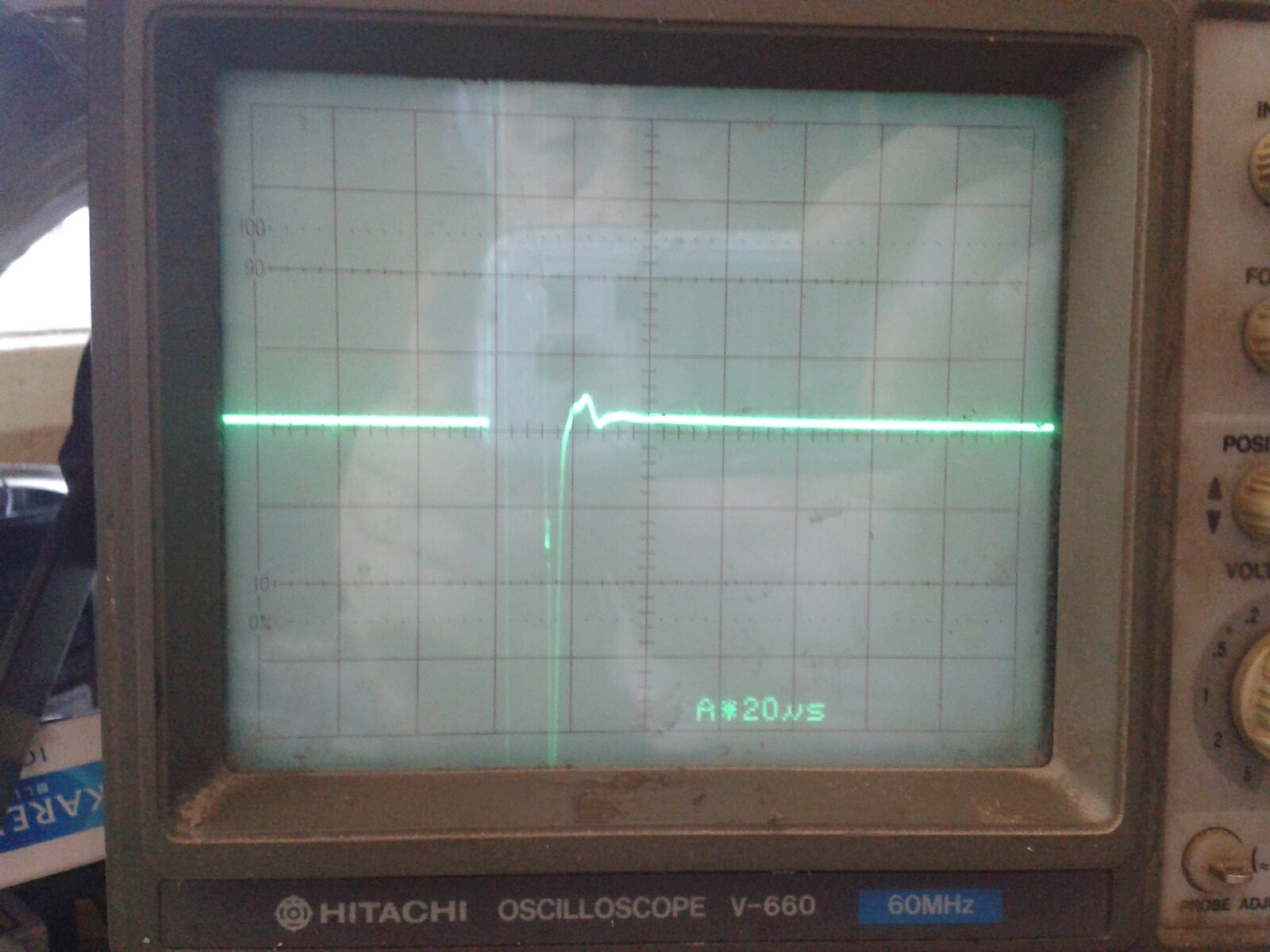

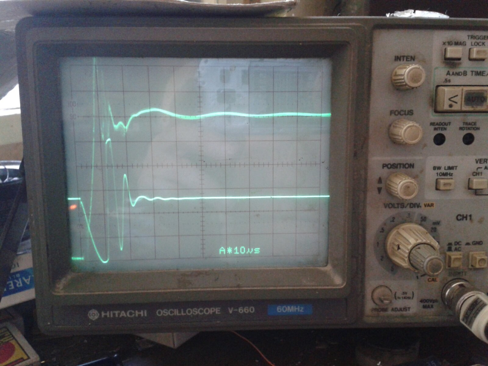

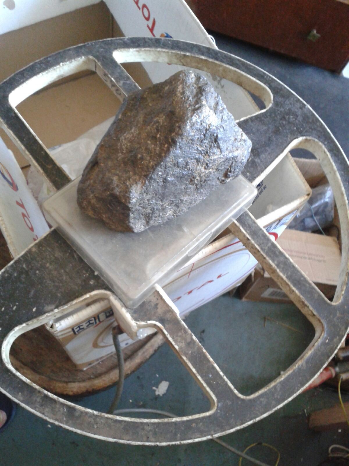

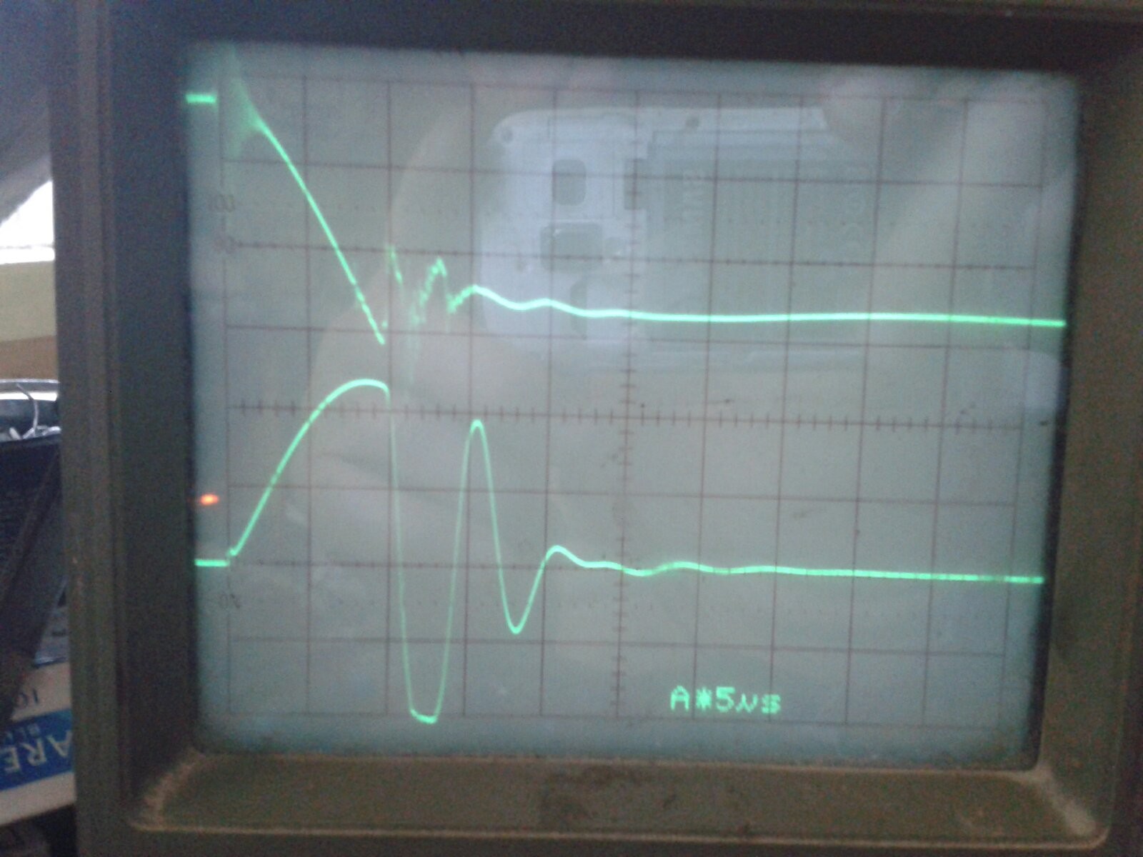

Probe type DD - transmitting coil -1.6 millihenry, its resistance is 4.5 ohms, its own resonant frequency (measured with the cable, of course) = 200 kilohertz - the calculated total capacitance is 380 picofarads. Receiving coil - 5.4 millihenry, resistance - about 24 ohms, its own resonant frequency -100 kilohertz, the calculated capacitance is 470 picofarads. The transmitting coil is included in the H - bridge with 4 pieces of 6N60. Bipolar PI, about 200 microseconds current flows through the coil. About 12 microseconds after the current through the coil has died down (the oscilloscope probe is connected to both ends of a 0.1 ohm resistor connected in series to TX coil ) very weak decaying sinusoidal oscillations with a period of about 28-30 microseconds are observed (which is very strange!!!). Without a damping resistor, this transmitting coil has a terrifying "ringing" with a period of about 6 microseconds (the H bridge adds capacitance ). I changed and tried everything, I thought, but I could not understand why the period of these oscillations is like that?!?
