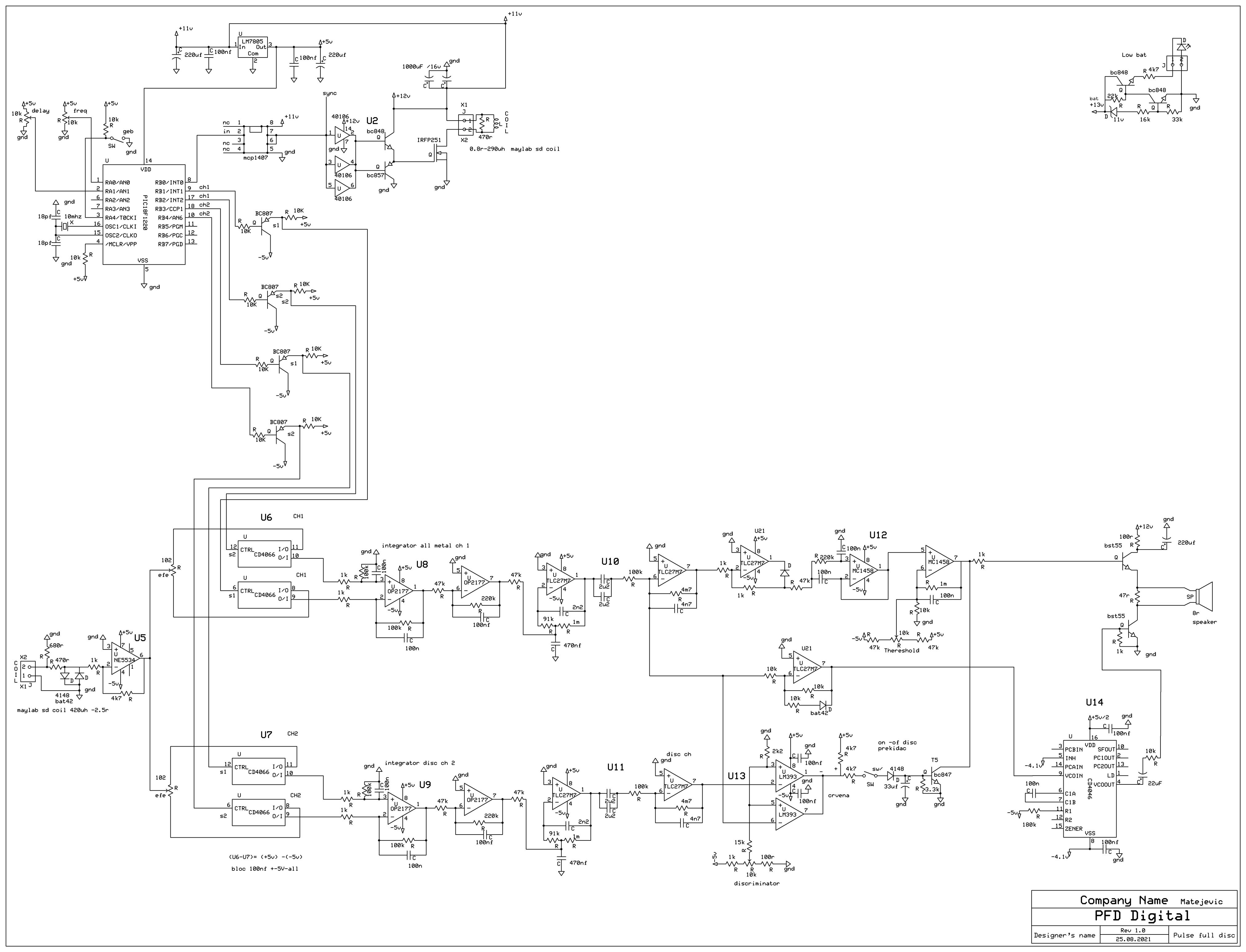

              Yes I used the scheme with Geotech from Zed pcb is modified as well as the timing circuit I use a filter from gpx I made mods for both channels for light soil like most places in Europe it can work in the country where there is strong mineralization but also where there is soil with little mineralization adjusting 4 potentiometers also since I tested the 50cm coil in CH 1 in Serbia in places where the soil is without mineralization almost or not at all it does not feel the ground as well as small coins or small waste I added a switch to turn off the balance of the ground actually with two added potentiometers it is possible to turn off the balance of the ground or adjust it where there is little mineralization in the ground so that the additional Potentiometers serve that it is possible that the balance does not close the signal from the target... This also allows a stable threshold because the influence of the balance from the third channel introduces noise into the operation of the device.
                Is it something similar? You downloaded this modified SD2000 circuit for this detector, which was designed in Bulgaria, and later the project was sold.I saw them selling it on an Italian site. Click image for larger version

                  Hi Orbit and algan,
                  Do not use this scheme! It has many fatal errors.
                    I have not downloaded anything in the picture j my scheme but the sd 2000 we are talking about here has nothing to do with this scheme! Also, the scheme you posted here has errors, secondly, if you compare the filter, I think it's the same as the sd 2000 Zed..

                        is there are MCU code file ?
                          There is no damaged hard drive and Matejevic is left without hex files.

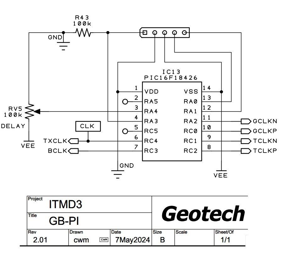

                            Replace the chip with Carl's, not the bipolar one, but the other version, run the frequency from the chip and then make this circuit, the samples should match, it's not that difficult
                              OK ..
                              I understand and thank you.
