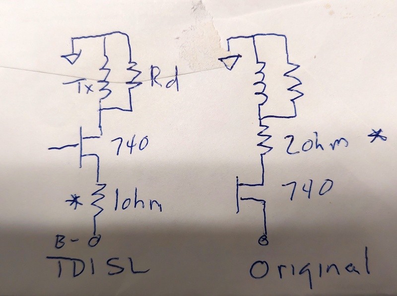

                    I'm using a 4-layer PCB and not a differential input. I'm using a single-ended preamplifier and a mono coil from the GPX series. Right now, I'm comparing the results of my self-built detector with the Whites TDI SL. The results are very similar; the only thing I've noticed is that the MOSFET in my detector gets hotter than the one in the TDI, and I don't know why. I'm using an ESP32 powered at 3.3V, and the TDI uses a PIC microcontroller powered at 5V. The gate driver for my MOSFET is the same as the one in the TDI SL. I'm still investigating this issue.​
                      HI Eduardo are you using a 2 ohm resistor like the TDI in series with the Tx coil?
                        Hi Altra.
                        I also tried using the original Dual Field coil from the TDI. The problem remains the same. The MOSFET still gets slightly less hot than with the GPX coil, but it still heats up.​
                          TDI's used a series resistor to limit the the Tx current to coil. Like this

                            Hi Altra.
                            I'm using the same configuration as the TDI SL. I'm not using a resistor in series with the coil, as in the original TDI.
                            The truth is, I don't understand why the MOSFET in my detector gets hotter than the MOSFET in the TDI SL, even though I'm using the same gate driver, the same frequency (2.8kHz +/-), and the same pulse width (100µs). Perhaps Carl could help me.​
                              Does your MOSFET have a heat sink?
