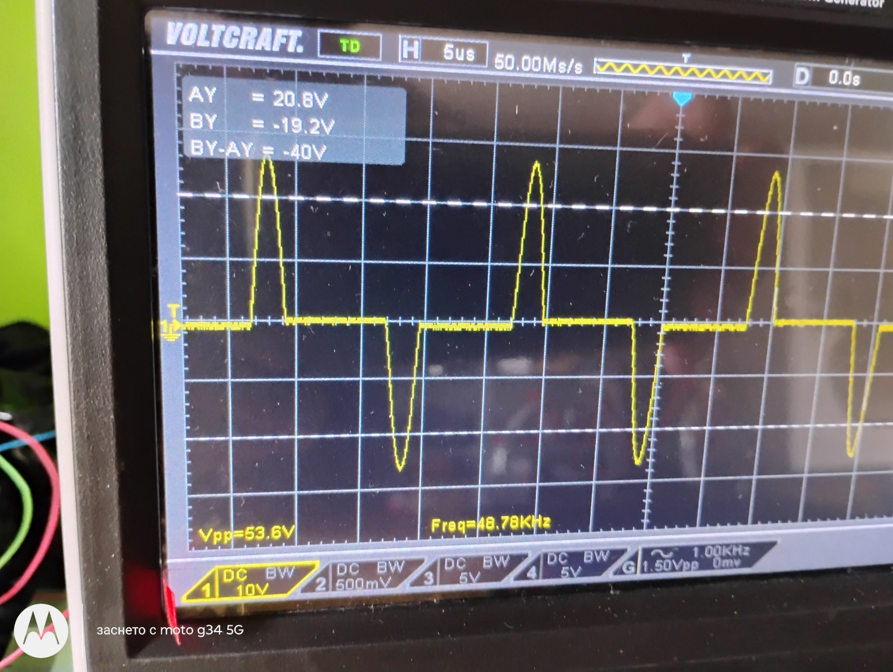

    Some timings of Hybrid Bipolar Detector:
    We did not see bipolar impulses.

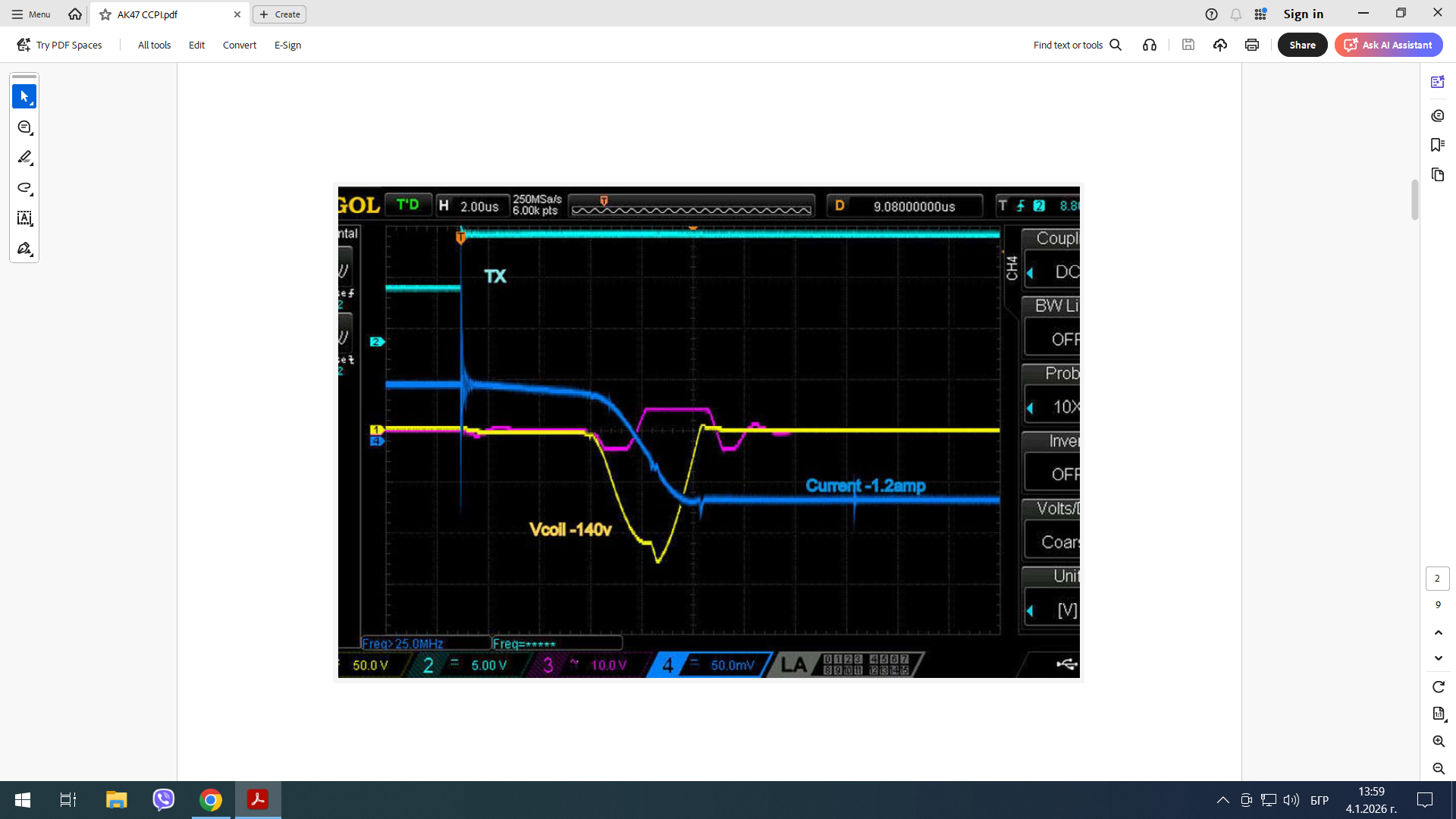

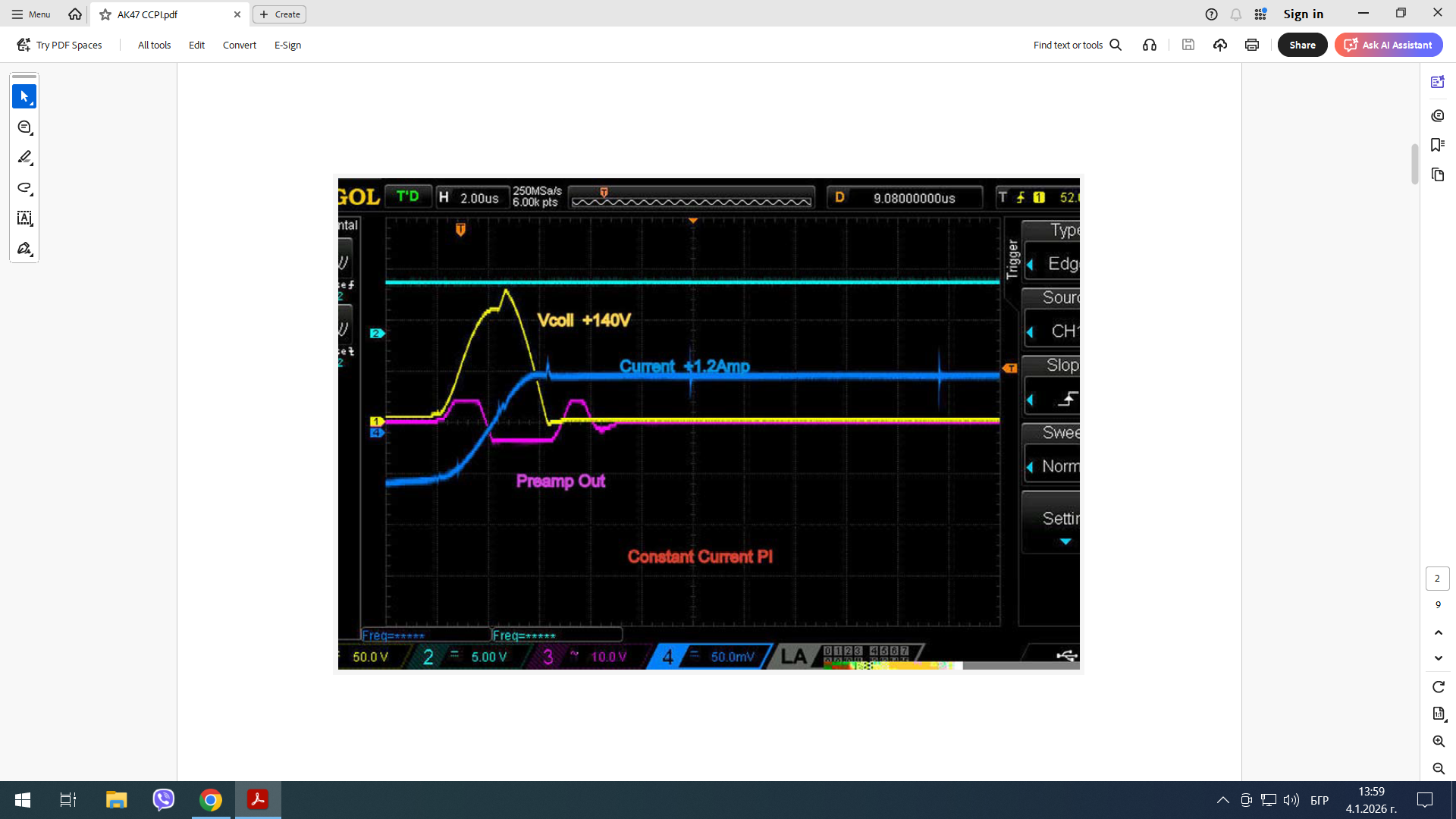

      That's a square wave PI, not half-sine. Completely different approach.
      It's a half sine.
      Click image for larger version  Name:	Екранна снимка (20).png Views:	0 Size:	552.9 KB ID:	444314
      Click image for larger version  Name:	Екранна снимка (21).png Views:	0 Size:	532.0 KB ID:	444315
        Originally posted by pechkata View Post
        It's a half sine.
        There is a difference. The half-sine in the CCPI represents voltage. The half-sine in a THS pi represents current. As Carl stated it is a whole different concept.

                  The project in this thread has a bipolar truncated half-sine current like this:
                  The Deemon project has half-sine flyback voltages but a square-wave current. Completely different; if you want to discuss the square-wave approach please use another thread.
                  The benefits of bipolar pulsing have been discussed in numerous previous threads; see post #27 for 2 of these reasons.
