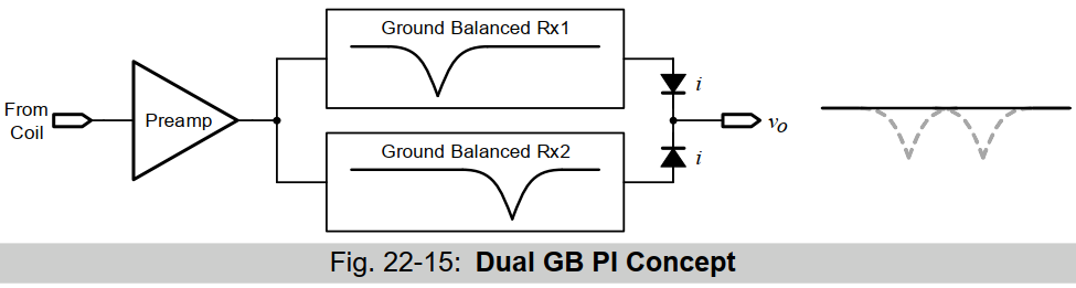

                The Impulse AQ doesn't have a target hole because it does not do a complete ground balance. There are 2 channels but they overlap without a null.
                Otherwise, yes, you can eliminate the target hole with another pair of GB'd channels where the GB time constant is different from the first GB pair. Combine the two, and you end up with 2 non-overlapping target holes:
                Click image for larger version  Name:	image.png Views:	0 Size:	34.3 KB ID:	444841
                Edit: In a single GB receiver, as you push the target hole farther out it gets noisier, so there is a limit to how far you can go.
                  Look, I would never have thought of combining an incomplete ground balance. Thanks, Karl

                        Thanks to Karl for the idea of ​​incomplete/complementary ground balance. In reality, all ground balance probes increase the signal in the presence of ground or a target by values ​​depending on their position and the additional effect of the object. After more careful consideration, I came to the idea of ​​changing the working procedure of the old unipolar pulse-induction detector. Until now I have two independent GB channels, which I summed after normalizing the signal ( to not use logical OR summation).
                        Instead, I think to use only one GB channel, which will operate with all signals - targeted and ground-balanced (more precisely, with the sum of all GB samples). But, in order not to lose sensitivity, especially of long-constant targets, after making GB balance (according to the classic GB procedure), I will "limit" the values ​​obtained from the GB samples as maximum. So that during normal working operation with the GB turned on, the values ​​(which are actually subtracts from the useful target signals) do not increase above this level under any conditions (up to this level they must exist, because they are obtained from the balance of real earth/hot stone, etc.) with no limit of target samples. Thus, I think, I will solve the problem with the targets that are after the time position of the ground balance samples.
                        On the other hand, this will greatly simplify the process of setting the ground balance (I will only have to work with one channel and several target and ground balance samples).
                        Am I wrong somewhere?​
                        EDIT: This should improve the sensitivity of the detector overall
