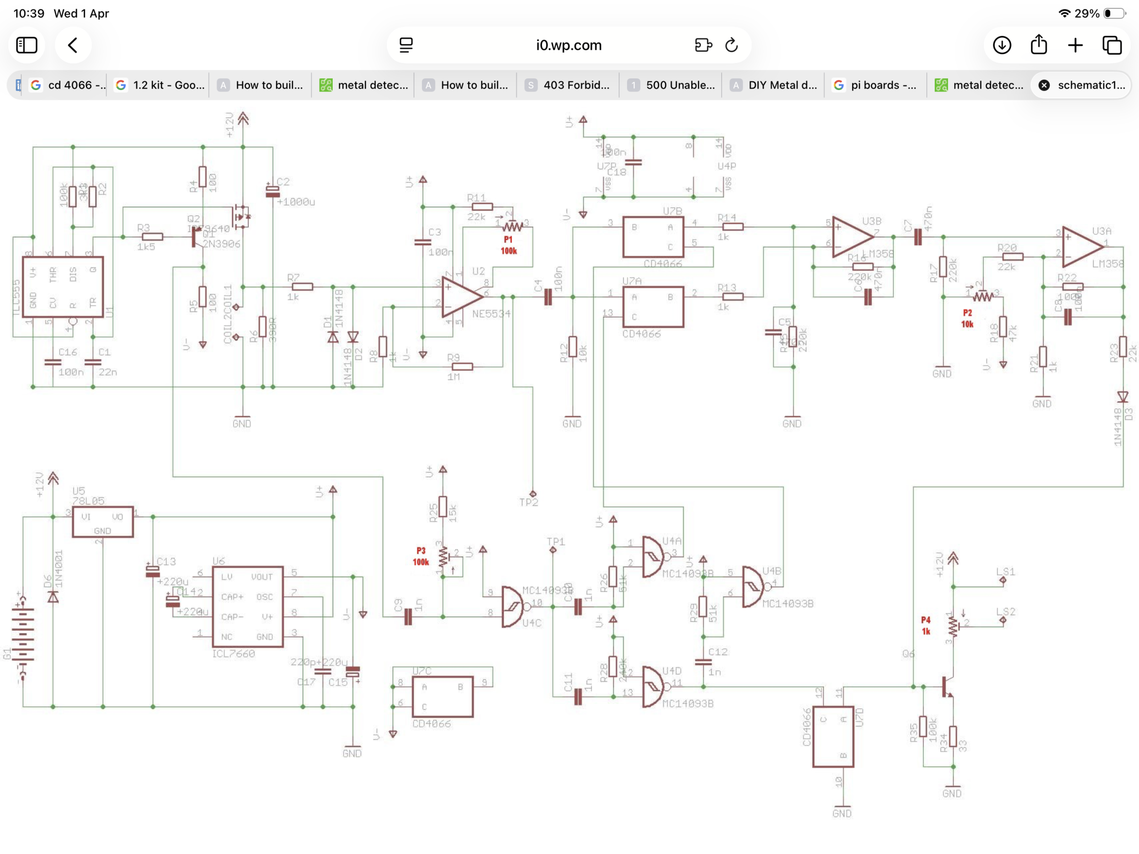

    I’ve just built a surf Pi detector using the mosfet irf 9640 for pulsing the coil design/version.
    its working ok but limited range about 6” at best for a pound coin in the air.
    is it supposed to make a clicking sound when no metal then a tone when metal, or be completely silent when no metal?
    could anyone offer any advice on setting the the surf pi please and any voltage settings.
    (for example trimmed null offset on pre amp output so pin 6 is around 50 mV)

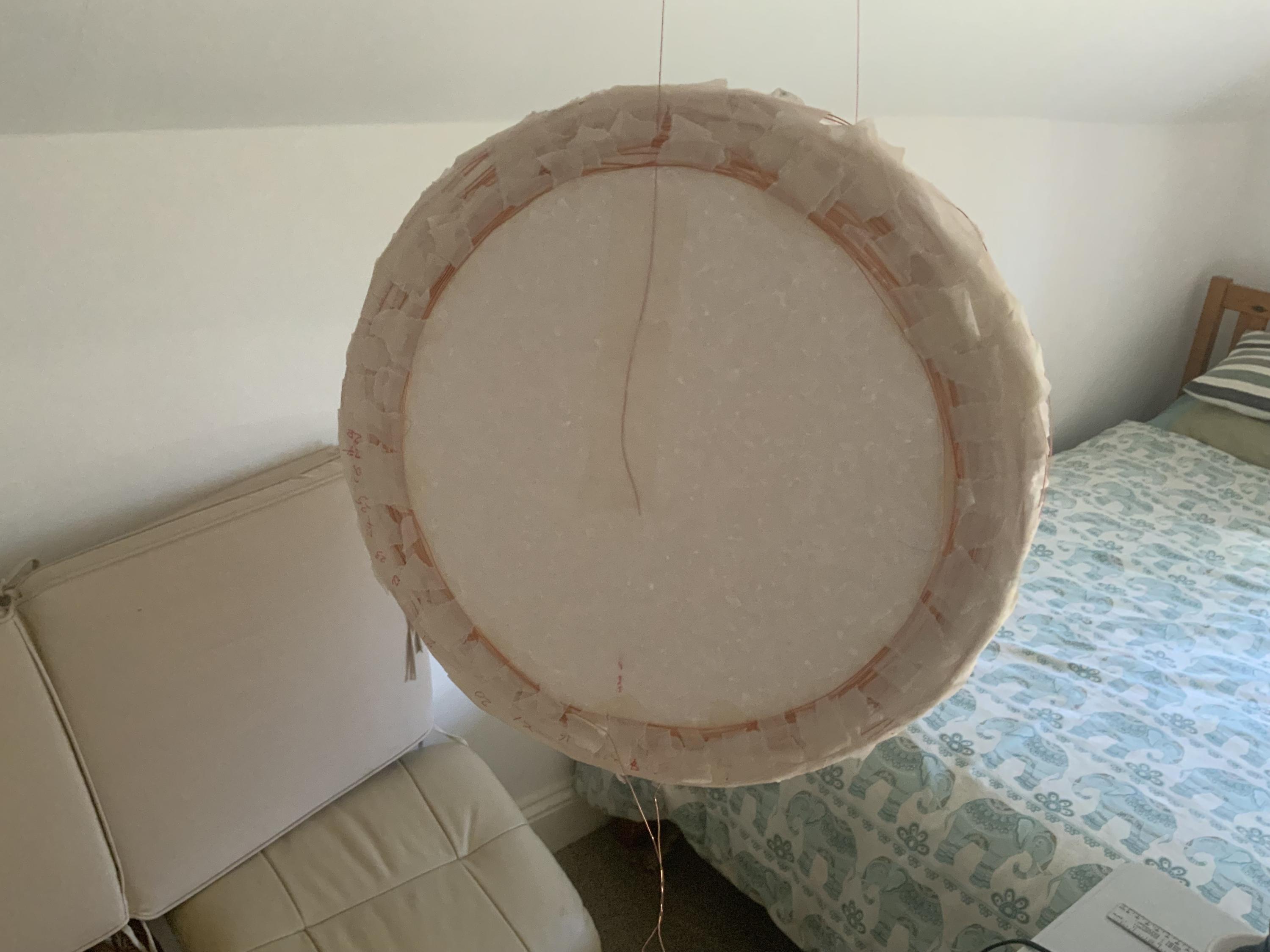

    maybe my coil is wrong, 28 turns of 28awg 8” diameter.
    Thanks in advance
    Steve
    P2 is the threshold pot, increase until you hear a faint hum.

      Coil specs don't mean much without inductance, you didn't specify what it is?
      The IRF9640 is an excellent choice, given the limited selection of P-channel MOSFETs.
        Based on your specs, the inductance of your coil from 28 turns of 28 AWG 8" diameter wire is approx 0.29mH.
        This is a "super fast" coil for that type of detector.
        Wind the second coil with an inductance of about 0.4mH.
        Maybe even a bit higher than that.

          cant measure inductance no meter.

                On one of the many schematics for the Surfmaster, I found data of 0.35mH for the coil.
                Maybe it's the original data, I'm not sure.
                With your wire and the diameter of the winding body; math says you should wind 30-31 windings.
                So you are very close!
                  "Original Surfmaster PI loop:
                  20t, #24, 9" Dia.
                  #24 American Wire Gauge = 0.5 mm metric
                  Mrand"
                  Math says it is 0.35mH too!
