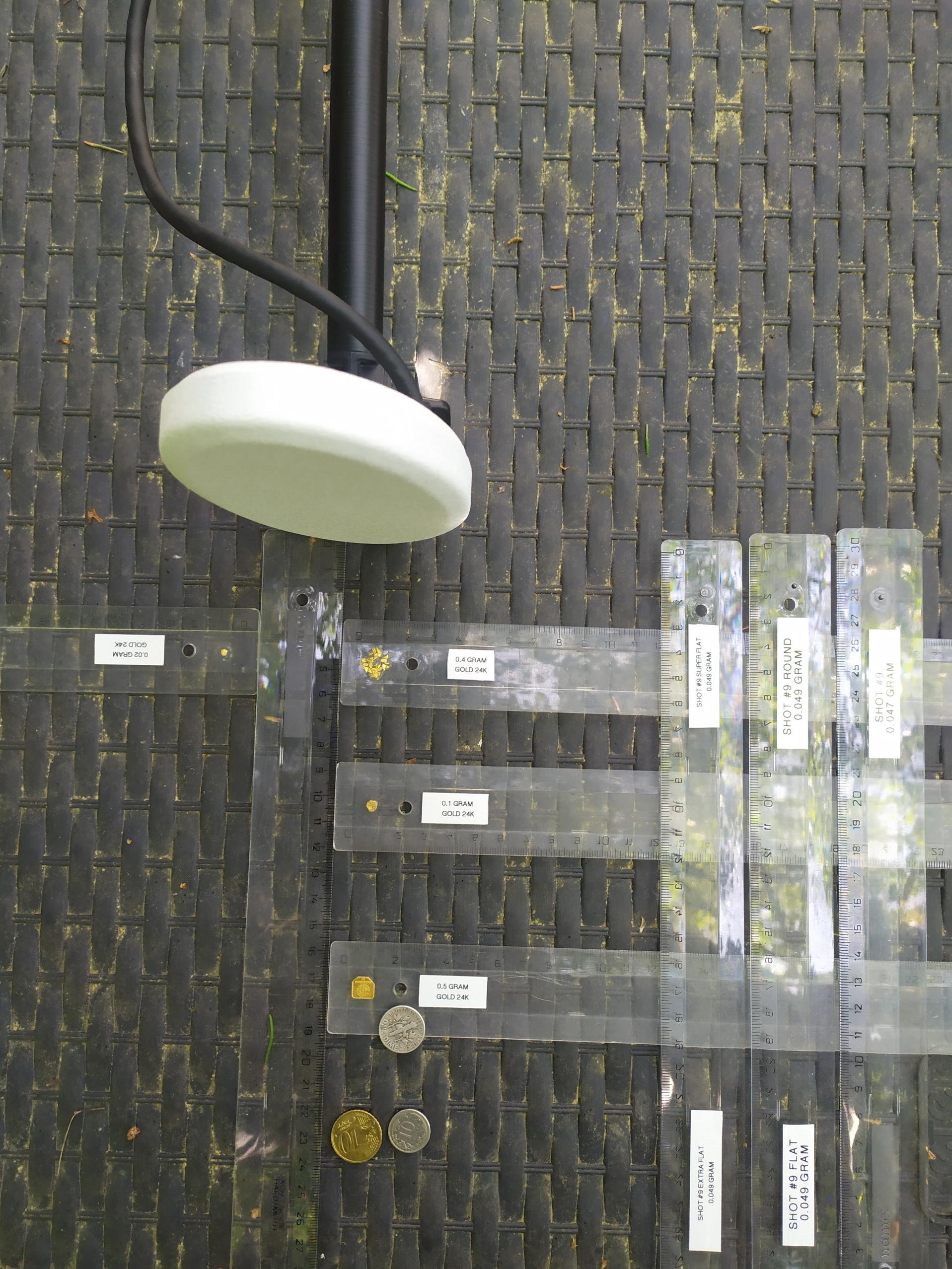

                In my opinion.... a target of size 1x1x0.2 mm made of medium and high conductive material... is too small a target for a PI detector...and moreover if such a target is made of lead - low conductor... then the PI detector will not detect it at all....
                My testing of ATX with a 3x7" coil from Infinium..../ATX is one of the really sensitive PI detectors / shows where the detection limits are for very small targets..
                Such small targets can be detected to a certain extent by a VLF detector with a frequency above 40khz and small coil, best from 70khz and more khz with a small coil... ​
                airtest. ATX with a small coil 3x7" DD Infinium ..test detector without GB..

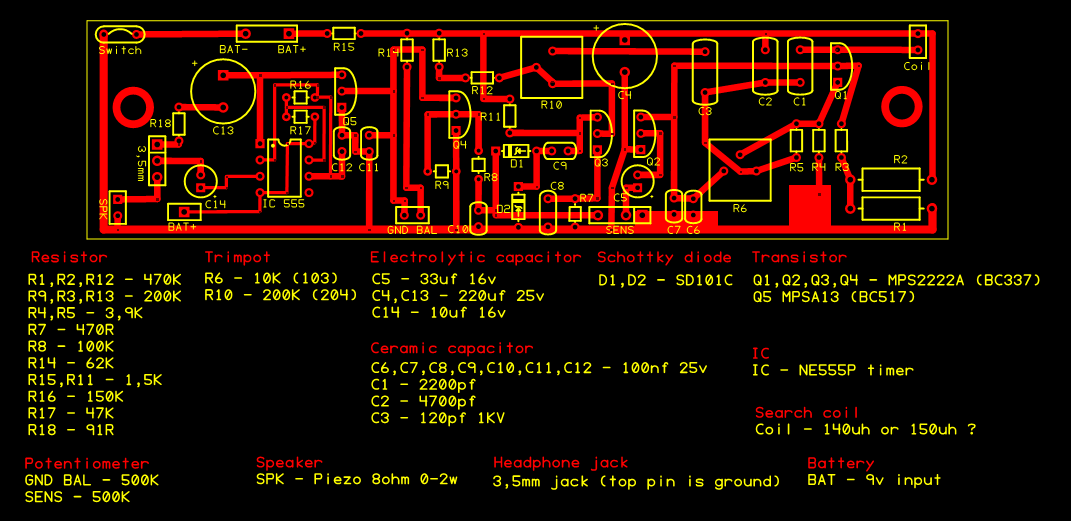

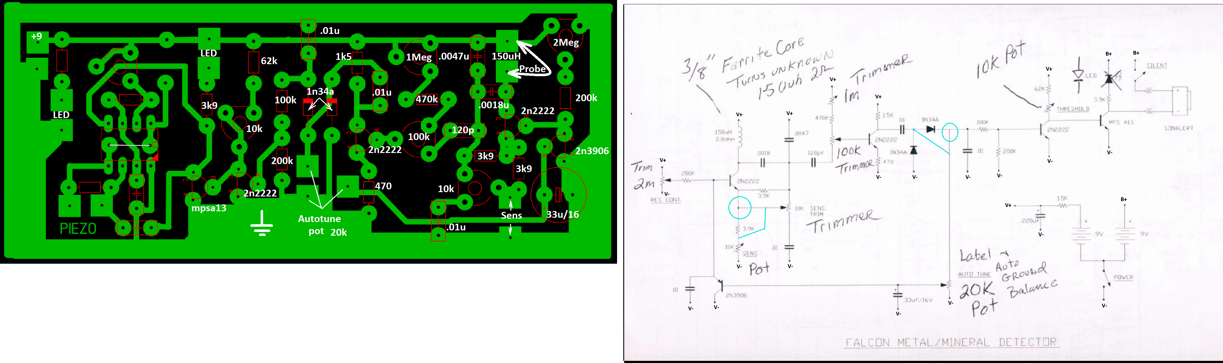

                  Hi Nogtail,
                  Try to find the scheme of Falcon MD8 or MD20 pin-pointers on geotech1.com site. They are VLF type and the working frequency of these pin-pointers is 300KHz. These pin-pointers are advertised as capable to find very little metal particles ( almost invisible). It is good that your task not need EFE and GB features.
                    Hi Nogtail,
                    Falkon MD20 is "Energy theft" type, not VLF type. Nevertheless, try to use this scheme for your purpose.
