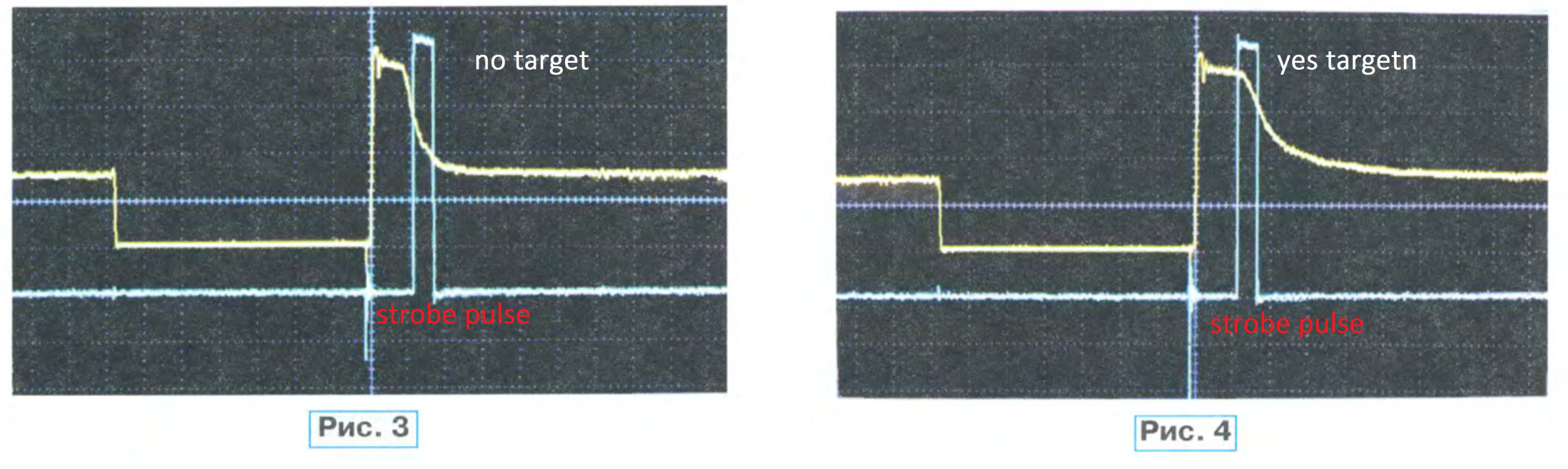

            Click image for larger version  Name:	yes no target.png Views:	0 Size:	1.43 MB ID:	449709 It is almost impossible to discriminate coloured/black targets with single Tx pulse excitation. Strobe time shift delay is of little help. Answer is splitting the positive or multiple spectra Tx pulse excitation with advanced additive sampling, averaging and complex time domain filtering. The logic is simple - one man know a lot but 1 0000 man coordinated and connected know 1000x times more than a single male.
            Suggest to analise and study coils echo-coefficients calculator or FIR echos of Tracker-PI 2 as a starting base and improve the code for you needs. Source could be easy compiled to any Atmel microcontroller with IAR Embedded Workbench for AVR V7.30.4.​

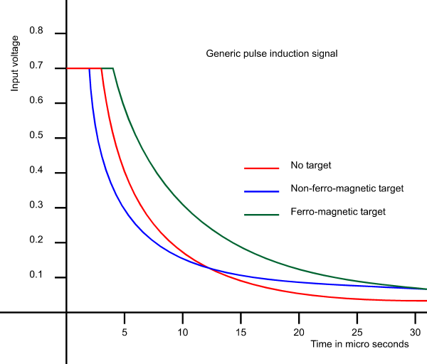

              this is a very popular picture of discrimination, but never sowed it in real life = on oscilloscope
                Hi pito,
                My observations with DD coil and very precise IB, shows that have something right in this picture. When I set the delay to 12us, the detector totally not react to ferrite bar. At 10us delay the detector starts to react on very close ferrite and for delay of 5us the detector haves very strong reaction to ferrite bar. Also, at under 12us delay, the polarity of the signal for non-ferrite targets is opposite. In short - this popular picture is true! These measurements was made for short sampling pulses (4us) and after amplifying (x1000) of the signal after the integrator. It is not possible to observe directly the signal on the RX coil - the level of the signal is in microvolt range.

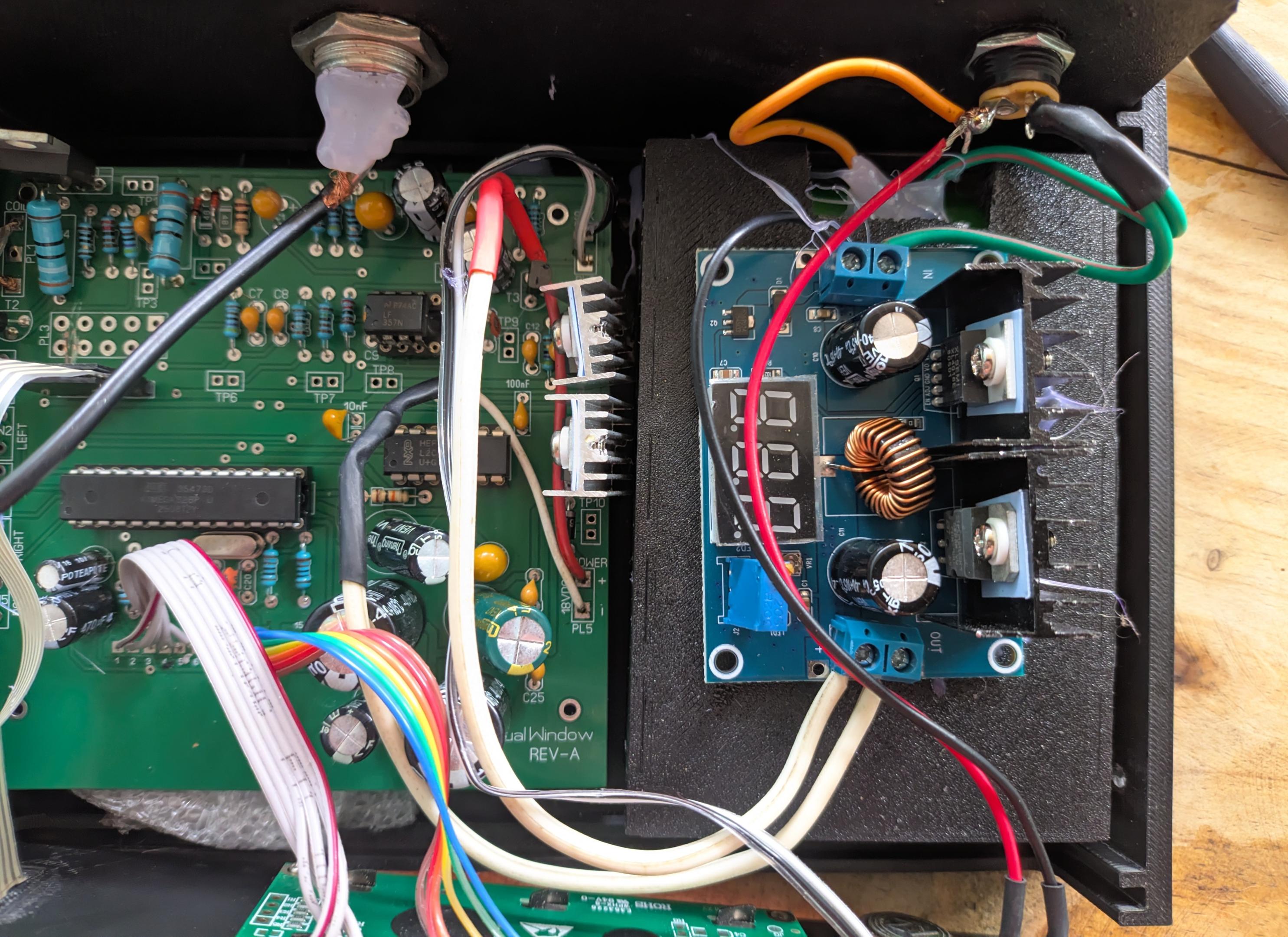

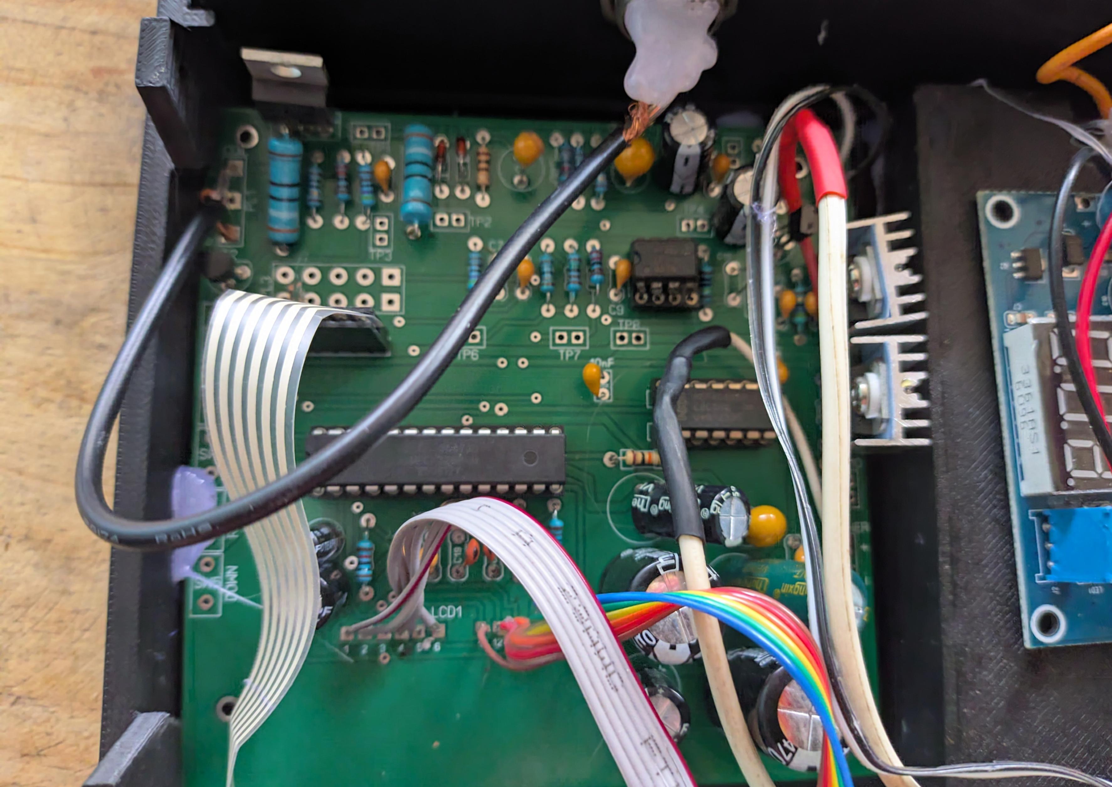

                          I have bad news. After using it for a while, it seems the LF357 was indeed damaged when the 7805 burned out. Now the debugging values ​​are far below the specified values, and therefore the discrimination isn't working properly. For the LF357 to function correctly, the values ​​need to be accurate, meaning it has to be genuine. So, for now, until I can get the right replacements, I'm waiting.
                          I'm thinking of replacing them with something easier to find, but it's complicated; I need to do more testing.​
                            https://www.google.com/search?q=LF35...hrome&ie=UTF-8
                            I will use modern 5V MCP6022
                              By the way, this is the motherboard I'm using. You can see it has small changes, but it's there.
