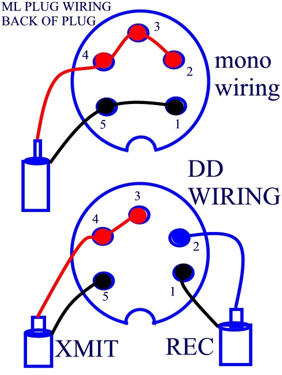

    Hello everyone:I am looking for schematic of TDI metal detector.
    does anyone have schematic and DD coil information of white's TDI metal detector?
      Hi kt315,Thank you very much for reply,does a information about making DD search coils?and does a schematic is correct ?do you have pcb file?schematic is very close to gs4.4 sample .
      thanks.

            Thanks,dear Carl,do you have schematic and DD coil instruction?do you doing reverse engineering this detector?
              The schematic kt315 posted looks correct. For the DD coil I would use
              TX = 300uH 2Ω
              RX = 300uH 2Ω-10Ω
                TX = 300uH 2Ω
                RX = 300uH 2Ω-10Ω
