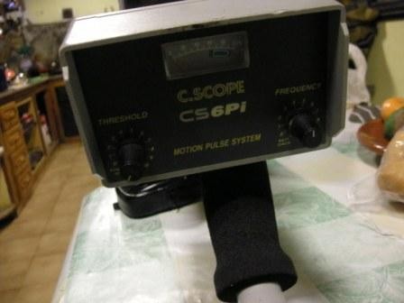

      Hello martinkayak2000,
      Could a better photo of the front view of the CS6PI detector be posted here—one better than the image below? While there are numerous photos of the CS6PI's internals available here, I have never seen a good, high-resolution photo of the control panel that clearly shows the controls and labeling. This is the best image of the control panel I could find online.​
      Thanks.
        The detector isn't mine. The photos are from Google.
