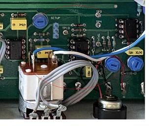

      I have some photo's uploaded....but I am unsure which op-amp to check. Thanks.
        You can check any of them. The only one I can read in your photos is the 5534. There should be 10v between pin 7 and 4. This will verify if the power supply is good.

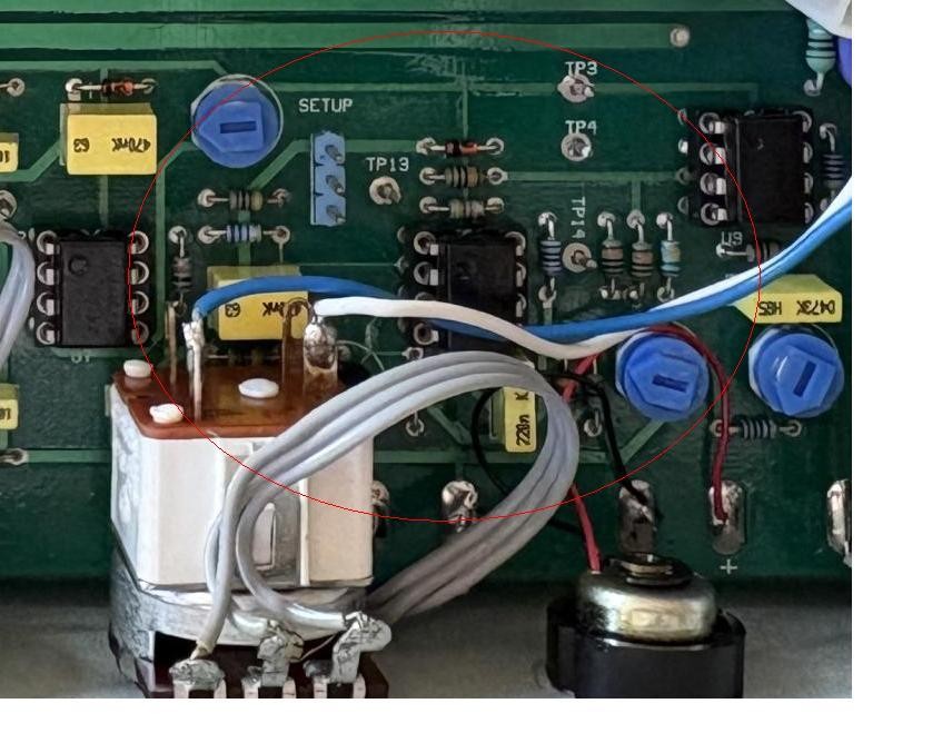

                That's good you have 9.75V on the NE5534. This means your power supply is okay. The problem is probably around U8 which is most likely a TL062? This is the threshold and SAT circuit. There is a J113 jfet transistor which clamps negative voltage swings and resets the threshold. If the reference voltage is out of whack it will mute the audio. The blue trimpot next to the word "setup" may be an adjustment for the SAT clamp? You could try adjusting this to see if it restores the audio. I would mark the the current setting with a marker before moving. If you don't have an oscilloscope or working knowledge it will be tough to repair. Good luck...
                  Thank you for the update......what you describe sounds very much like the problem. I don't have a working knowledge or necessary test equipment which is a shame for me. If you have the time, could you possibly highlight the parts in question on one of my photo's from earlier. I am going to replace the potentiometers as I feel they are out of spec....can I assume that no PCB calibration is needed by changing pots ?

                      I see where you mean from one of my PCB pictures.....thank you.

                          I wouldn't change the pots yet. When connected to the circuit they rarely read the correct values. As a last ditch effort try adjusting these trimpots . Make reference marks with a felt pen on the sides of the pots. This will let you return the trimmer to the original setting. Turn your threshold pot to full then adjust each trimmer to see if you can get audio.

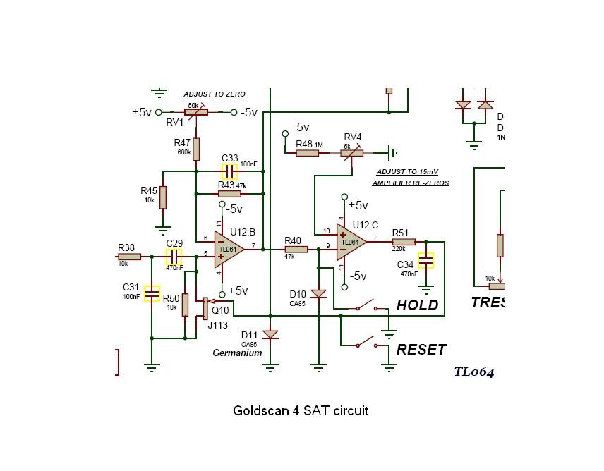

                          Click image for larger version  Name:	Deepstar SAT circuit.jpg Views:	0 Size:	114.7 KB ID:	451184
                          It should be similar to the GS4 SAT
Name:	Goldscan 4 SAT.jpg

                              The Deepstar is a mix of MiniPulse, Goldscan 4 and C-Scope 6PI.
