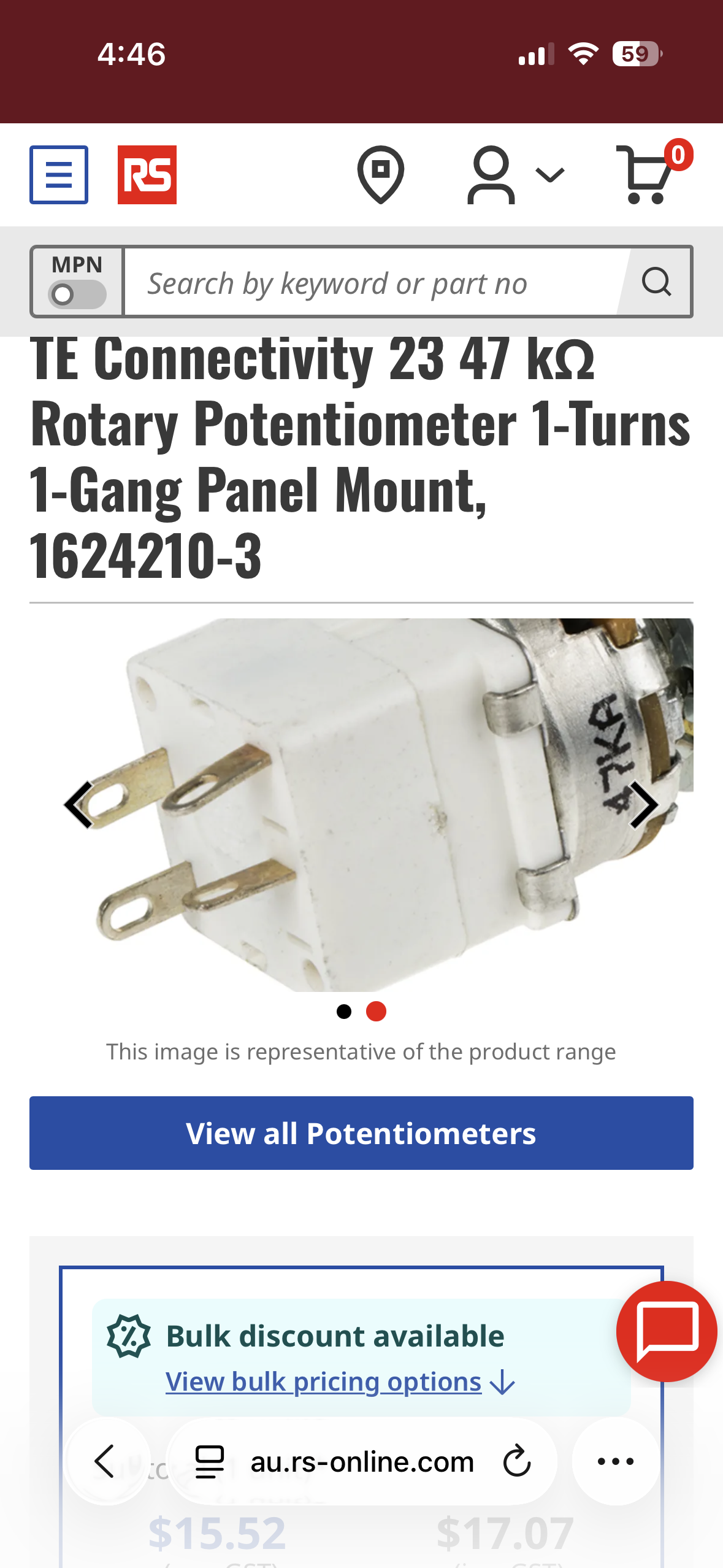

                                Did I cold solder the potentiometer eyelet ?
                                I took another look at the new On/Off Threshold potentiometer that I installed and thought to myself one of those power connections on the back of the potentiometer looked like I could do better. I checked the continuity and it was okay but I decided to reflow the solder and "fill" the eyelet. I also did this on the wiper connection seeing as I had the iron out and it was only seconds of work.
                                Anyhow.....the detector hadn't been switched on since yesterday and amazingly it fired up immediately with a good strong audio. I have since switched it on/off multiple times and (so far) can't replicate the audio delay problem that I haven't been able to solve.
                                I Googled whether those eyelet tabs need filling with solder and it appears the answer is YES for a full electrical signal to be delivered as well as the mechanical strength.
                                Early days but maybe that was the problem all along.
                                I really don't want to be known as a "cold solderer"......it fills with me deep shame and unworthiness I shall see how things work out and whether the problem returns or not.
