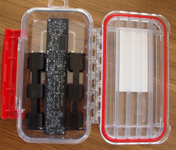

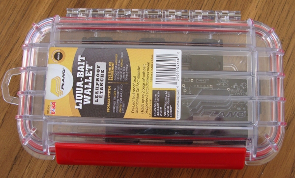

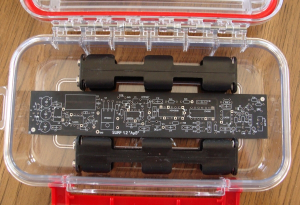

      Have yet to start my PI.
      Here's box option if you don't plan on using a tube.
      Just came across these new waterproof boxes at Wally World for about $8.00.
      Plano Liqua-Bait Wallet #4648
      7.375″L x 4.5″W x 1.75″H
      • #48
        Nice solution SVEN1.
        Good luck with your homework. Let us to have a look at finished device. Probably you need some foam inside instead of screw fixing?
