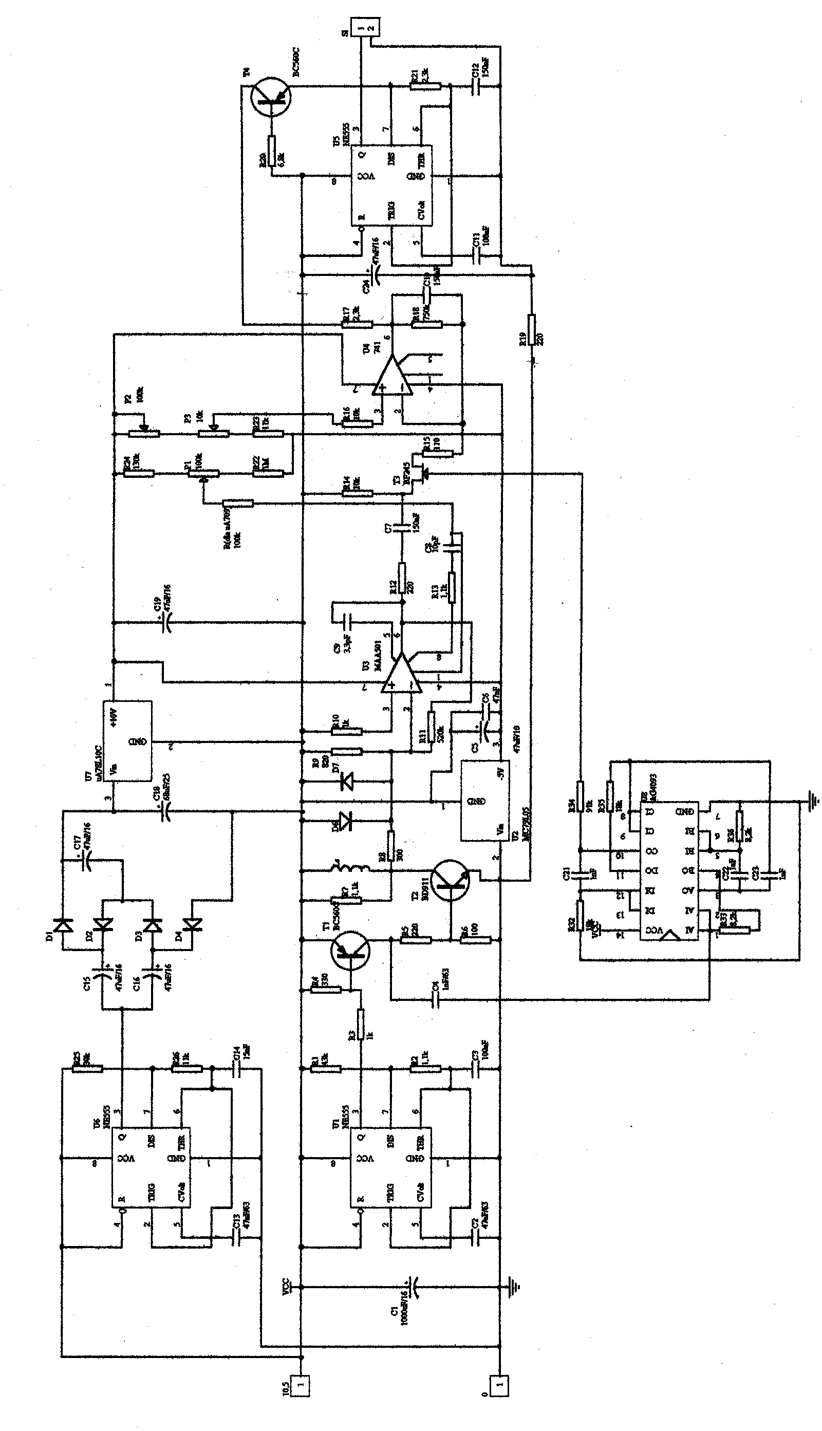

    Hi, I just tried the proscan PI MD. I made it on a board and it appears that it wont work. I think I might have to try to actually make the board exactly as shown, not just useing jumpers on the back. I fear there is to much chance for error as well as a lot of unwanted inductance and interferance. I also have shelved it but after reading this forum I think I might just take it out again and see if i can make it work.I had a lot of trouble finding BC560C but found substitute.

          Proscan PI is a modified version of Sandbanks PI that appeared in 70's in Practical Electronics. On my page I put a schematic which was blury. Paulo from Portugal redraw it. Unfortunately he mistook what I have overlooked.
          Go to the link below where you will find the "oryginal" Proscan PI (as all of you name it). Will try to attach it also.
          It surely works. But do not expect miracles, as far as stability is concerned. Depth is decent. If you still have problems email me.

            the only difference i see is c1 which on shematic is 1000uf/16 yet in component list is
            100uf/16 is this what you mean when you say over looked

              hi piotr found problem the pin out on bd911
              is to220 on mine B C E on pcb C B E so i changed it round and have got the coil pulsing
              but still not working i took voltage readings of all the pins on 709 amp and they were all input voltage do you think this has blown or gone short circuit same reading on every pin
              doesnt sound right ? also p1 has no effect on pin 6

                  corrections to the diagram
                  Hi Ian and Dan,
                  I had some Proscan PIs in my hand and must say it is not easy to blow the 709. I think you all have voltage supply problems. Please note that on the Paulo's diagram the GND pin of U7 is wrongly connected to the GND. It should be connected to the 10,5V. The same goes for C18 and D4. Also note that C1 should be 1000uF instead of 100uF.
                  After corrections, the voltage between +10,5 V and pin 7 of U3 should read 10V and between +10,5 V and pin 4 of U3 should be -5V. Check it.
                  Piotr

                      Re: corrections to the diagram questions??? piotr
                      hi piotr
                      im using the to92 package for U7 IN:GROUND:OUT if viewed from above with flat side facing you
                      are you saying that ground should go to the 10.5v live rail also do you mean turning round the capacitor and diode so the polarity is reversed EG + - - +

                            Re: Which Proscan PI?
                            Hi Ian,
                            WOW! I got it to work! And it works good too!
                            Heres what you do with the info that you got: the change of C1 100u to 1000u is right. Then the center pin of U7 ( ground ) goes to the positive 10.5v, (i'm sure you got this) well then- last one- from D4 to the negative side of C18 THEN to positive 10.5v (use a jumper) Because your board is etched you will have to eliminate the connection between neg C18 to the main neg line that runs through the center of the board. I did this and had excellent results. It sprang to life. I still have to tweak it but it appears to be one the right track.
                            let me know what how you do. Dan.
                              Hi Piotr,
                              I did what you said and it works! Its amazing.
