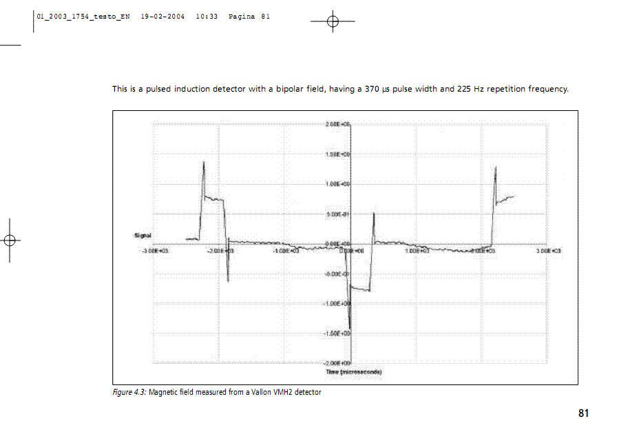

                  Hi all,
                  here is an field shape from Vallon WMH metal detector
