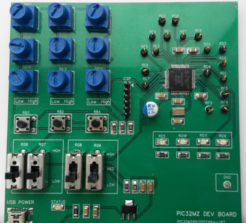

            I have made a development board based on PIC32MZ specially designed for PI metal detector test environment - it has got lots of pins for output signals, 4 leds, couple of binary switches,
            couple of 3 way switches and lots of onboard trimpots.
            So far I've managed to get pulse timing scheme (precision 5uS), ADC In + PWM Out, written on C with MPLABX and Harmony FW. Took 1 year to get to this point
            Right now I'm working on adding Delay & Freq control pot.
            I've got few boards of these (blank ones), I can donate them if anyone interested.
                  Nice PCB. I recently started a thread on PIC32 pulse generation here:
                  This is a special section dedicated to coding techniques, tips, tricks, methodology, programming various modules, MCUs, digital filters, etc. Basically, anything code-related.
                  PIC32's have hardware that the mid-level PIC's do not that makes creating pulse easy and very accurate.
