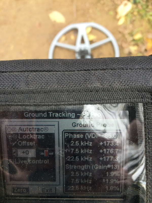

                          ...As a user of the Whites Spectra V3 and V3i detectors I would have one question: How to break the code-program Spektra was a change from -3F multifrequencies: 2.5k kHz-7.5kHz-22.5kHz to the option to use 2X extend the 3f multifrequency range to 5kHz-15kHz-45kHz ? Click image for larger version
