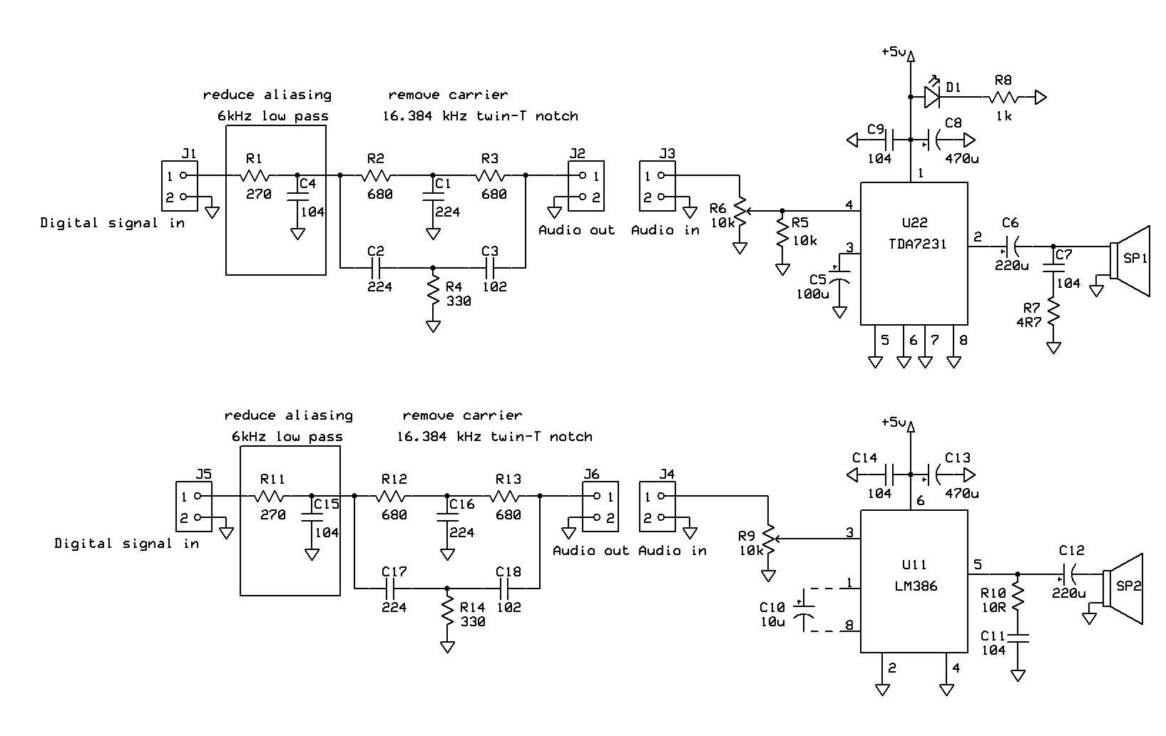

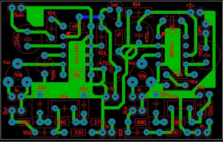

    My main goal was not to play with this filter but to pick the better behavior between TDA7231 and LM386, when supplied with only 5v.
    I used the code that generates signal even above 6kHz (400Hz to 15kHz adjustable with pot), also to be able to check the filter response as well.
