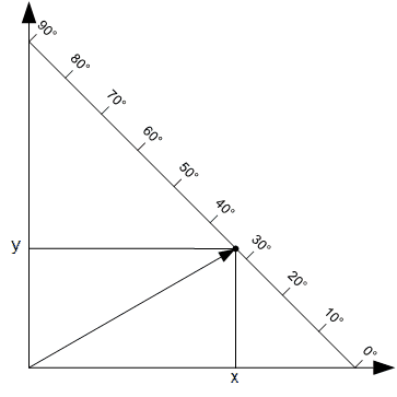

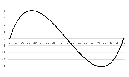

                I think this is how a lot of detectors do it. You can imagine a straight line from 0° to 90° with a unity slope and that passes through an x-y value. The phase is then y/(x+y)*90°.
                The approximation is perfect at 0, 45, & 90° and has a max error of about 4° otherwise. In the plot above the vector is actually 30° but calculates to 33°. You could then use a lookup table to further correct if that's important. The error plot looks like this:

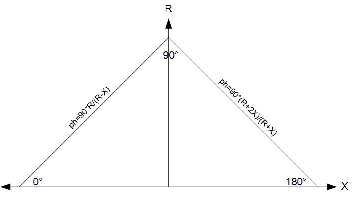

                You can also create another line for negative values of x. In a real detector I like to place 0° on the left axis and 180° on the right, and label the signals X & R instead of x & y so the diagram and equations look like this:
                In code you simply do this:
                Code:
                if(X<0)
                  phase = 90*R/(R-X);
                else
                  phase = 90*(R+X<<1)/(R+X);
                This requires a division so you still need to watch processor overhead.

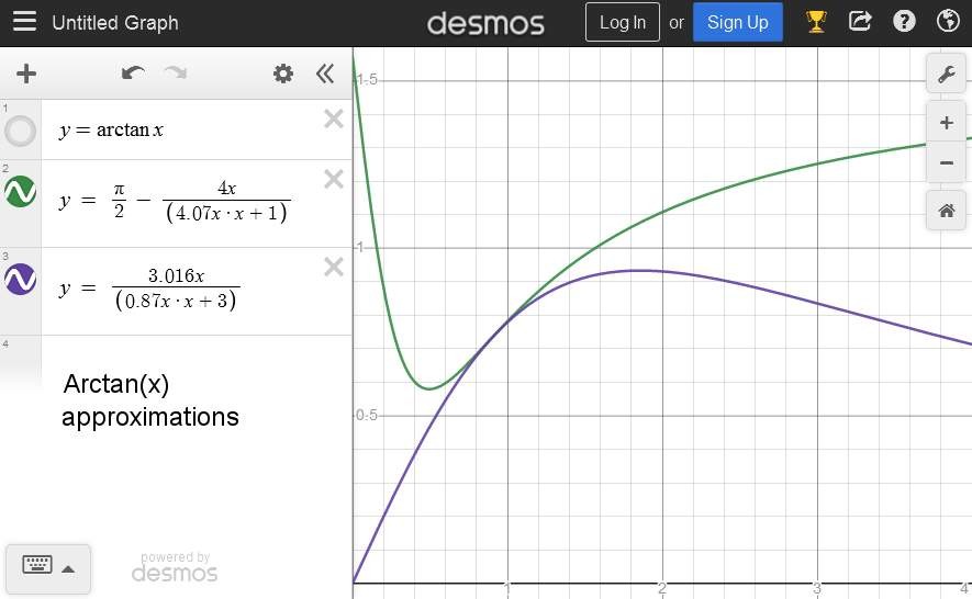

                  My earlier post dealt with some arctan approximations that were good for smaller angles, 0 up to near 60 degrees. As part of a scheme to split the atn function approximation into 2 (or 3) sections, what's needed is good approximations for large x values. These have to be correct at x = infinity, where atn (x) = pi/2 ( 90 degrees ). Functions of the form arctan(x) = pi/2 + a correction term are what's needed.
                  Based on a simple polynomial expansion, one very easy approximation is:
                  arctan(x) = pi/2 - 1/x
                  this is OK from 65 to 90 degrees, and tweaking it to:
                  arctan(x) = pi/2 - 0.95/x
                  can make it fit down to 60 degrees pretty well.
                  A better approximation (derived from a fast-converging expansion for the arccot(x) function) is:
                  arctan(x) = pi/2 - 4x /(4x2 + 1)
                  This is pretty decent, accurate down to about 50 degrees. With a few tweaks, it can be made good to below 45 degrees:
                  arctan(x) = pi/2 - 4x /(4.07x2 + 1)
                  This then allows the full 0 to 90 degrees range to be approximated accurately in just 2 sections.
                  Taking the small-value formula: arctan(x) = 3x / (x2 + 3) ( see previous post ) and fiddling with the coefficients, it can be made to match up extremely well to the above large-value expression:
                  arctan(x) = 3.016x /(0.87x2 +3)
                  They match up at x = 0.9 , where both have zero error.
                  Summary:
                  If x < 0.9 use:
                  and if x > 0.9 use:
                  The maximum error for this combination is about 0.3 degrees ( when x = 0.6 and 1.2 roughly ) which is very good.
                  I plotted the two functions on DESMOS, see attached image. Atn(x) is not shown as it just sits perfectly on top of the other two lines.

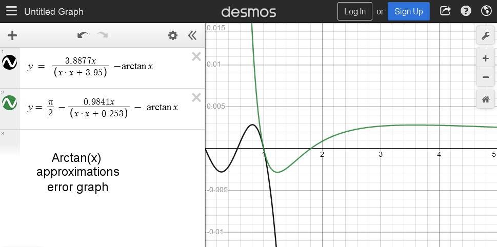

                    After a bit more playing around with the 'Desmos' program, I've come up with some more accurate approximations to arctan(x).
                    Choosing the transition point between the 'low value' approximation and the 'high value' one is tricky, but most other methods seem to choose x=1 ( ie. 45 degrees ) as the transition.
                    I readjusted the formulae in the previous post to an x=1 transition, and came up with:
                    For x < 1 use:
                    arctan(x) = 3.8877x / ( x2 + 3.78 )
                    and for x above 1, use:
                    arctan(x) = pi/2 - 0.9841x / ( x2 + 0.253 )
                    Both of these have matching errors, of < 0.16 degrees. This is half the error of the previous post. Neat.
                    An error plot for the two approximations is attached.

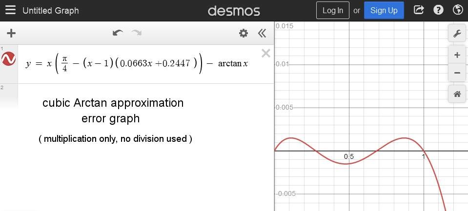

                    I had another rummage around the Web and found an approximation for the x < 1 case that doesn't use a division, only multiplication. It's a cubic equation:
                    arctan(x) = (pi/4)x - x( x-1 )( 0.0663x + 0.2447 )
                    which can be rearranged to:
                    arctan(x) = 0.0663x (11.846 - ( x-1 )( x + 3.691 ))
                    The maximum error is just 0.09 degrees, error plot is attached below.​
