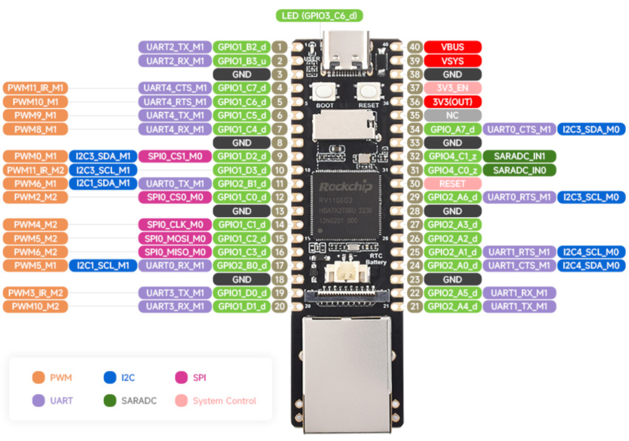

    As always, the devil is in the details. Here are the peripherals:
    For my purposes, it is excessively light on ADC channels. And I would need to dig into the PWM capabilities to see if they match well with typical detector needs. One of the reasons I've settled on STM processors is because of the timers. There are a lot of them, they are super-easy to chain, and they make it easy to gen multi-period pulse signals.
      I'm new to this, just heard a proposal for that development system a few hours ago. I didn't get to examine all the specs.
      What attracted me was the raw processing power, plenty of pins available, and the very low price.

      I'll see what the specs say. At worst, one can always add some powerful ADC to this system, right?
