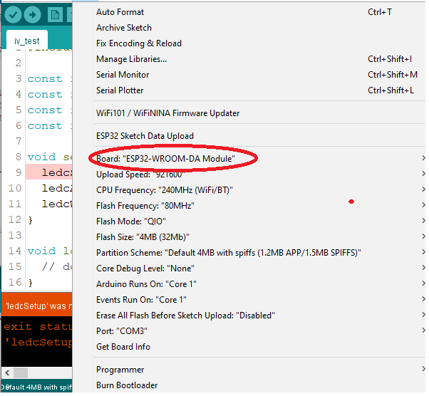

          post #17 3rror
          HTML Code:
          C:\Users\Galinka\Documents\Arduino\4_channels_ivconic\4_channels_ivconic.ino: In function 'void setup()':
          4_channels_ivconic:35:5: error: 'ledcSetup' was not declared in this scope
             35 |     ledcSetup(pwmChannels[ch], PWM_FREQ_CARRIER, PWM_RESOLUTION);
          4_channels_ivconic:36:5: error: 'ledcAttachPin' was not declared in this scope; did you mean 'ledcAttach'?
             36 |     ledcAttachPin(pwmPins[ch], pwmChannels[ch]);
                |     ledcAttach
          C:\Users\Galinka\Documents\Arduino\4_channels_ivconic\4_channels_ivconic.ino: At global scope:
          4_channels_ivconic:79:1: error: '​' does not name a type
             79 | ​
          exit status 1
          'ledcSetup' was not declared in this scope​
            Missing include of the correct ESP32 LEDC driver library or Arduino core headers,
            Typo or invisible characters in the code (like a zero-width space or non-printable character),
            Or compiling the code with the wrong board selected (like a non-ESP32 board).
              Make sure you have selected ESP32 board in Arduino IDE
              Go to Tools > Board > ESP32 Arduino > Your ESP32 board

                    ​error the same
                      Pick one generic for staters.
                      Idea is to test your setup for now.

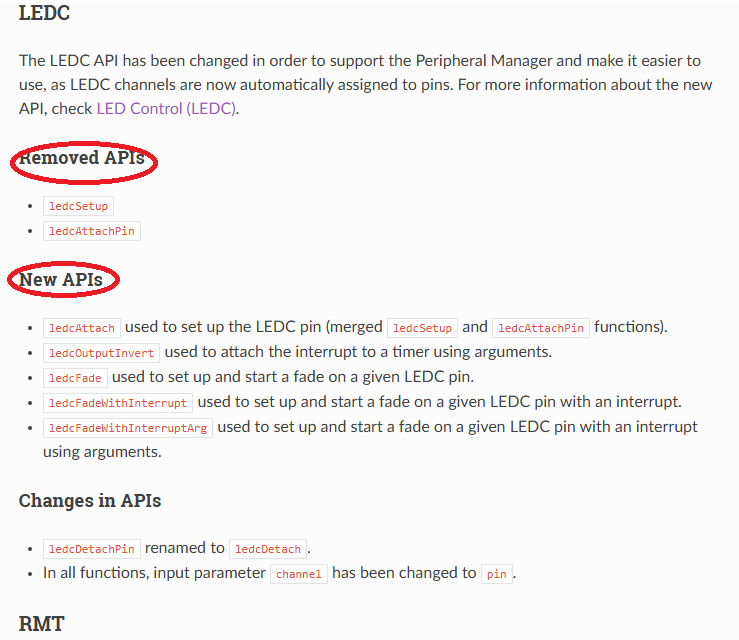

                        Migration from 2.x to 3.0
                        https://docs.espressif.com/projects/..._3.0.html#ledc
                        Click image for larger version  Name:	image.png Views:	0 Size:	69.5 KB ID:	438586
                          Oh right!
                          I have the older settings set for the ESP32S model that I use in my devices.
                          Experience has taught me; once you get the environment working properly: don't touch it again!
                          Open Arduino IDE → Tools → Board → Boards Manager.
                          Search for ESP32.
                          Make sure you're using ESP32 core v3.0.0 or newer.
                          Minimal working example (new API, ESP32 Arduino 3.x), just to test your environment:

                              post # 28, error
                              HTML Code:
                              iv_test:35:21: error: too many arguments to function 'hw_timer_t* timerBegin(uint32_t)'
                                 35 |   timer = timerBegin(0, 80, true);
                              In file included from C:\Users\Galinka\AppData\Local\Arduino15\packages\esp32\hardware\esp32\3.1.3\cores\esp32/esp32-hal.h:98,
                                               from C:\Users\Galinka\AppData\Local\Arduino15\packages\esp32\hardware\esp32\3.1.3\cores\esp32/Arduino.h:45,
                                               from C:\Users\Galinka\Documents\Arduino\iv_test\iv_test.ino:1:
                              C:\Users\Galinka\AppData\Local\Arduino15\packages\esp32\hardware\esp32\3.1.3\cores\esp32/esp32-hal-timer.h:35:13: note: declared here
                                 35 | hw_timer_t *timerBegin(uint32_t frequency);
                              iv_test:37:3: error: 'timerAlarmWrite' was not declared in this scope; did you mean 'timerWrite'?
                                 37 |   timerAlarmWrite(timer, TIMER_US, true);
                                    |   timerWrite
                              iv_test:38:3: error: 'timerAlarmEnable' was not declared in this scope; did you mean 'timerAlarm'?
                                 38 |   timerAlarmEnable(timer);
                                    |   timerAlarm
                              C:\Users\Galinka\Documents\Arduino\iv_test\iv_test.ino: At global scope:
                              iv_test:44:1: error: '​' does not name a type
                                 44 | ​
                              exit status 1
                              too many arguments to function 'hw_timer_t* timerBegin(uint32_t)'​
                                The errors occur because the ESP32 Arduino core has changed its timer API.

                                It seems to me that you have set up the environment completely wrong.
