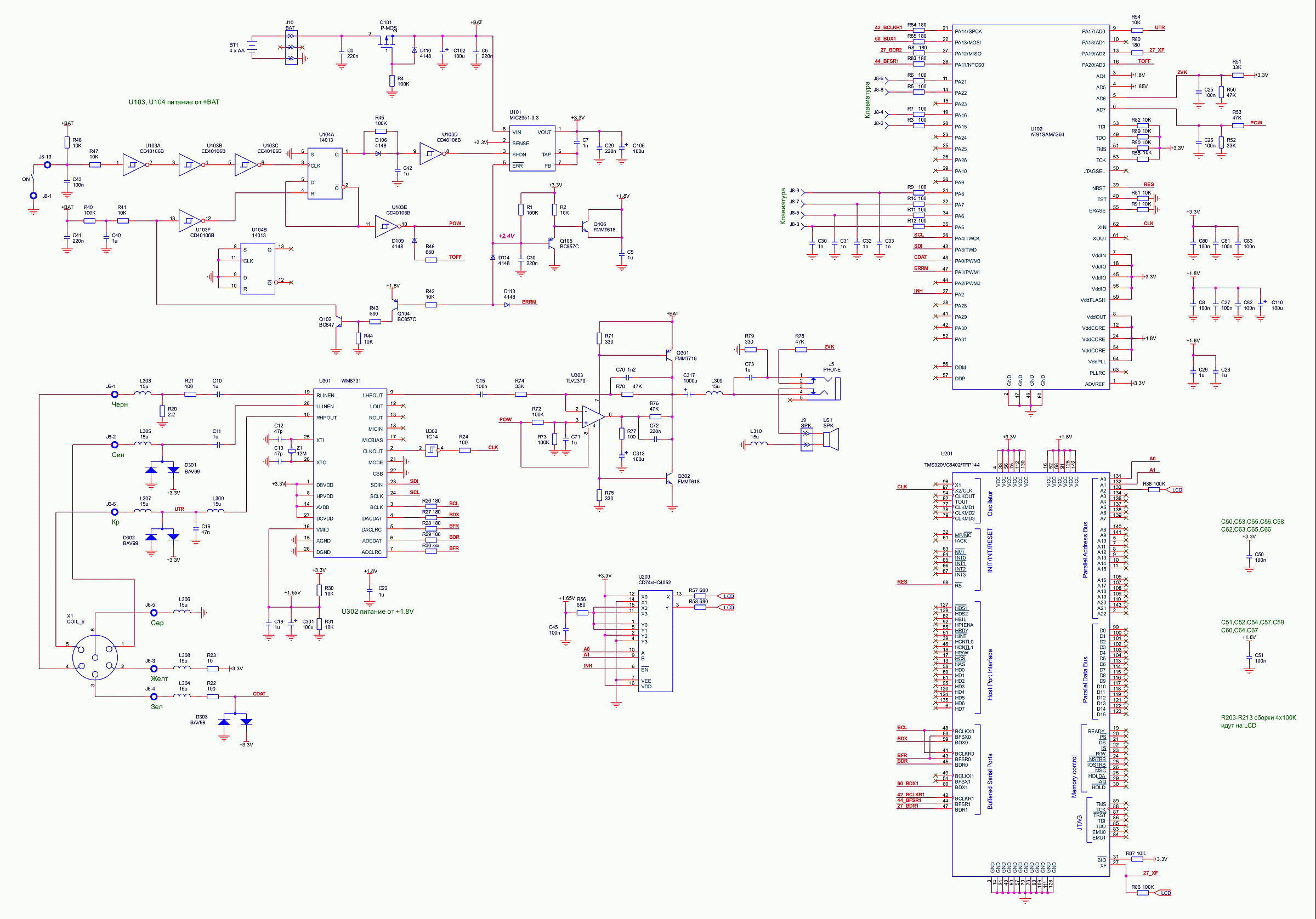

    Hi
    I need minilab x-terra 30 schematics or some repair tips.
    It doesn't start, it only turn on some segments in the display and then the segments fades out, if I then turn off and on again it turn on some other segments and then fades out. Any idears anyone?
    /Roland :-)
    Fresh batteries? Hopefully it's just a power regulator. If the chips are marked try to measure some of the power pins and see if anything looks wrong.

        the schematic and full description http://phazitron.narod.ru/repair/xterra.htm
          @Carl-NC - :-) I have fresh batteries. I have 6V and 3,3V even when the display fades out.
          @jap - I can't do a factory reset because the unit does not start, but I did try just to be sure ;-)
          @kt315 - Thanks! Now I can do some checking. :-D

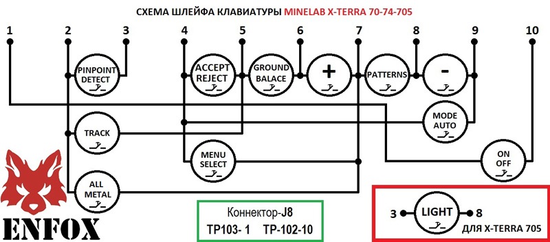

                  here schematic of xTerra did by Kostin, RIP.
ID:	344329Click image for larger version

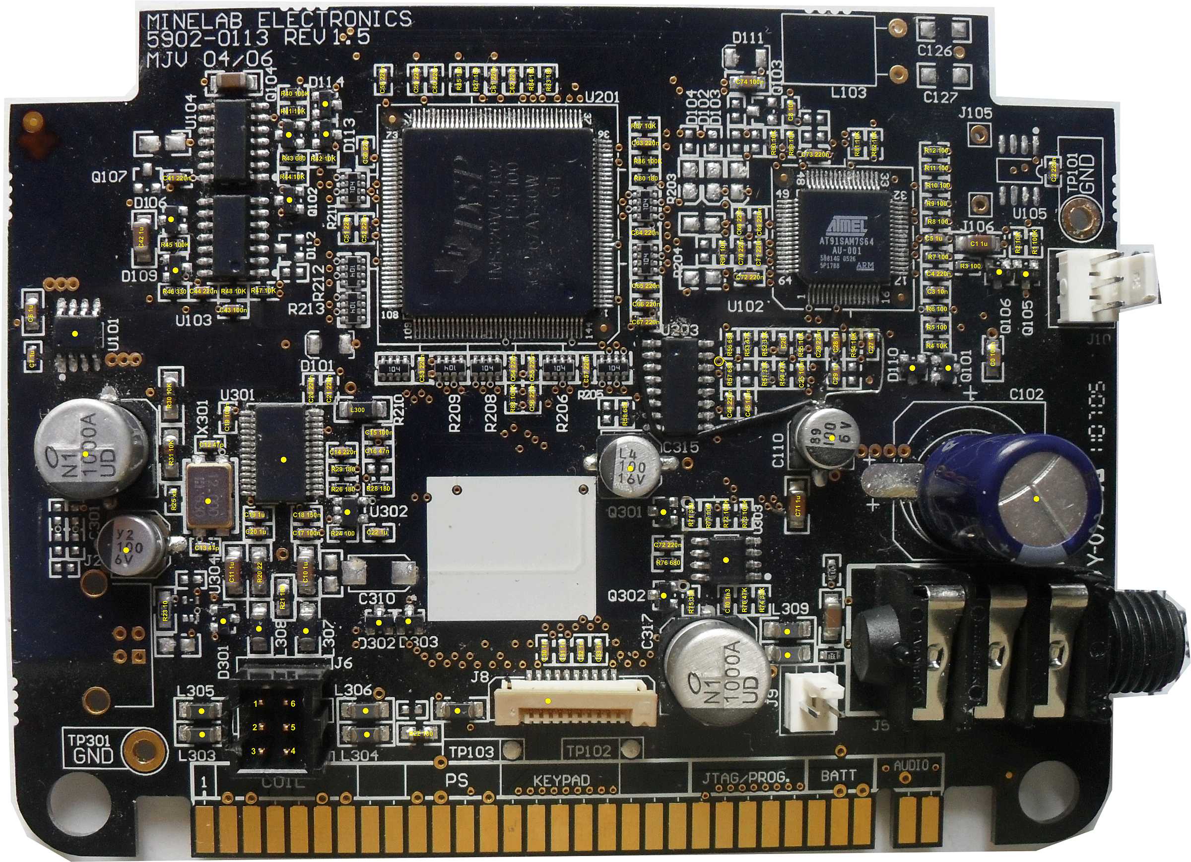

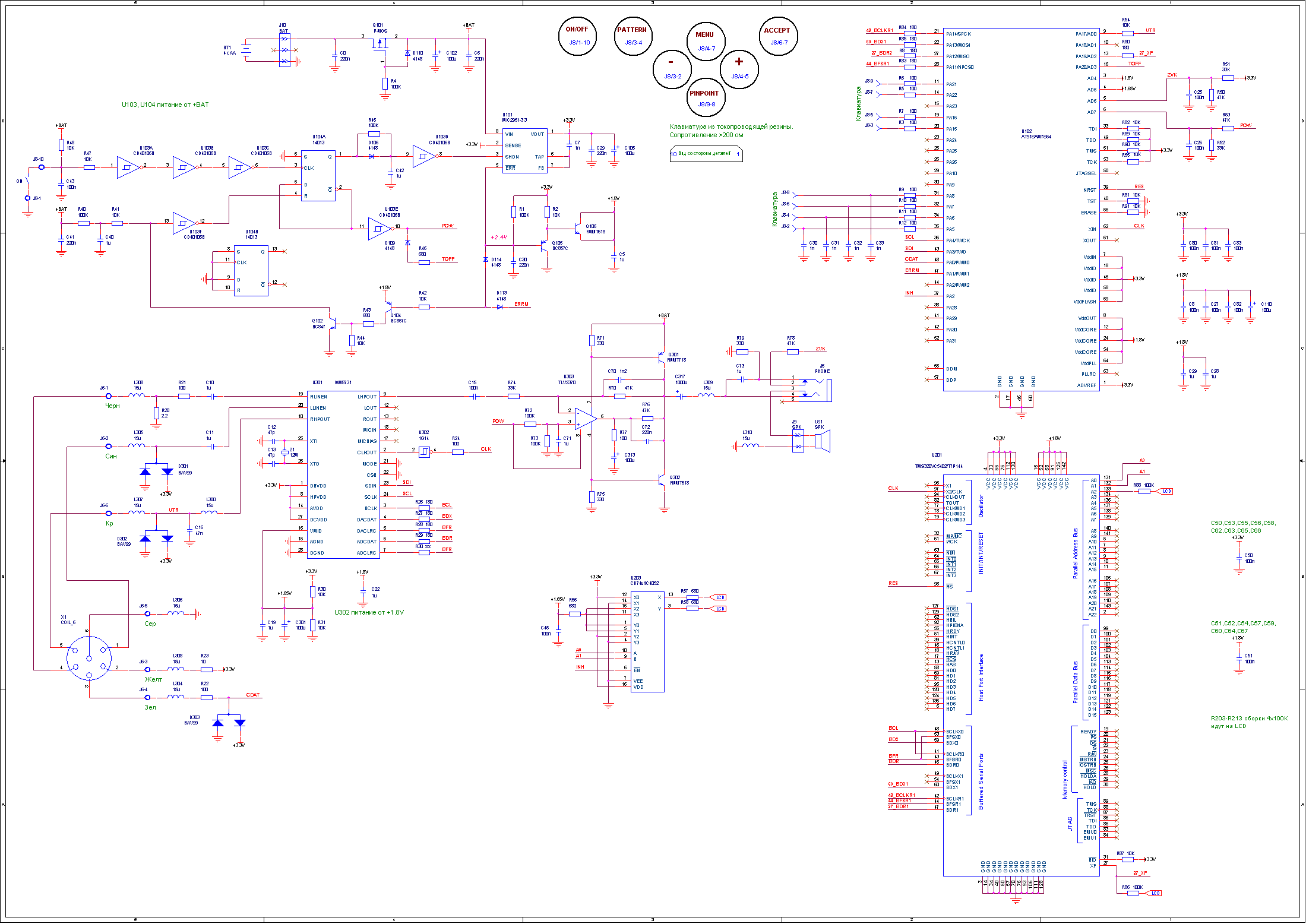

                    I have the schematic and the pcb with component lablels.
ID:	344331 and Click image for larger version
