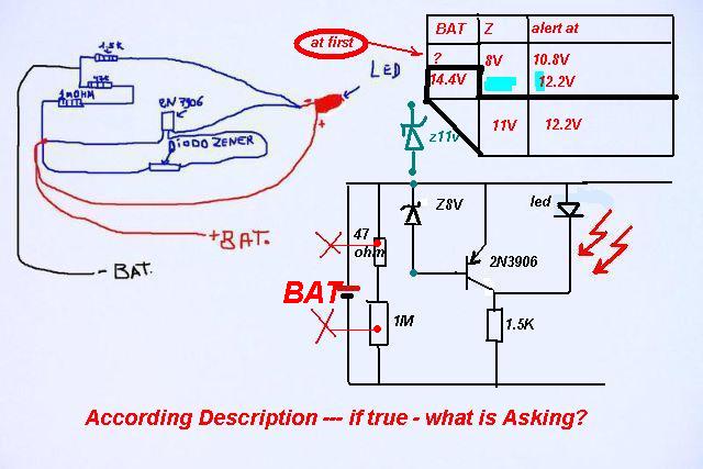

    list of components: A) resistance: 1 M ohm
    B) R-47 Khom
    C) R-1.5 Khom
    D) DIODE ZENER 8VOLT.
    F) 2N 3906 transistor 06-A
    Good morning friends. As I could not, by design, here, direct, got the link, the same.
    so it is: the detector, where I copied this scheme (already sold on the:1 - 09-2012.) the led, began to blink, to: 10.8 volts. this mine detector, as mentioned with batyeria exactly the same, the other will, flashes, to: 12.2 volts. now, this is not good! flashing had more or less the same volts. and then to 11 volt.
    I thought .... will the led, this mine detector, which before being changed by the manufacturer, working at 14.4 volts, and up to the zener diode mark on the board: 11 volt. (of course this circuit, LED flash, was removed, by the manufacturer, only the left LED on the panel) but if the LED blinking for different voltage or different value from the other model that I sold ...... is for this reason that this LED blinks to, 12.2 volt?? if so, what is the value of led, flashing, for now?
    Another thing, I think, if not, the value of the led, the problem ... perhaps the integrated ..?!
    I applied this, is: (ST 2N 3906 SD C) which was copied in another model that was 2N 3906 A 06) WILL HAVE EXACTLY THE SAME EQUIVALENCE? (PS) sorry, my design, I have no way to drawings! Must give notice to, ok!?)
    THANK YOU.
    CARLOS
    (PORTUGAL)

      Hi carlrod49
      This warning LED flash means the battery is low
      According Description --- if true - what is Asking.
      -not value of led , LED flash Depends on the value of batt ,the value of zener Zv.
      I hope I explained.
      best time

        wanted the LED blinks up, to 10.8 volts. or 11 volt, 12.2 volt and not to. I have to change?
          for, or LED,flash to 10.8 volts. e, not 12,2 volt.Then according TEU, COUNCIL, Profissional, QUAL, RESISTANCE, OU quales RESISTORS, A CHANGE?? Quale AND VALUES? AND REPLACE ZENER VOLT.NO 8.2? O Yes, change? Quale DIODE BY VALUE? CAN figure it, and here I SAY?? And then I AGO THE TEST, OK?
          Very thank you, friend.
          A) resistance: 1 M ohm ------- this change?, By quale value?
          B) R-47 KHOM------ - or this?? by quale value?
          C) R-1.5 -------- Khom this?? by quale value?
          D) 8.2 VOLT ZENER DIODE. ------- This diode does not change? ou if??? per quale value?
            Hi carlrod49
            I hope not to dependence on a translator that he distorts what you Want to explain.Try typing what you spoken this makes it easier To understand.
            -What is the name of the device?
            -What do you ask?
            -It is important to return the everything as it was.
            best time
            j.
              is possible, with the exchange of some component, LED, lighting, to 10.8 volts. or 11 volt? change to which component?
              and for what value?
              in this circuit, the LED lights up to: 12.2 volt.que should I change to, to kindle: 10.8 volts. or 11 volt?
              thank you
                RESOLVED!
