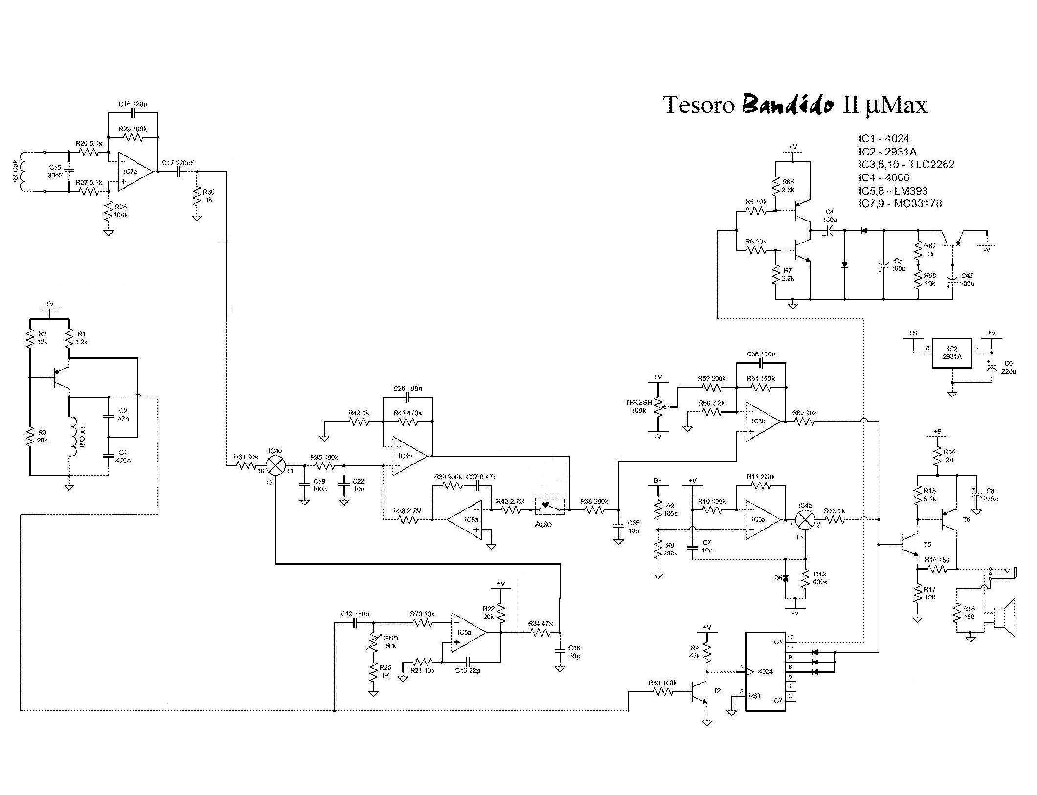

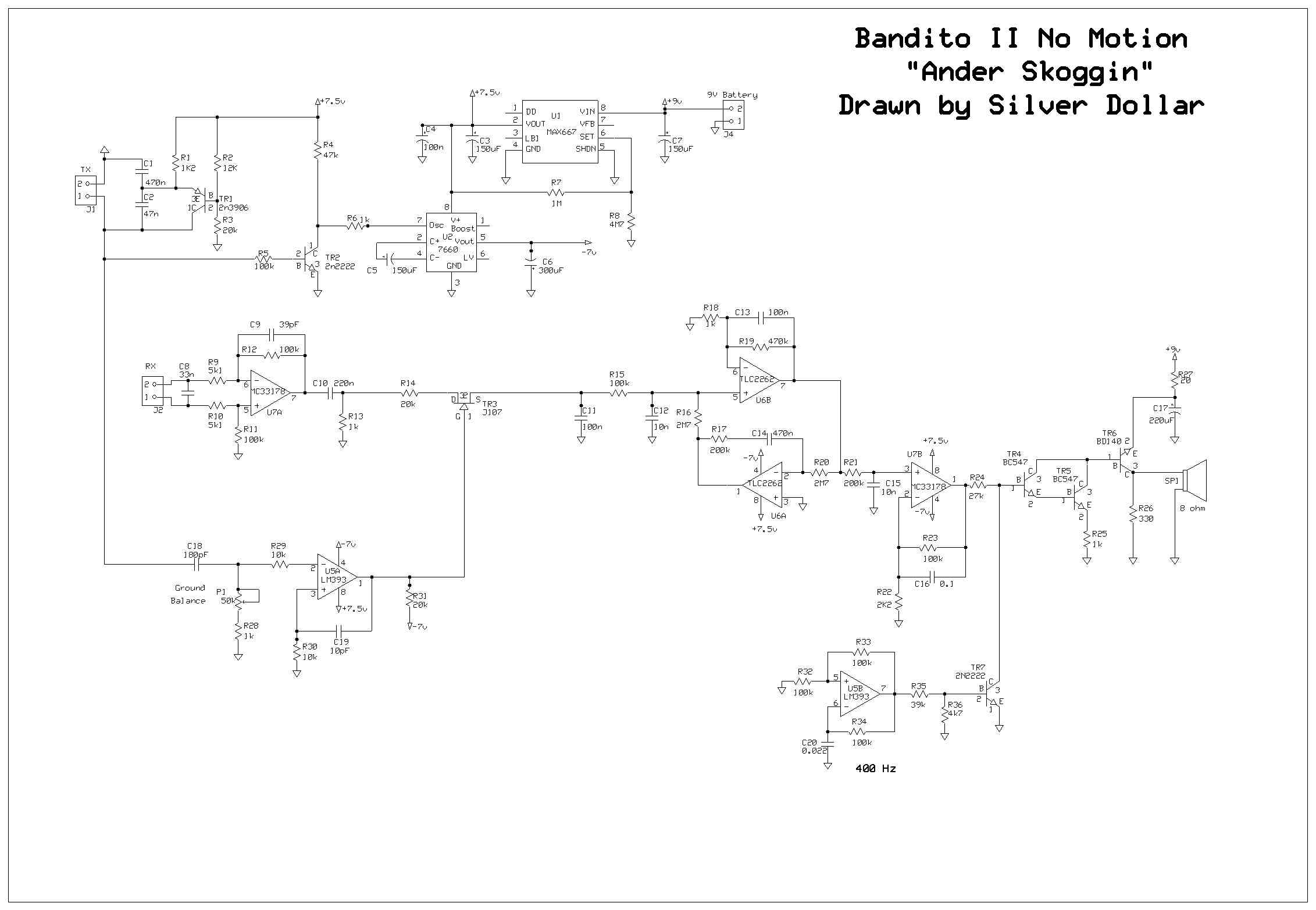

I am wondering if some one can modify the Bandido 2 umax schematic http://www.geotech1.com/cgi-bin/page...uMax/index.dat. I am not to savy in such things. I dont need the disc mode just the no motion all metal mode. Is this easy to do? Thanks
Bandido 2 umax schematic help
You have voltage regulator (2951) there which provides +V voltage, which is in fact +5V.Originally posted by grizzly View Postone more question. On the schematic there is a +v which is obviously + voltage and there is also a +B, what is the difference? Is +B the battery? If so why the different symbols? Sorry im a total nube to this stuff.
+B voltage is direct battery voltage, which is +9V.
So yes; there is difference in those and you do pay attention on that.
Also you have there -V (minus) which is approx. -5V, generated by chopper stage.
Pay attention and DO NOT confuse battery minus and pcb minus!
Battery minus is connected to GND.
im digging up an old thread here. I am working on making this finally. I noticed on the schematic that the schematic is missing the Sens portion. Is the sens linked to the disc? I dont want the disc but the sens seems like it would be important. Thanks
