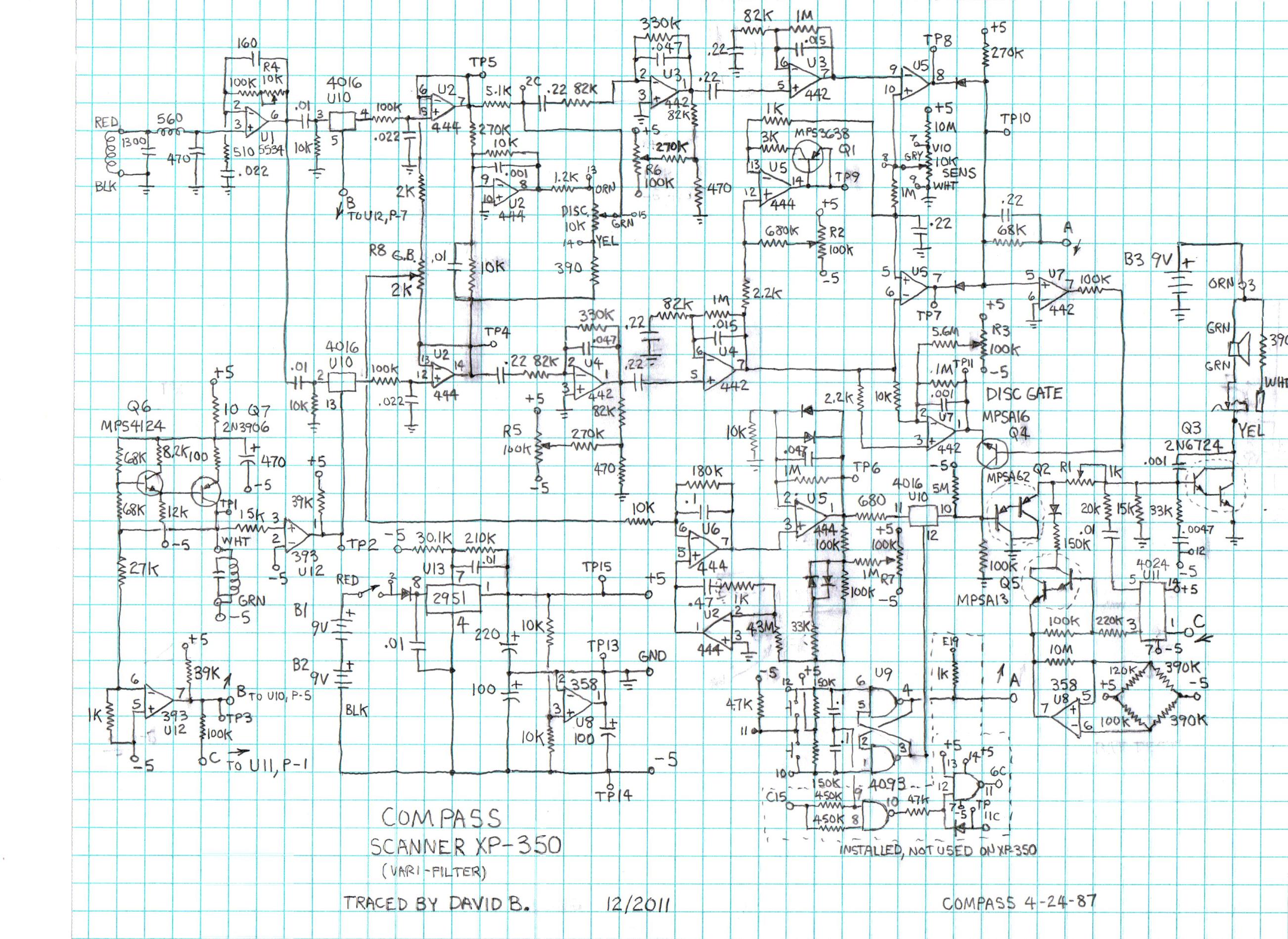

                There is a couple mistakes in my XP-350 schematic. It should be connected to ground at pin 3 of U7 and the other side of the 2.2k resistor connects to pin 12 of U5 instead of where it is. The 82k resistors at the offset adjustments connect to the right side of the .22uf caps instead of the left side.
                  David B. I wanted to thank you again for that schematic. I believe people should share information on obsolete detectors rather than hoard it for themselves. Hopefully, more people will add schematics of other Compass detectors, rather than be selfish.
                  Thanks again, David B.

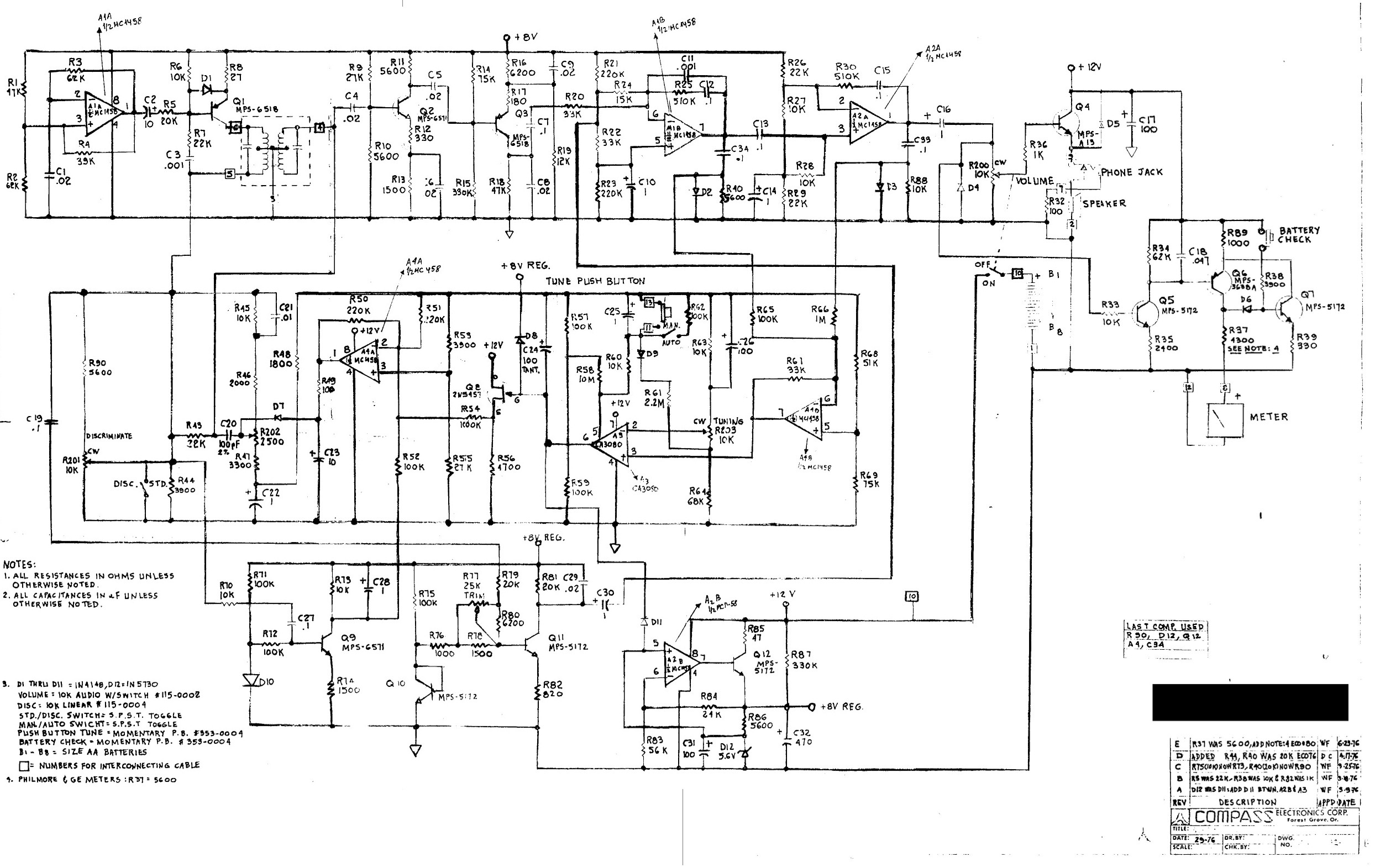

                    I found another schematic. Here it is. Anyone know which Compass this is? I am thinking it might be the Judge 1.
