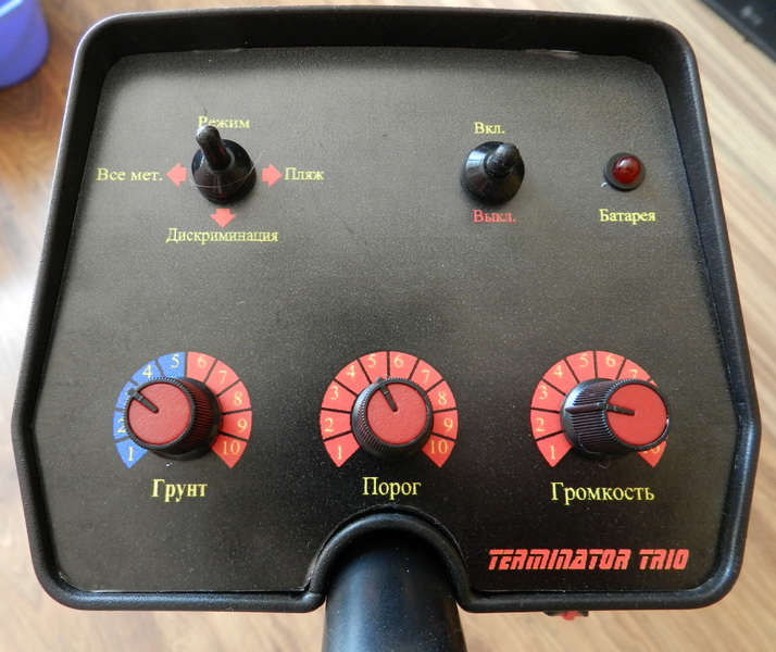

    hi, I open this top for you and will share here some files on Terminator Trio I see in RU zine. it is all not mine, everybody from Russia can write his name here being an author.
    Very interesting design. Smile's winner of this year. Thank you KT315 to post it here.

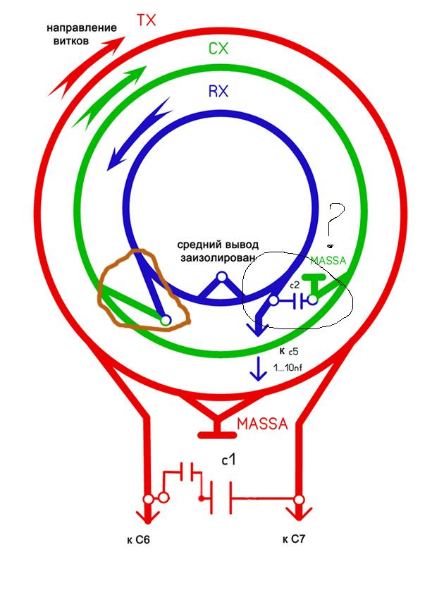

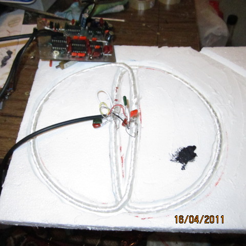

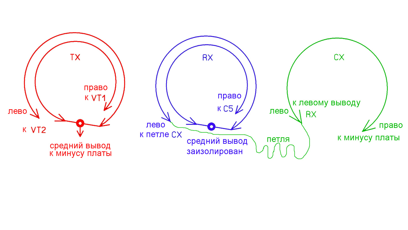

    Block scheme of coil realisation:

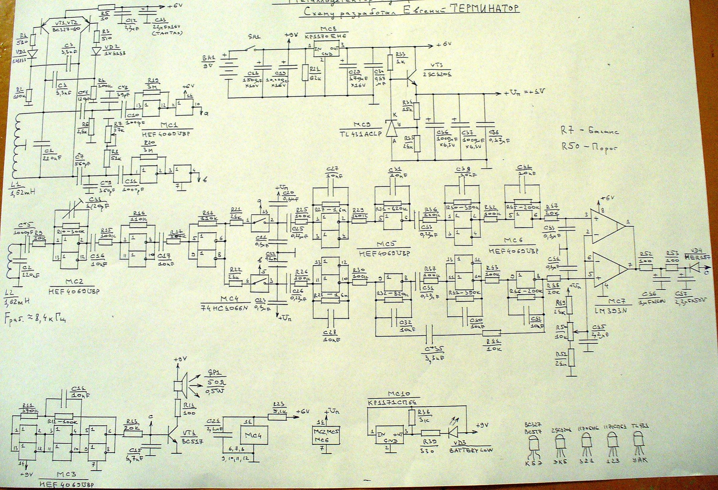

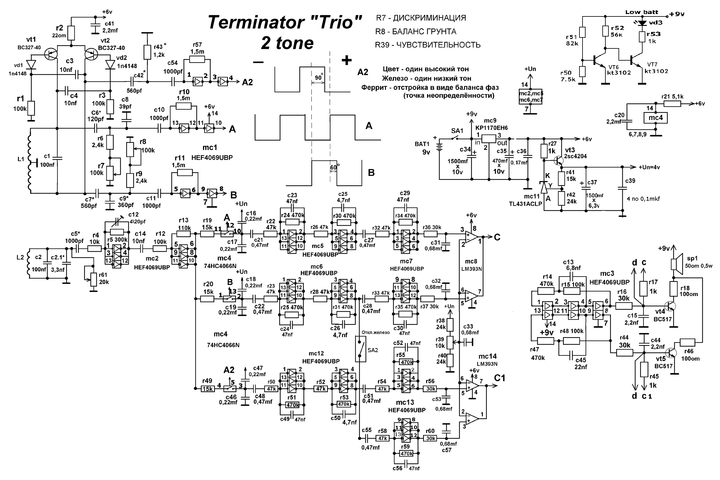

          very earlier schematic, yet without mods. only for history and for full objective exposition.
            I used to play with 4069UB some time ago. How much current does this rig draw without targets?
              Around 30 mA
                Nice. I'd try to get rid of R4 and R12 to improve noise, a bit of compression prior to the comparators, and a more proportional sound, but otherwise this is a nice project. Congratulations!

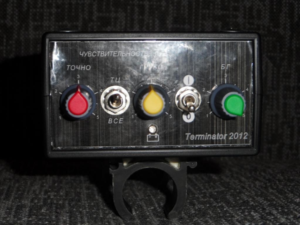

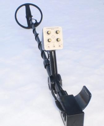

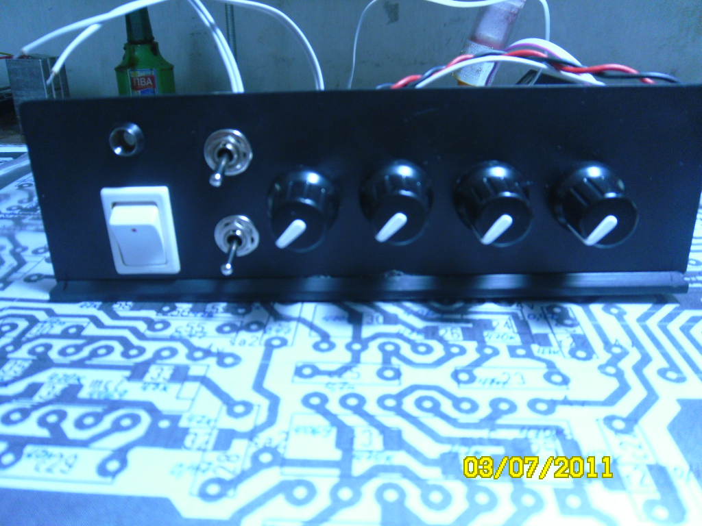

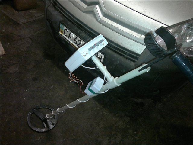

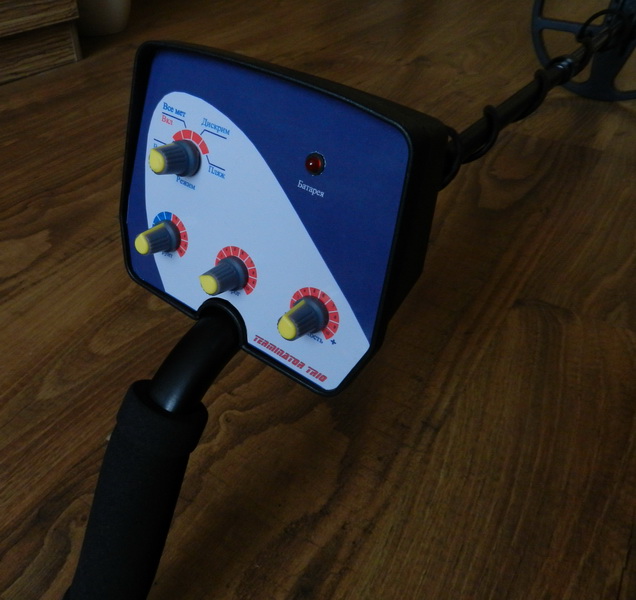

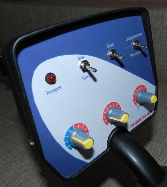

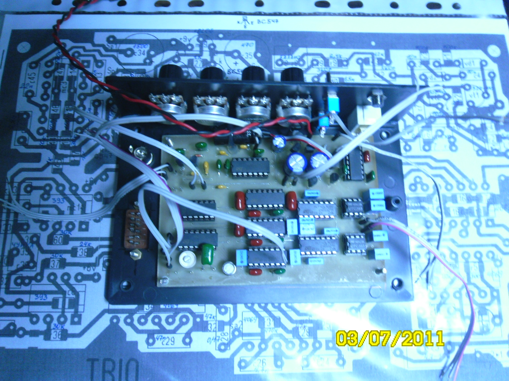

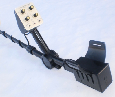

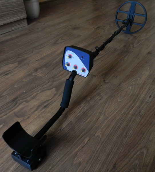

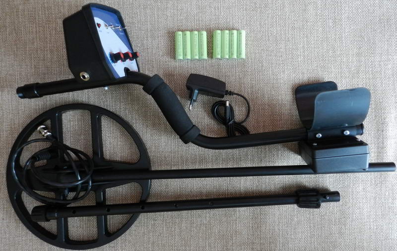

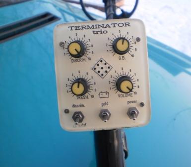

                      yes, I see many Terminators be selling by guys in RU zine... attaching some photos for you...Click image for larger version
ID:	334476Click image for larger version
ID:	334478Click image for larger version
ID:	334479Click image for larger version
ID:	334480Click image for larger version
ID:	334481Click image for larger version
ID:	334482Click image for larger version
ID:	334483Click image for larger version
ID:	334484Click image for larger version
ID:	334485Click image for larger version
ID:	334486Click image for larger version

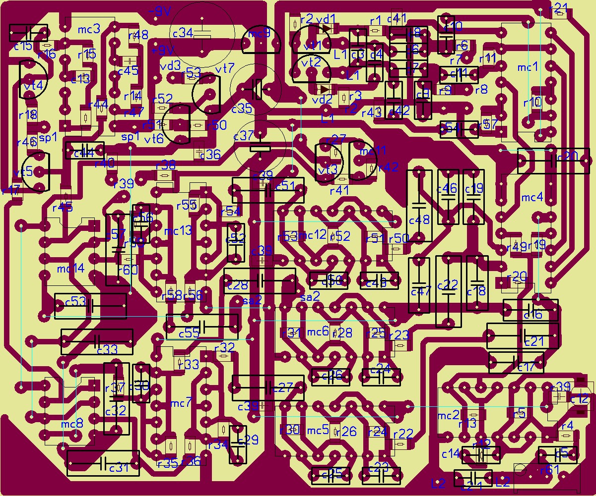

                          have you the pcb this detector in mode pdf
                          thank you
                            Hi kt315 would you like to send me part list? I start this project and make PCB pls help me
                            Tnx send here for all
