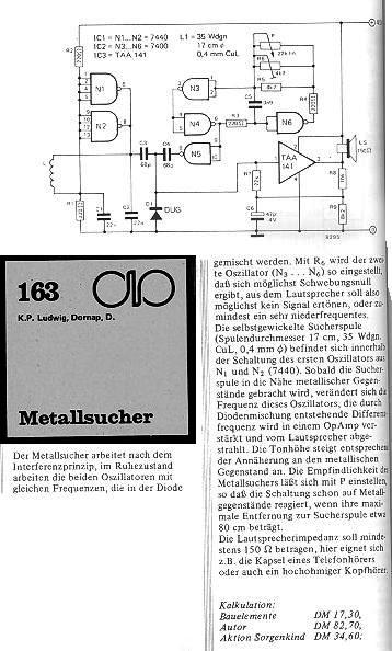

i'm posting this simple metal detector project that i found at a french electronic site hoping will test it here with some help of you i m on my way to build it but i didn't found the pcb image in it
and im missing the taa 141 too so its stoping me to staring it
as i read it can detect a metal at the 80cm distance but really can't tell anything about the volume of the metal detected large or small lets try to see .
not enought informations in the doc too
so if thers a nice pcb drawer us a nice one

[IMG]file:///C:\DOCUME~1\ADMINI~1\LOCALS~1\Temp\msohtmlclip1\01 \clip_image002.gif[/IMG] Coil diamètre 17 cm, 35 turns q form « o » , 0.4 mm
