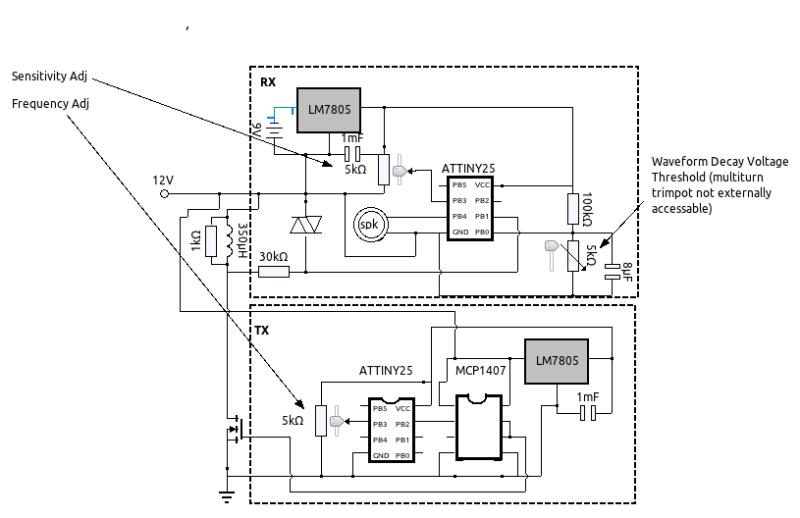

    there is a pattern to the network which we believe we can develop it here,which gives the file SOURCE CODE..
    So what do you know about this detector..
    the name is MAKE IT YOYRSELF...

    Originally posted by g.s View Post
    for everyone here..
    g.s, what means the Greek term YOYRSELF? Please translate in English.
    Who is the author of "yoyr" circuit diagram?
      http://www.miymd.com/index.php/projects/tpimd/
        hello mikebg here is the address
          Two microcontrollers, multiple batteries, diac, and no gain stage? ... My head hurts!
          PICKINI does the same decay time measurement scheme more elegantly.
            mikebg... the author's name is ......... Jon Mundall ......
            ODM ..
            the sensitivity regulated by pot 5k ..
              Yea, pretty weird to spend a lot of money on an expensive high resolution ADC without amplifying and filtering its input.
