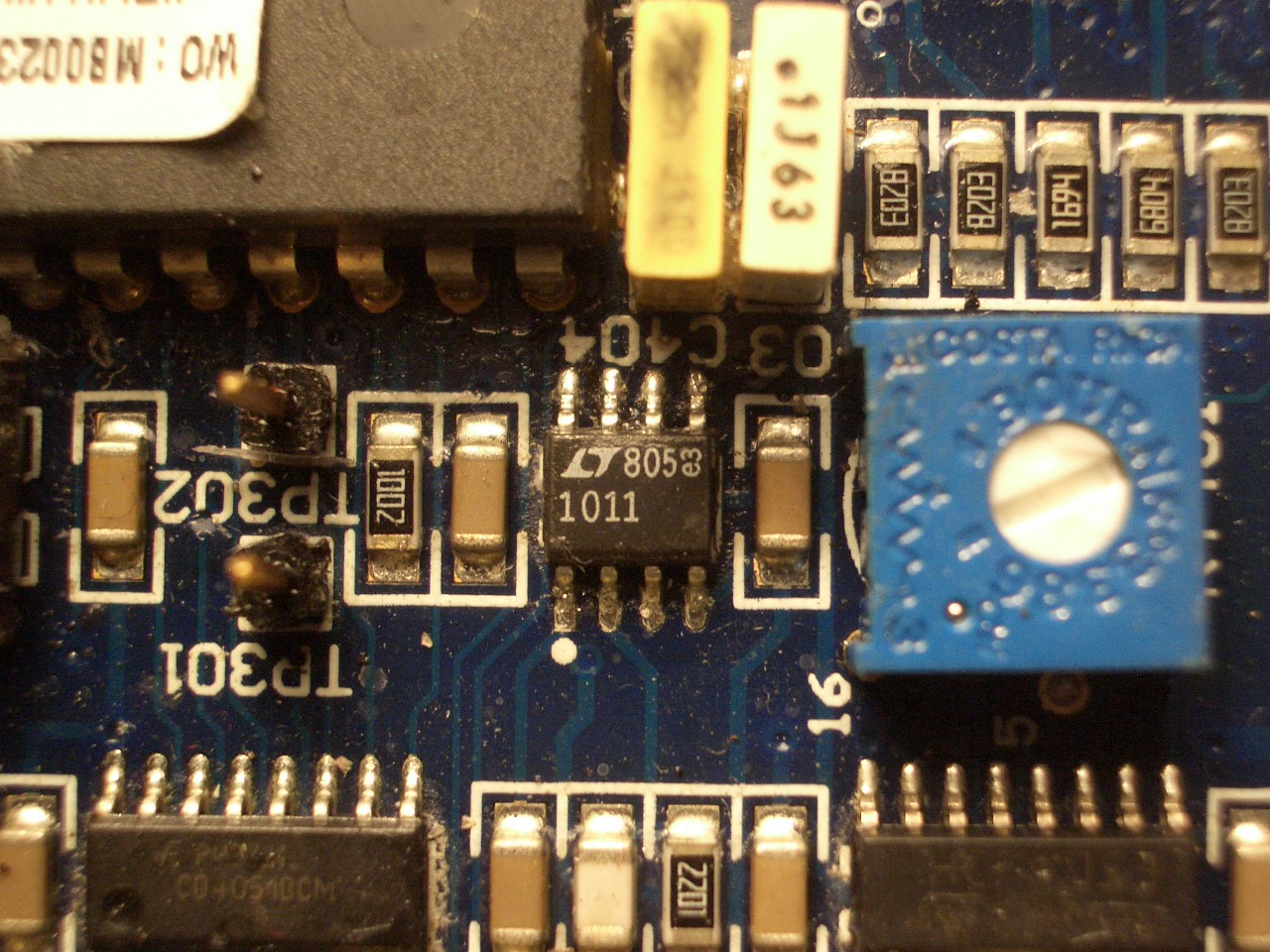

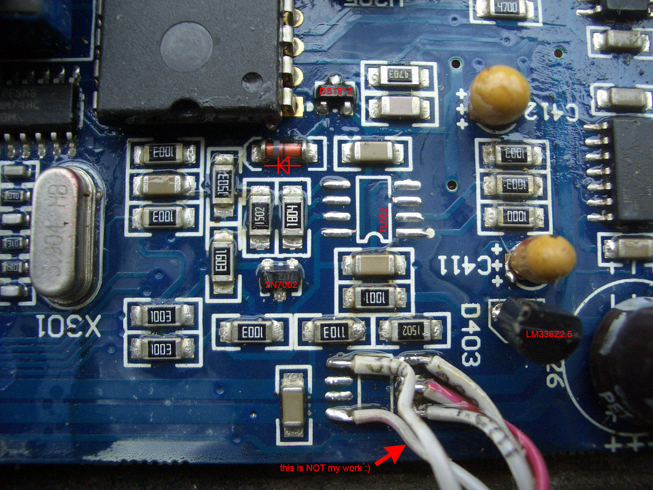

    hello, I try to fix a board... after some masters... on circuit ground is abnormal +10V.
    can anyone give me a full part name of this IC? it is I believe 'linear technology' but I find nothing on LT805.
    tia
    its a comparator
    http://www.linear.com/product/LT1011
    s
      thank you Golfnut. I changed TL062, did draw a part of board thinking it is power supply, but did not fix up. can anyone give me a vector?

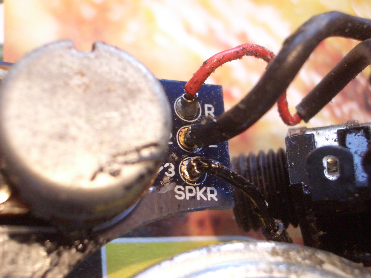

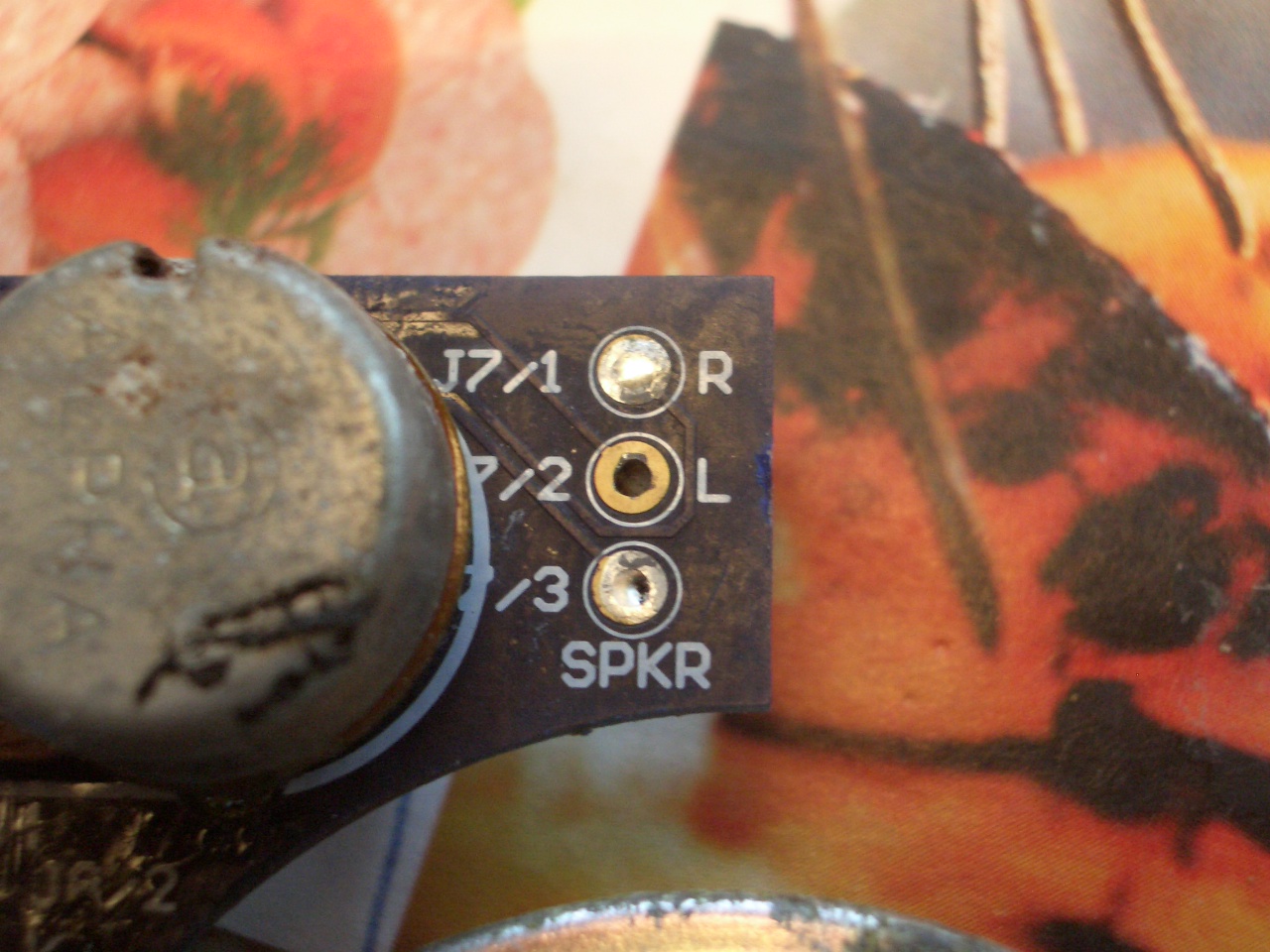

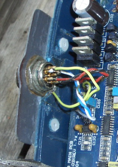

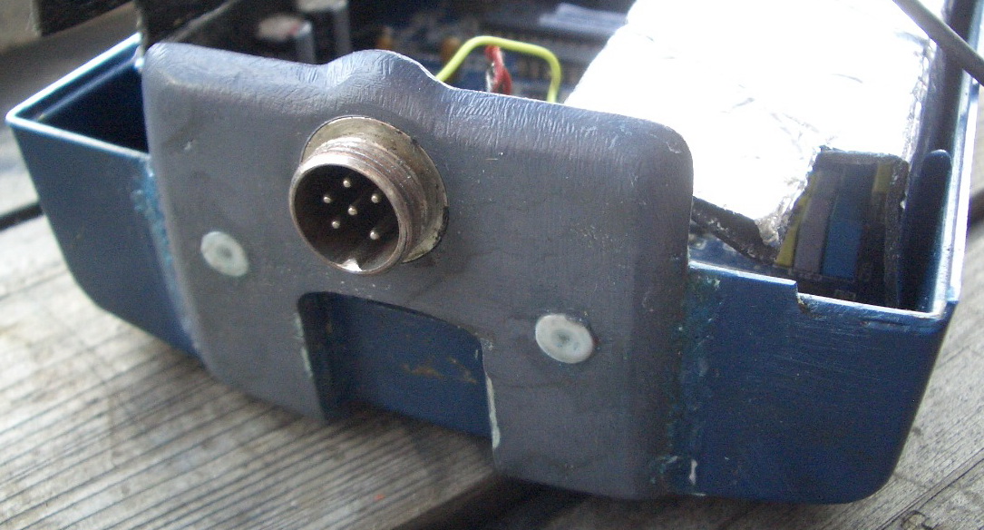

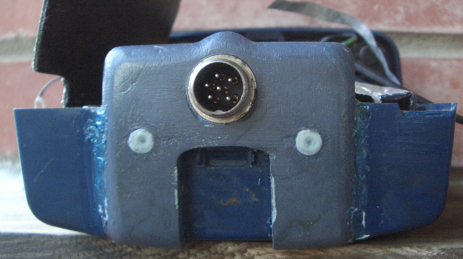

        hi Sean and folks,
        I found the problem. it was a solder short of a phone pad on ground board copper pouring, ie +5V on +12V, if reference is
        -BATT. what I made... I connected a power supply directly on the main board, ie without the panel board disconnected.
        then the ground voltage did stand normal +5V. this did give me a concrete idea that the problem is in the panel board...
        later I will draw a schematic of GT power supply...
        thank you very much for help
        all the best
          a solder short of pad R or L but at back side of the pcb.
ID:	337732Click image for larger version

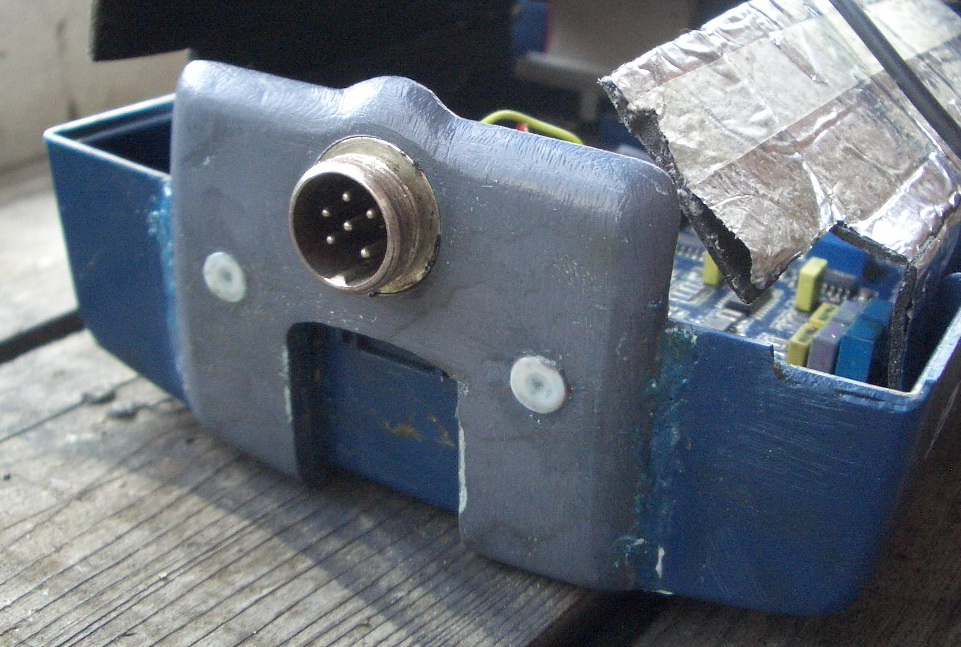

            I made new patch on back side of housing, because late made not mine was crude.

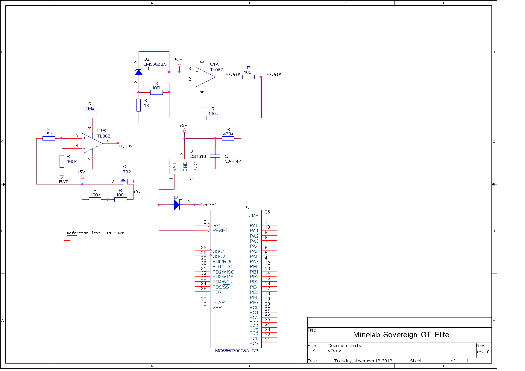

              as promised... done... sov power supply schematic...
