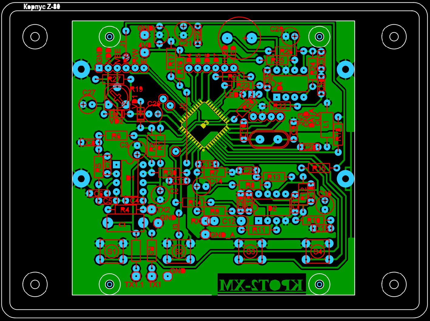

        Can you post here DIP (IC) trough hole single sided PCB version of "Krot 2"? Correct and checked if possible. Thanks.
          Here's a version of a DIP. But it is advisable to check.

            Perfect, i will recheck and redraw this version for test, unfortunately xmega's are not available in DIP.

                Just can't believe that damn Sprint layout is capable to generate at least barely useful PCB, very nice work, but this one goes into Protel, as is, without any modification, will post on Krot forum too, I just registered. I can read Russian (actually learned in school), but time is to revitalize my writing skills.

                    Parts: C26,27, D1,2, R19,27, can be omitted from original schematic, Winstar WH1602B display should work without negative bias from 3.3V, just a resistor to adjust contrast (I hope?)
                      It is applied normal display 1602 (+5 volts). Specifically to buy a 3.3 volt is not necessary. Components C26, 27, D1, 2, R19, 27 form a negative voltage and allows you to control the contrast of the "menu" of the instrument. Backlight unit, is also included in the "menu".
