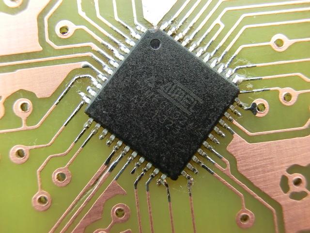

      Xmega chip soldered at PCB No: 3. Decided to build this one PCB for test first.
      Probably all tricks of solderind such precise pins is in good soldering paste. Here I use Amtech 4300/LF soldering flux.
          [ATTACH]26980[/ATTACH]
          Good job WM6 ..too much soldeing paste less its enough
          • #95
            Yes. I have to figure something for more precise dosing.
            • #96

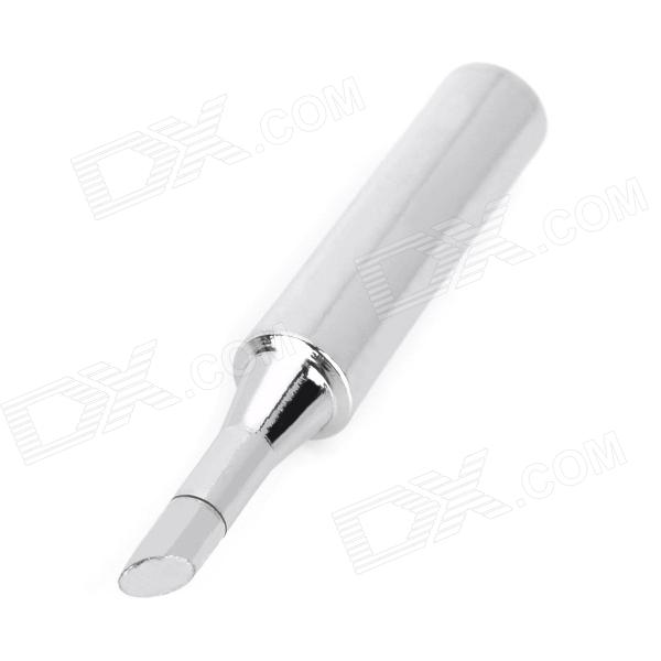

              if you wanna fix now to make nice look , just put a few flux ..but a very few then with desoldering braid ( wick is a good brand) remove the excessive sold paste
              bevel tip is a good choice Click image for larger version
