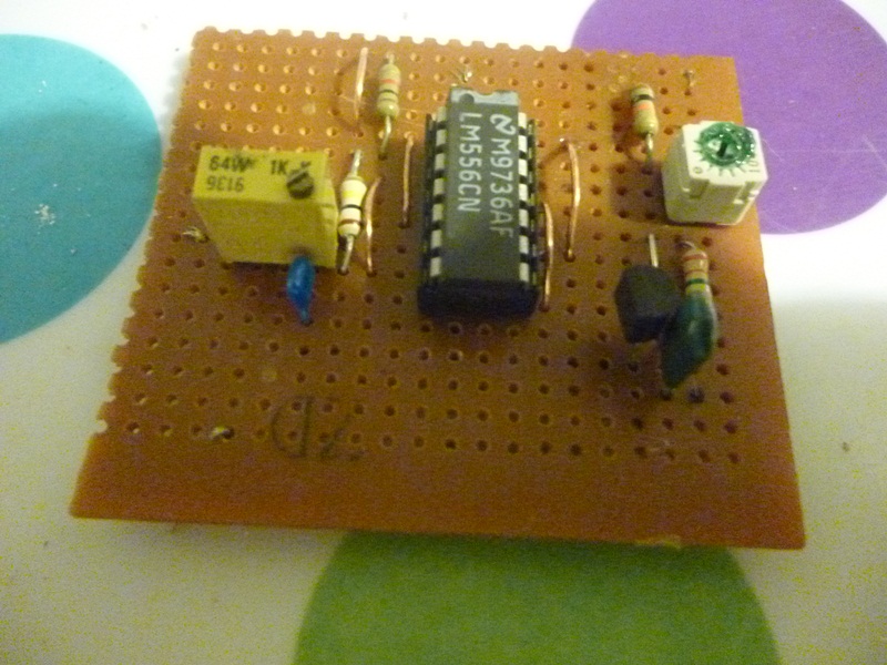

            I have no need of the circuit board in the pdf just using a PCB off cut which seems more than big enough for this project .
            OH BTW i am not using the lm556 just handy for testing till i buy the cmos version from jaycar electronics.

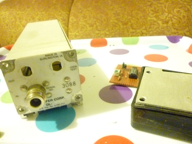

            The housing i have found i had a few old SHF downconverters used to receive PAY tv back in the 90s...no need for them these days so scrapping the insides and i with house the circuit board and batteries its also water tight as the thing used to be connected right to its antenna outdoors ... also has a nice fitting plastic end cap which would protect any controls from the weather.Click image for larger version
