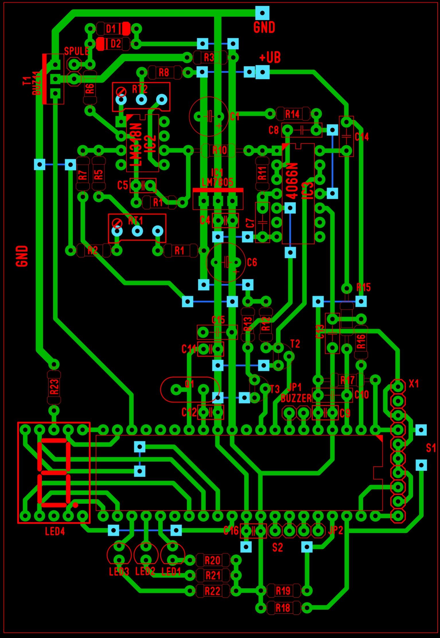

pi detector with pic controller
  • pi detector with pic controller

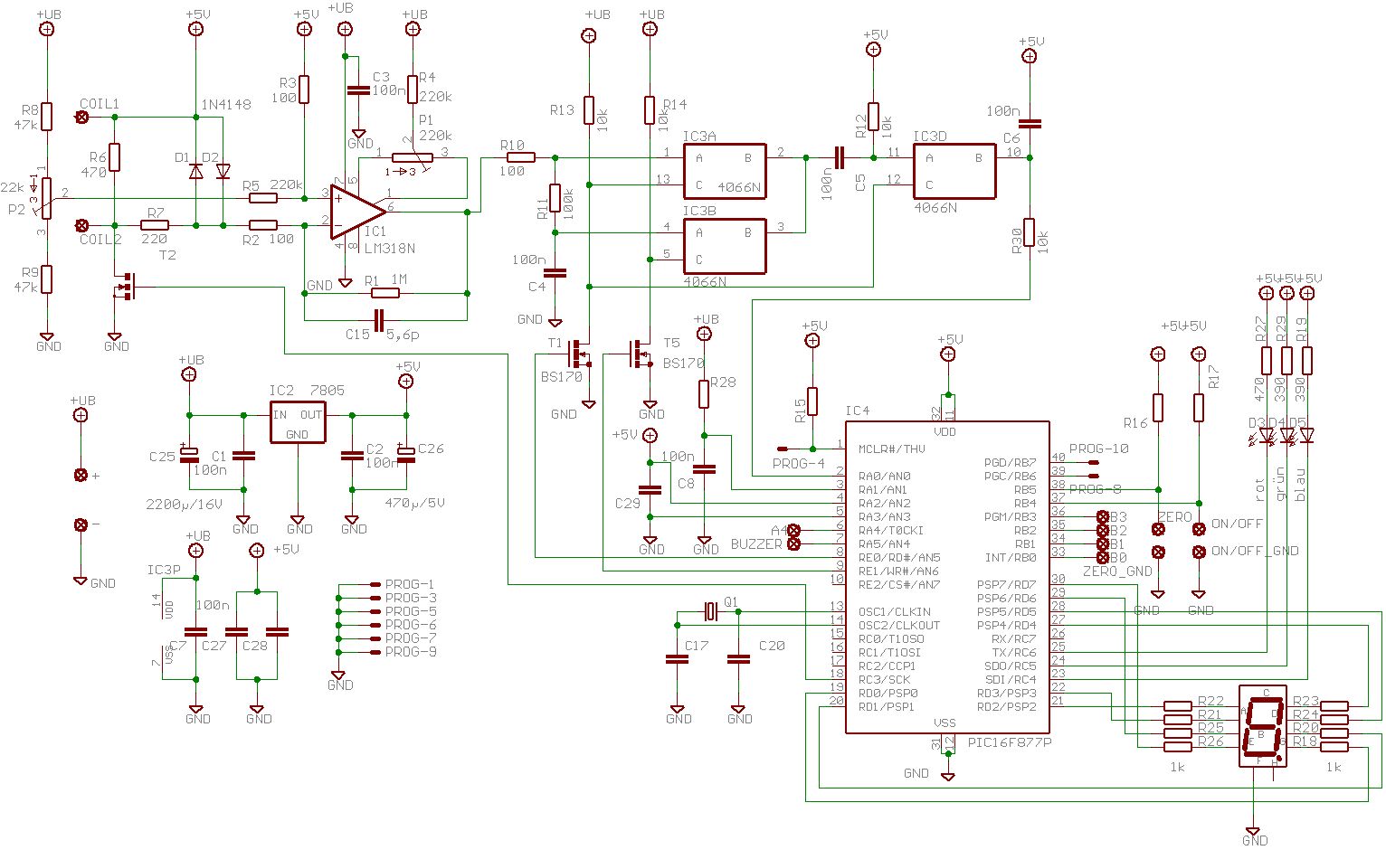

    hello here is a shematic from a known as working pi unit
    at moment not 100% able to drawn a good pcb from it
    first who present compact pcb with trough hole components gets full program files from me and15€ via paypal good luck

    What that LED display serves for?
    Btw i am having that schematic for long time, never really payed attention on it.
    HEX file is 6.105 bytes long, right?
    If you are sure that it is alright to make it than later we can draw pcb, no problem.

        Yes but what is indicated on such VDI!?
        I don't understand well that
          Hello,
          is not clear what author means.
          He wrotes target is indicated by buzzer and the led display.
          Could first mean the signal strength on both.
          OR buzzer for audio and led display separated for target inductance.
          Two possibilities which can only be cleared by reading the c source code.
          But iám a noob in coding.
            ah now i see another thing
            led red , green, blue
            and seven segment display
            for rgb led
            i read c code
            but what i think
            rgb ist used for target type indication
            and power status
            seven segment i can not understand the use?

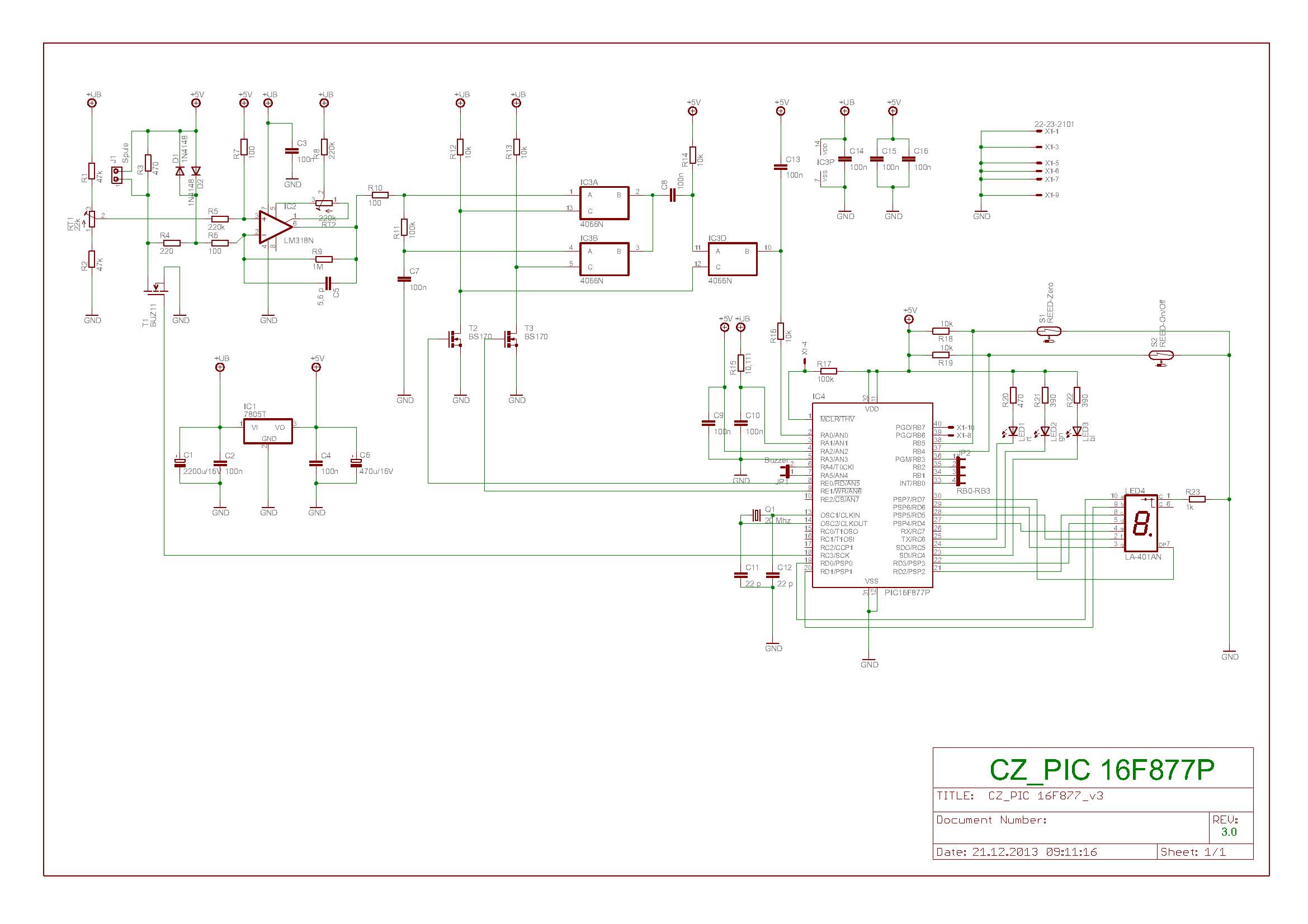

                  got this from user württemberger at german detektorforum
                  he is also here in geotech
                  many many thanks
Name:	CZ_PIC 16F877_v3_Sch.jpg
                  other part names and a change at the seven segment display (only one resistor)
                    Must be checked; R16 from pin 2 goes nowhere.
                      I ran over it without detailed checking.
                      Also corrected R16.
                      Must be checked in details for any more eventual mistakes
                        Here is the correted Picture.
                        The 7.Segment display the "deep / size" of the target.
                        The deeper the target, the lower the display.
                        (0,1,2,3 .... 9, A, B, C, D, E, F)
                        Very small or deep display = F.
                        Large or near display = 0

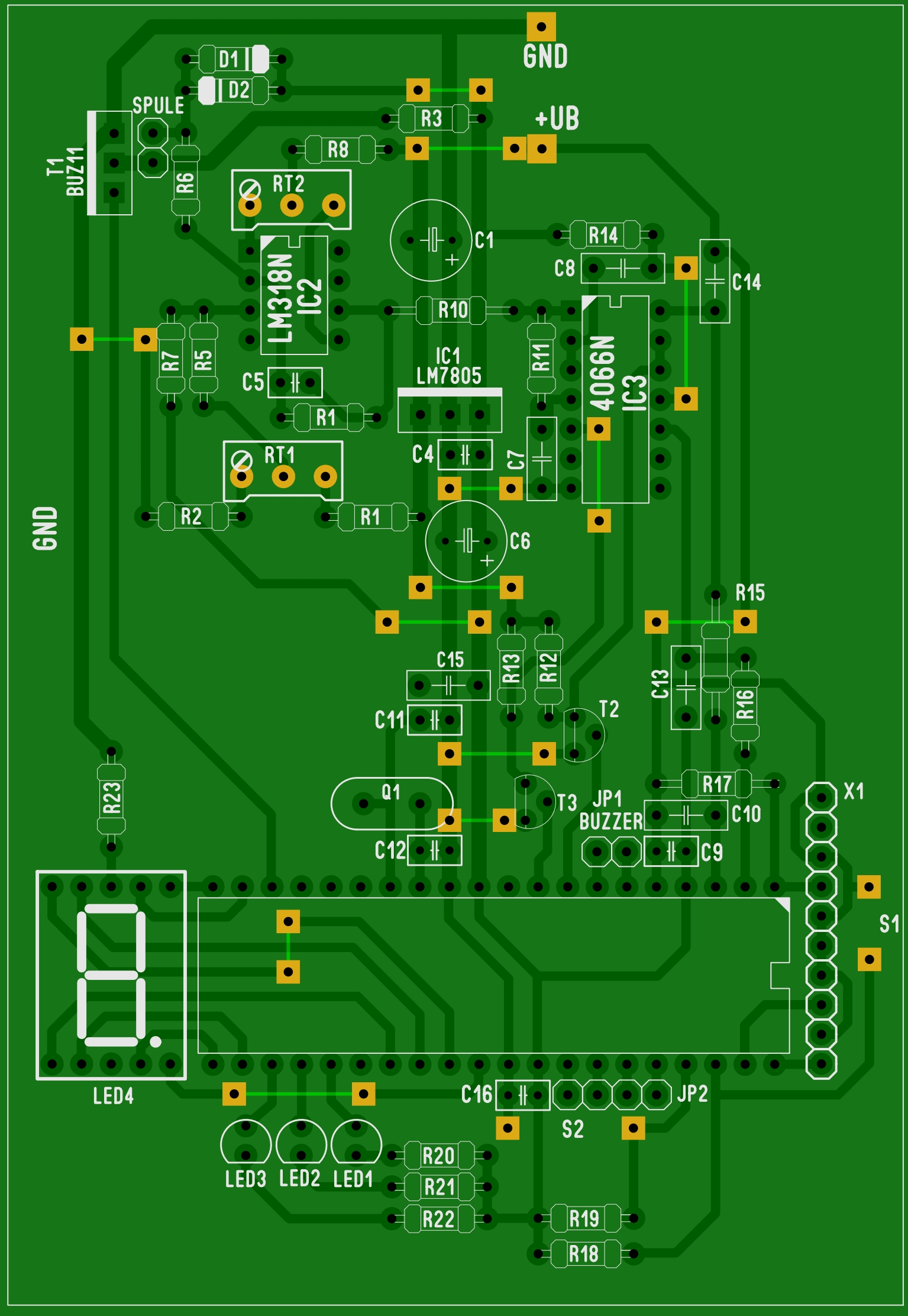

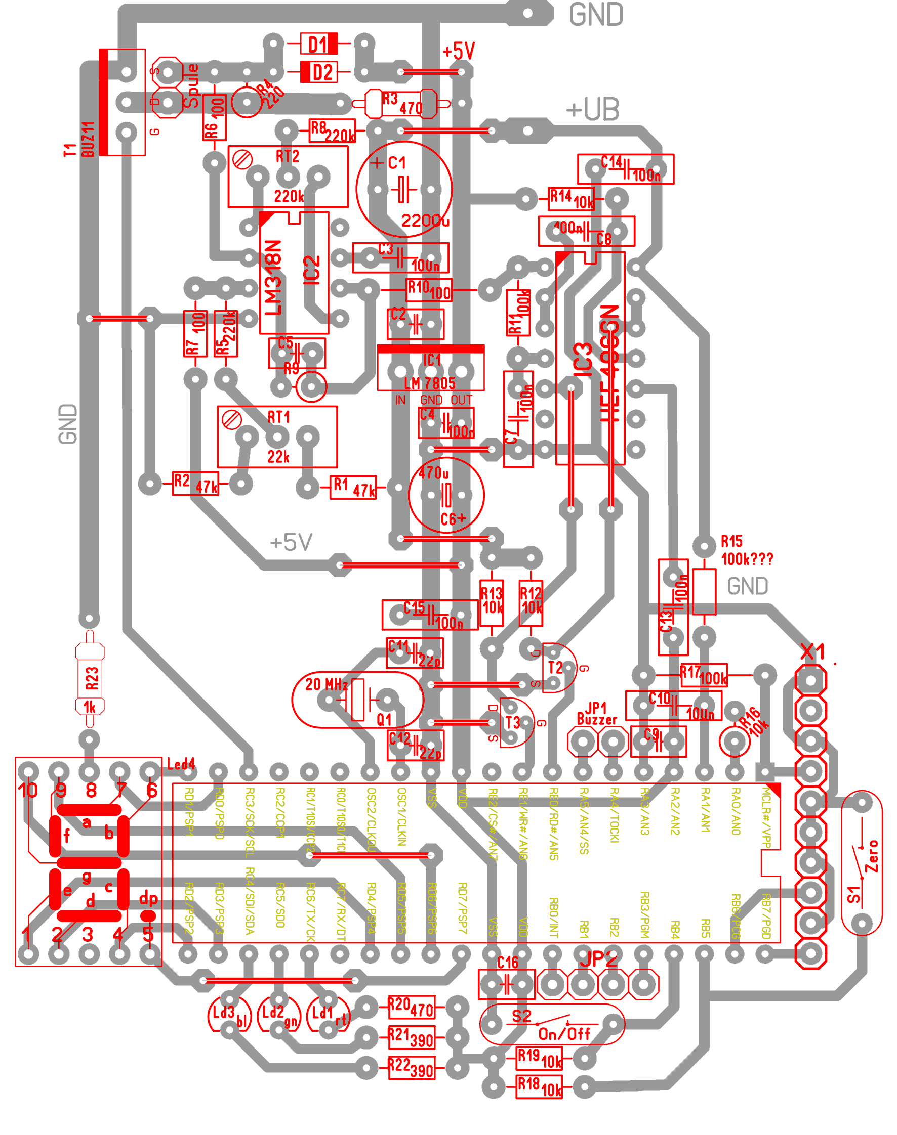

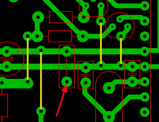

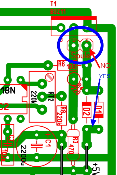

                          Two mistakes....Click image for larger version
ID:	338738Click image for larger version

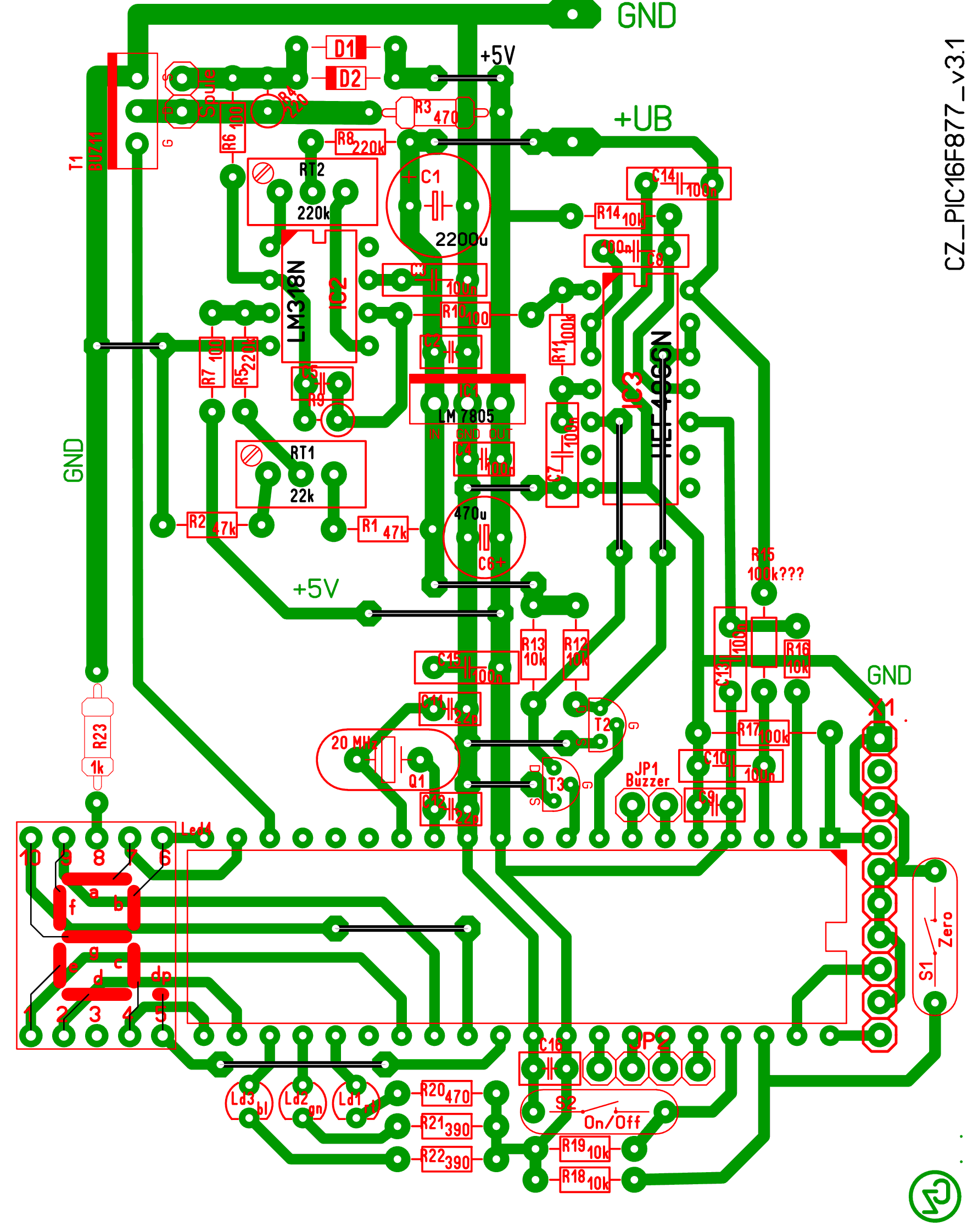

                            What coil is used with this design ?
                              PCB may also bein this way
