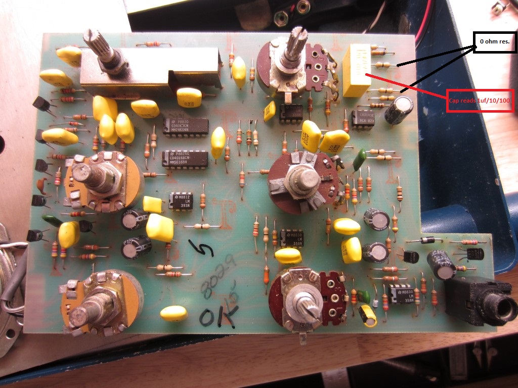

            My TM600 (almost identical to TM800) has a couple things that I would like to verify.
            It has several zero ohm resistor. Why used instead of jumpers?
            It has a capacitor labeled 1uf/10/100. Is that 1uf/10%/100v?
            Last, it has drift when tying to set the null. The threshold goes from quiet to loud. Doesn't matter how long it is on or how many times I adjust it.
            The original owner left batteries to rot in it and there is now a film on the PC board that I washed but the film is still there.
            Ultimately I would like to make a new board, but for now, are there any recommendations? Parts replacement for 40 yr. old components?
            I replaced all electrolytic caps and pots so far. I haven't tested it since I changed caps.
              sounds right to me
              seen single sided board the use 0 ohm resistors as jumper before
              As for the drift I wounder if damp has got inside one of the potentiometers
                Noticed the TM800 only has half the component count of the TM808
                Is the extra complexity of the 808 worth the cost and effort
                      sounds right to me
                      Koala, The pic is of the board before I installed new pots and electrolytic caps.
                      I also installed header connectors (polarized plugs) for the coils/switch/meter/wires, and socketed the chips.
                      I checked the many waveforms and they appear to be as the schematic indicates, but still a drift in threshold intensity.
