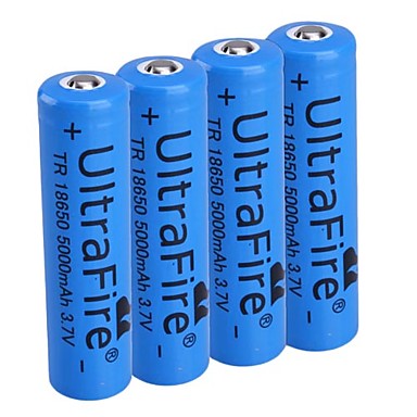

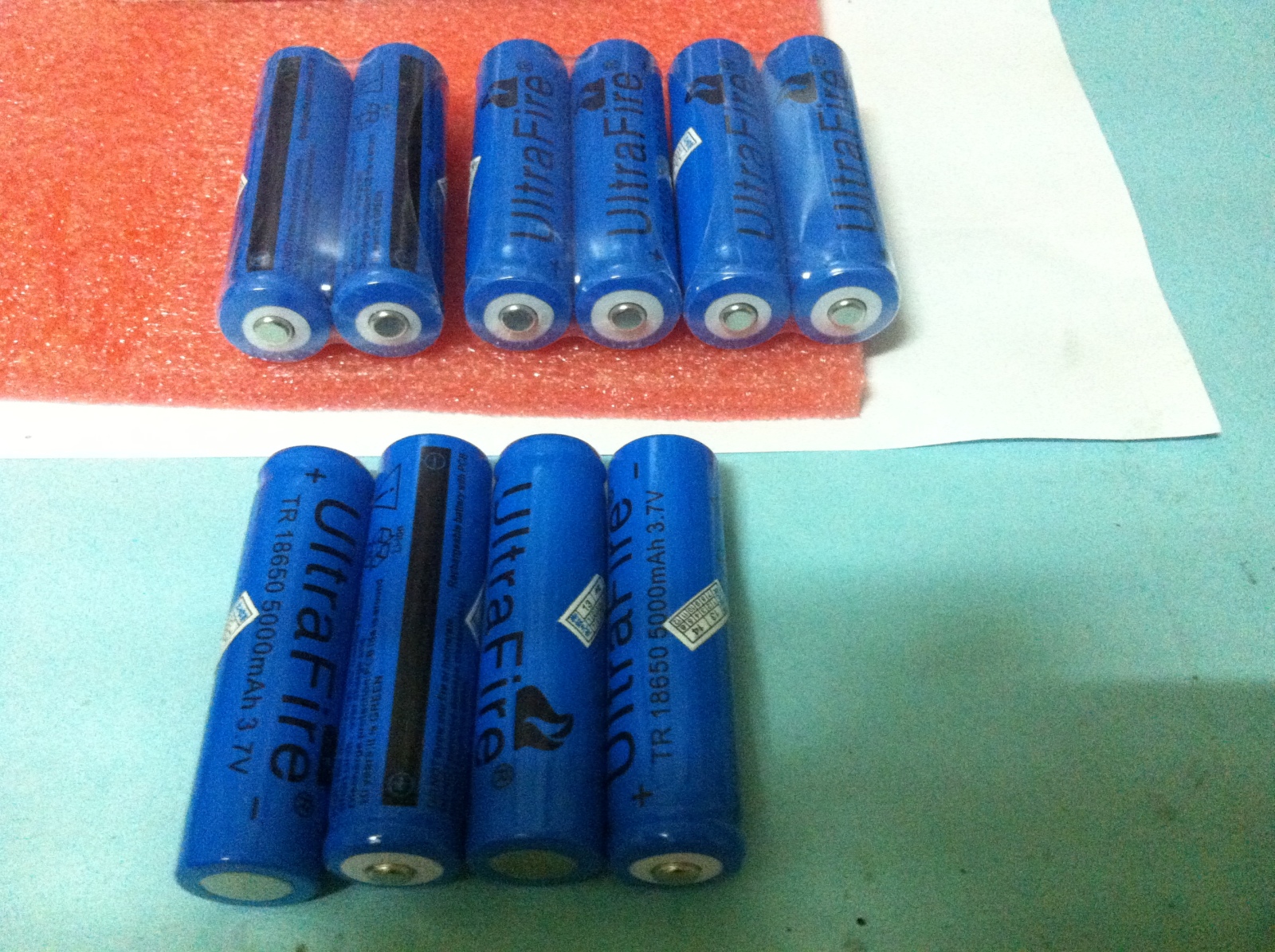

Just buy an rc model charger, popular imax b6ac (or any clone) will be more then enough. First of all DO check the real capacity of your li-ion cells - they are probably plain chinese sh.t, because even the best 18650 li-ions never have more then 3500mah. Most of ebay cheap 'ultrafire' junk is ~600mah, but you can find even 6000mah on the label! here you can see a good example: http://budgetlightforum.com/node/27603

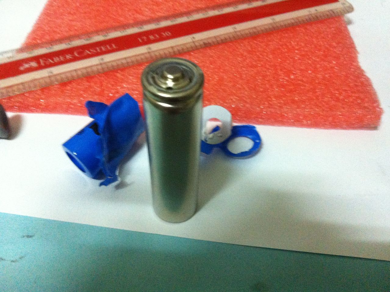

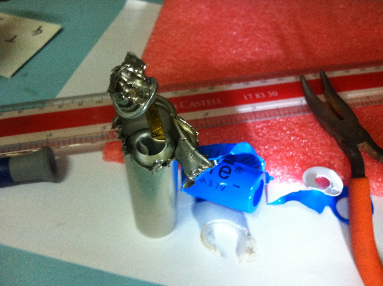

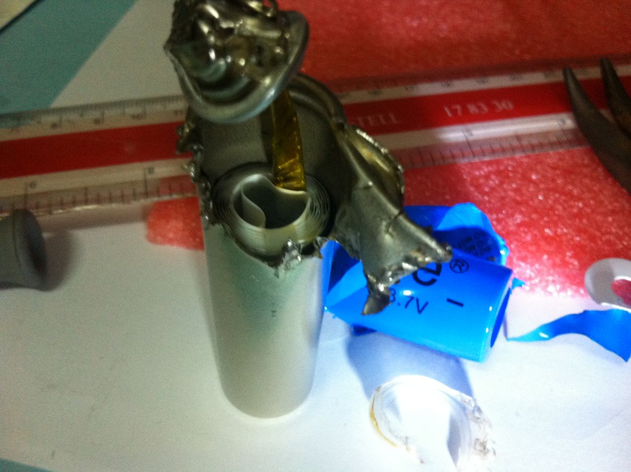

hahah very nice info bro now i will try opeen in side my battery and check what i have in sideOriginally posted by ppodg View PostHi paku,
