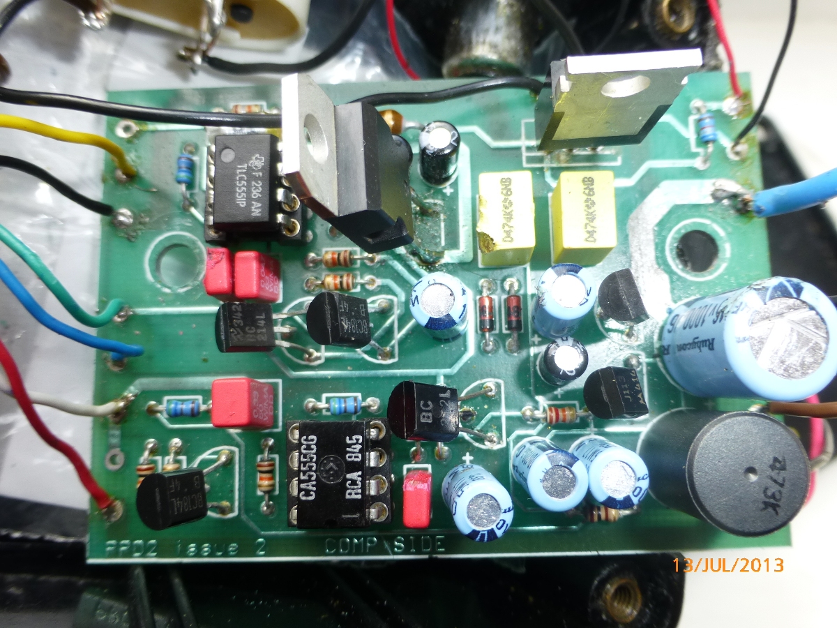

          I have been asked to look at this detector by a long standing user who says the 3 pin power connector had to be replaced. He let his son do the soldering and apparently, got the wires crossed and after switching it on, the fuse in the battery pack blew up. He replaced it twice with the same results and that is all I have been told.
          From the description, it should be a simple and straight job except that it is not. On the power board, I have found the 7912 and the 79L05 negative regulators both open as well as a BC214 tranny. I have sorted the wire connections on the power plug and replaced all the three dud components and the 14/15v from the batteries is now feeding the 12v regulator with the correct polarity but I can only measure a -2v at the output, which in turn is also the voltage feed for the 5v negative regulator.
          There is also a 5v positive regulator that does not appear to have been affected but I am yet to fathom where the supply for this one comes from and this is as far as I have got to so far hence my request for an schematic.

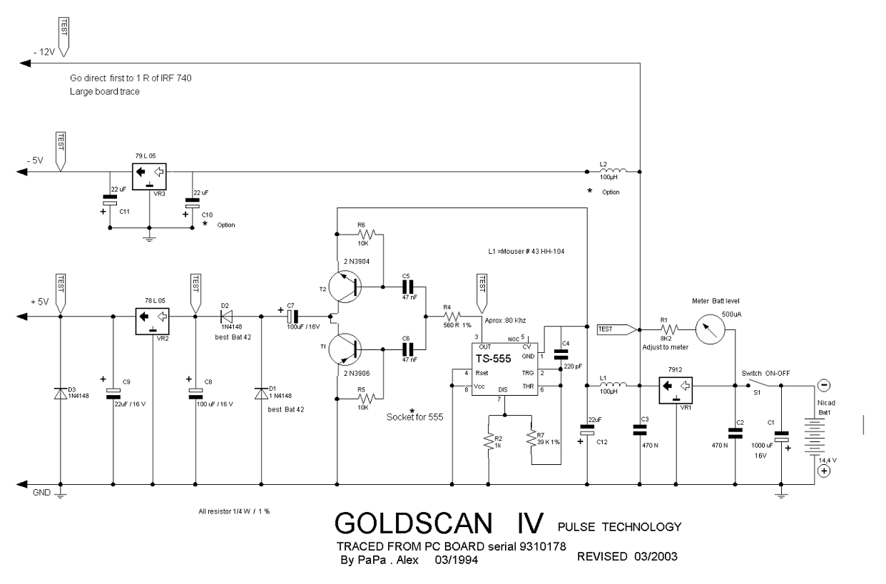

            Here is a cs 6 P.I schematic. Although it does not appear to show a 7912 regulator. Perhaps the goldscan schematic might be of help. Eric Foster designs often share similar elements.

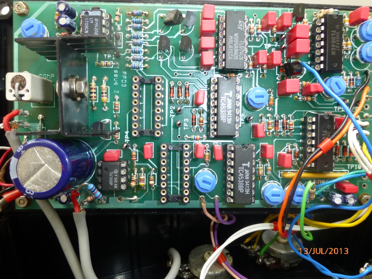

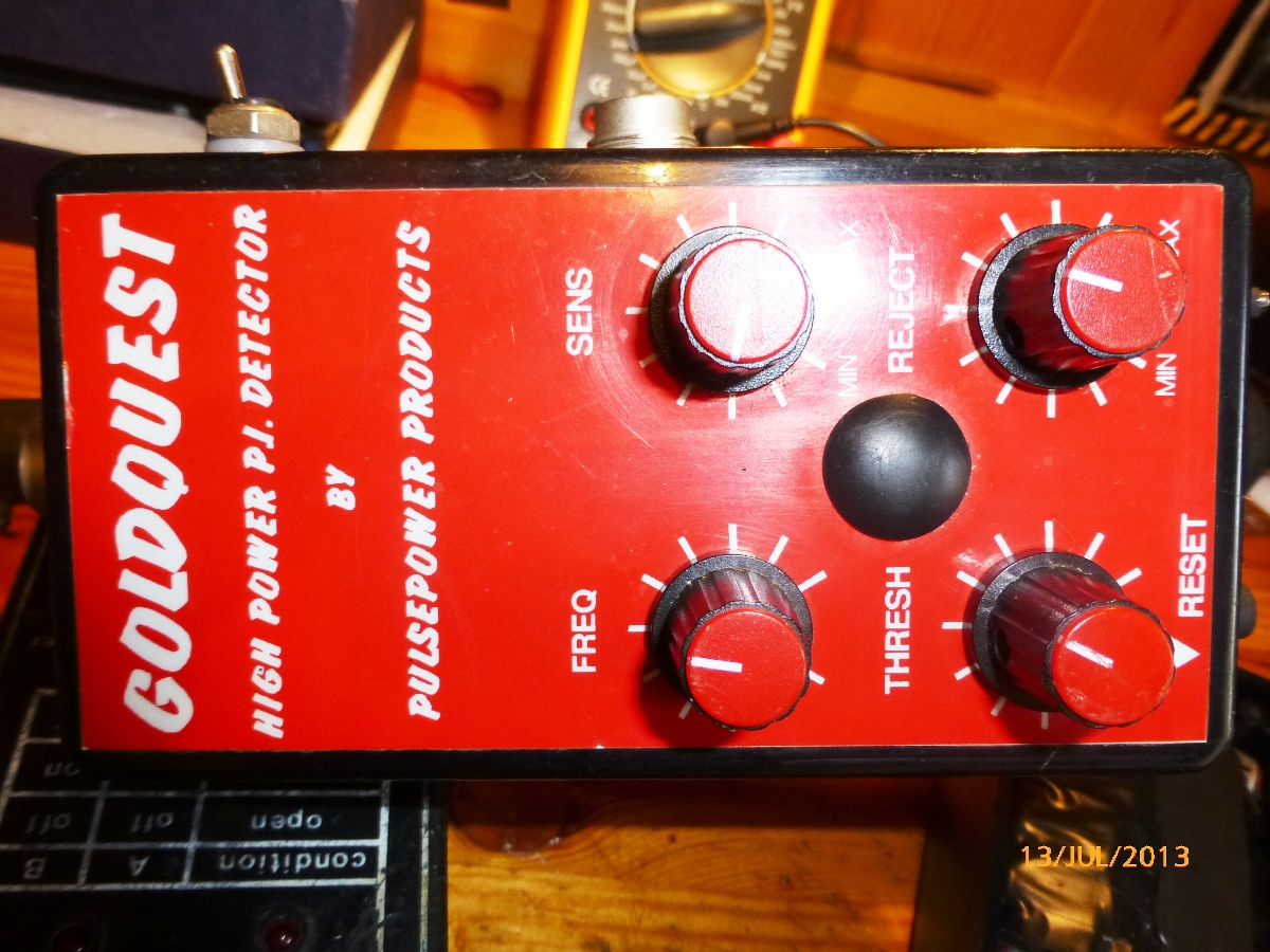

ID:	341248The detector is definitely a Goldquest or that is what it says on the tin but I haven't seen one of these before.
                  Enclosed are pics. of the two mains boards. The diagram of the Goldscan IV power supply board is the nearest to this one but the Goldquest has two timers 555 ics.Click image for larger version

                    You should be able to use the Goldscan 4 schematic to figure out what is going on. The GS 4 has almost an identical layout but has the two empty IC sockets filled.
                    As for your power supply board, one 555 is for generating a +voltage and the other is the audio like what is shown on the GS 4 schematic. So, basically, it is a GS4 with a few mods. I don't see a GB pot so that might be the difference.
                    Eric didn't deviate much in his designs. That is why you can use the GS 4 schematic and be close.
