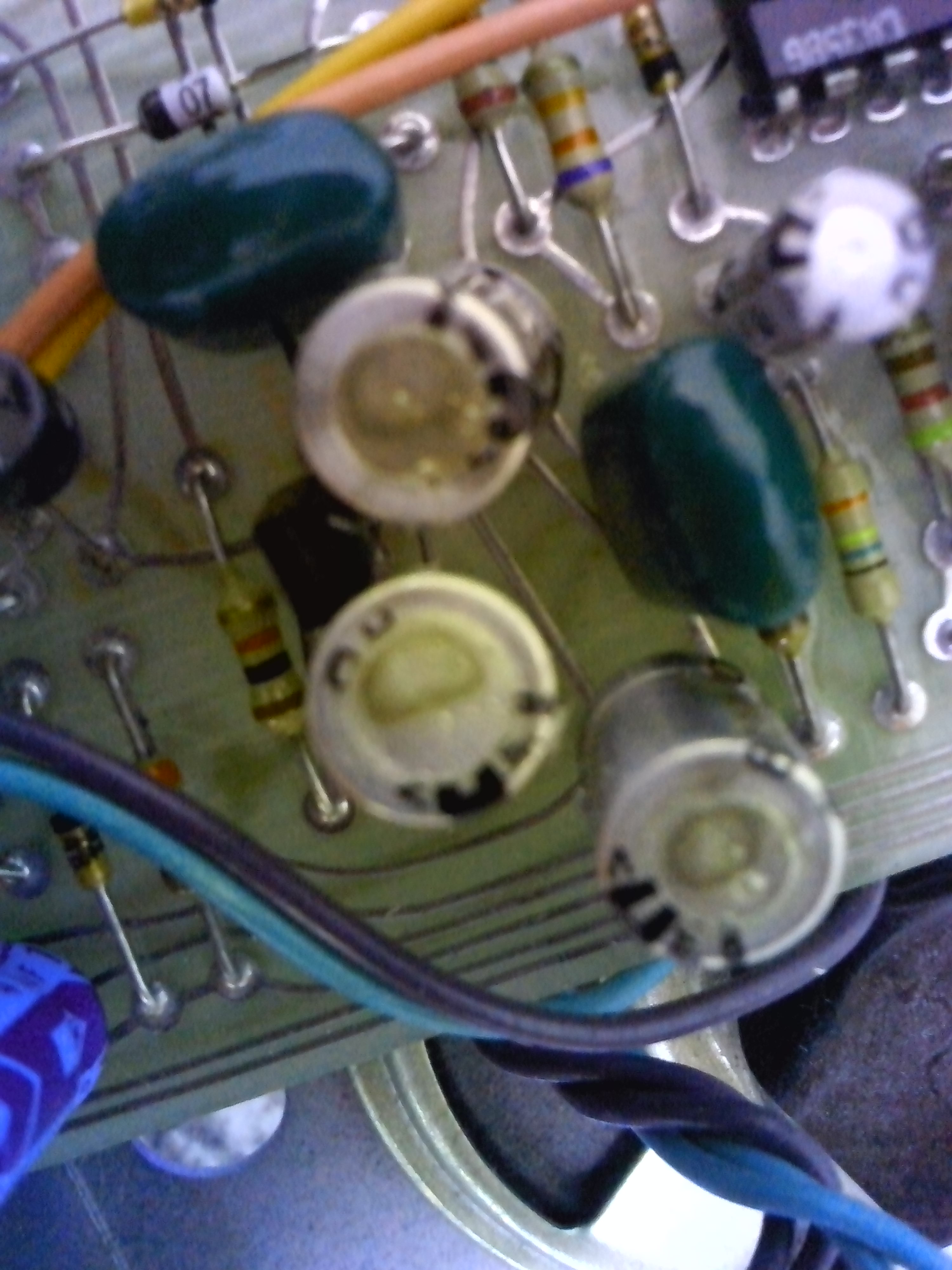

    Hi there ive had this 6DB hidden away for a while now having no luck in finding a Schematic for it, has a mod too
    2 variable pots either side of the coil lead connecter, plus there a 3 way toggle switch that has MODE written above between
    GEB DISC and GROUND BALANCE has anyone got any idea what this is for.
    hope someone can help

      ThankYou for your help, yep the 6/DB G.E.B's are a good unit they were liked as much as the 6000 series which i have 3 of haha an sometimes
      even more with mods done too assist finding gold ect. thankyou for the shortcut as well i have viewed this a few times in the past
      and just now haha as it states there maybe it is a control for positive/negative gain for the coil? woops thats what i get for copying n pasting haha
      but the 3 way toggle switch has got me stumped if its a high or low charge or just a auto ground balance but ive been given a schematic
      ( that Todd given me (( Thanks Again )) its looks like a easy variable fix not all that much to do to it so iam hoping that there isnt to many
      transistors n ics have gone, gee those zeners are strong little suckers even the 1N4148 but the caps need heat sinks on them haha in the gold
      series 6000 theres bubbles with burn marks on top of the caps so if there 85 DEg fail point hate to think what temp they get to have bubbles in
      the alloy tops with burn marks.

        Well caps get old and their internal resistance goes up so they should be replaced every 20 or 30 years or so.
        I haven't seen many with heat damage unless they are at the AC input of a TV or something. The White's are
        good hard working detectors though. I wish I could find the old one my mom had. It was in her attic for years
        but went missing just as I was getting interested in them!
        If you have a problem and or schematic post them up and we'll try to help..
          Heres a Picture of some 100uf 16v caps oh before i forget these arnt in the gold edition 6000D G.E.B S1 its the silver edition Mmm i wonder if they
          anodized the aluminum features silver because of all the mulitiable silver caps inside this unit.Click image for larger version
