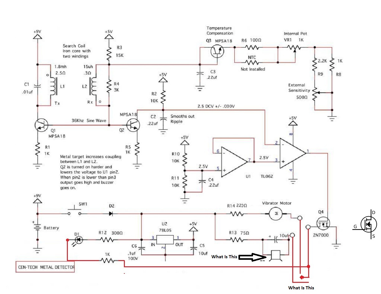

    I need Help
    I Just Edit The Schematic but need to know on this picture
    What Is The Symbol From From This Picture
Name:	Cen-tech Pinpointer By Paku.jpg

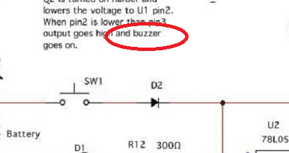

    Looks like a speaker to me. It's right near the vibrator motor too so you can switch it
    between speaker out or vibrator out...
      ok thanks Silver Dollar
      now I can Finish My Layout

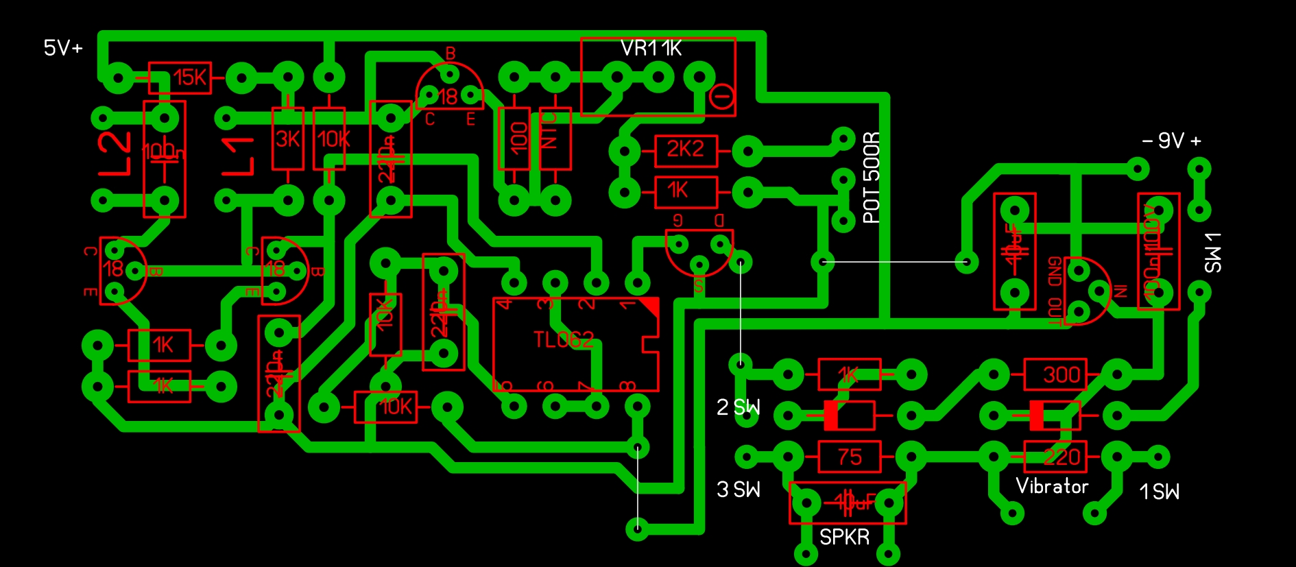

                is this correct pcb or rong
                what Diode On Chematic
                  this is working layout or not
