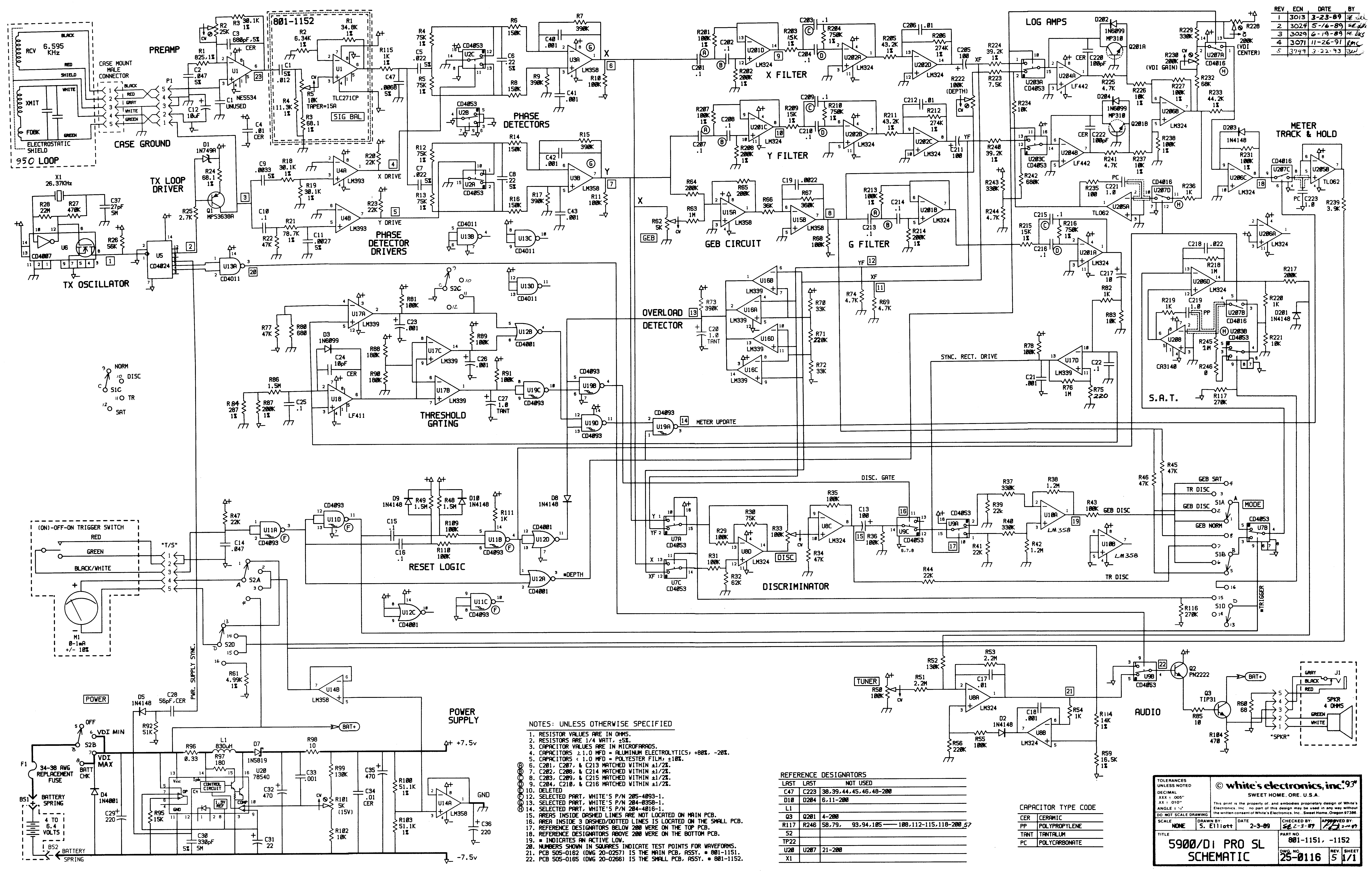

    I have this for the 5900 Di Pro SL;

    It looks like the 6000...
    Oops can you see the pic? I cannot convert it to JPG to show as it's too big then...

        can't see it. Can you zip it?
        click on it and it gives an error
          Thanks, Silver Dollar! I downloaded it. This is going to be a huge help. Now I just have to find a 4900. I have the 5900di pro (but not the SL, which I understand is just the 5900 in a new case.)
          I have compared it to the 6000 schematic. Quite a bit of difference. Even in the audio. For example, I can't find the volume control on the 5900 schematic. They did not use the same audio circuit. Seems like that should have just been a jelly bean dropin.... This schematic is a bit clearer than the 6000 schematic. Gives more information. It is for board 505-0162. my 5900 is 505-0129, so this is quite a few boards later 1989 board number.

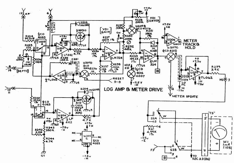

            I found one labeled meter which might just be the meter PCB?
            It was in a directory labeled 6000 so might not be the right one....

              I think there is more to the meter circuit. looking at the 5900 schematic, and a board, it appears that ic's numbered 200 are all on the daughter card.

                Just for reference that drawing came from this patent. DI6000 is mentioned in the citation
