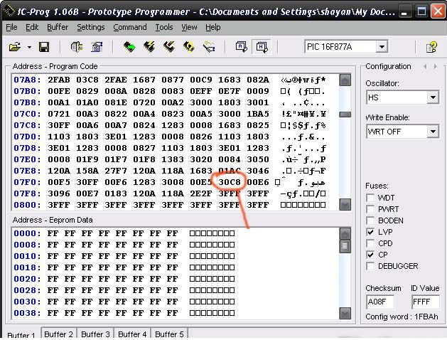

    do you have the full version of hex file for this PI?
      @AurmKid the full version does not matter , it can be cracked to 1024 times or 2048 times instead of 200 i will post that soon , this limilation is only for non-commercial building ( Amateur Customer can not disassemble the machine and re-program the pic PIC18F252) but members here can do it even with 200 on/off limitation just unplug the pic , erase , re-program , and plug it again

        I have disc.hex cracked 1024 from freedan3d. is it possible to use other pic micro?
          no , First the cracked hex from freedan3d works with lcd of 20*40 and it is not stable , the one i posted with attachement is the latest and the most stable for discrimination and as i sad 200 on/off is not a problem for electronic developper and 200 on/off can take much time to attempt 200 time

                  I mean for the hex of delta(post #5), I think this is a best solution for demo hex like DP2+.

                      Nice, but my problem is only the demo hex file(increase the user setting) also in photo bellow the hex they use are not for PIC18F252 and PIC also. see photo below
