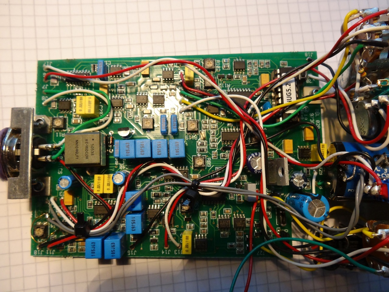

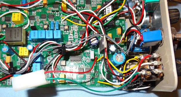

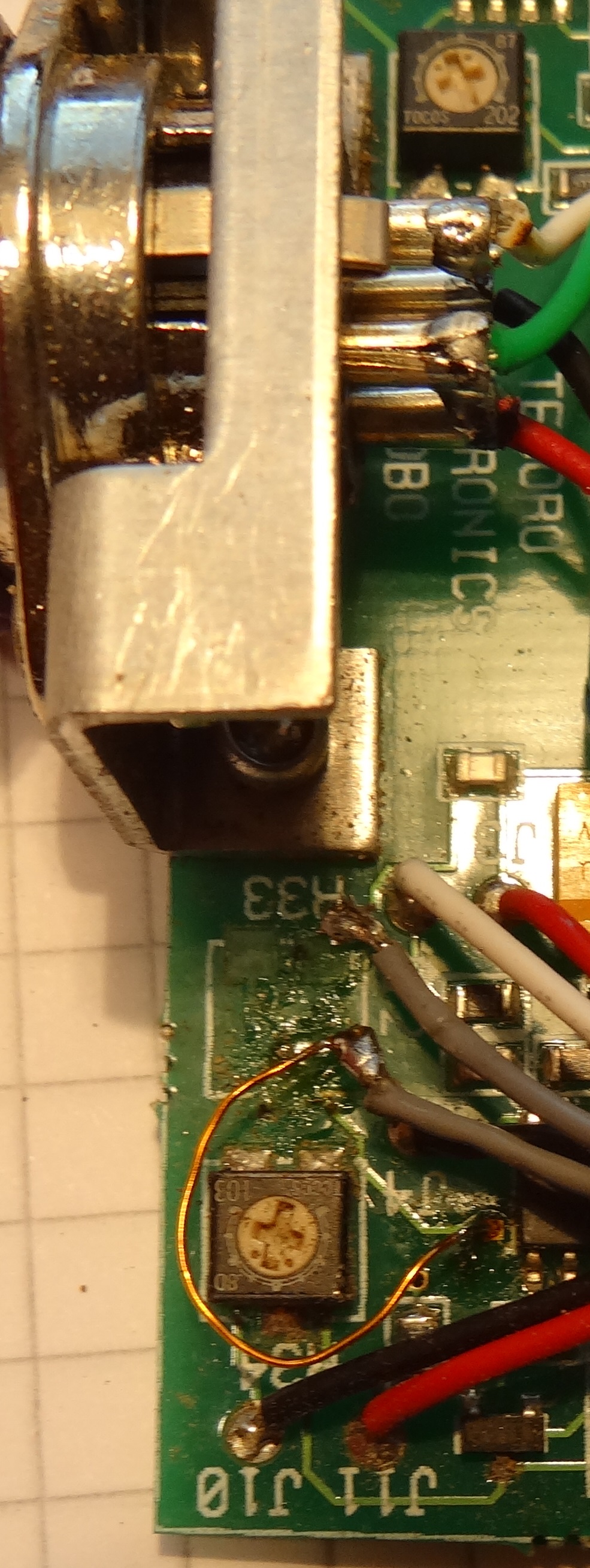

        Here are some PCB-pictures of my Lobo St with extern GB in Disc-Mode.

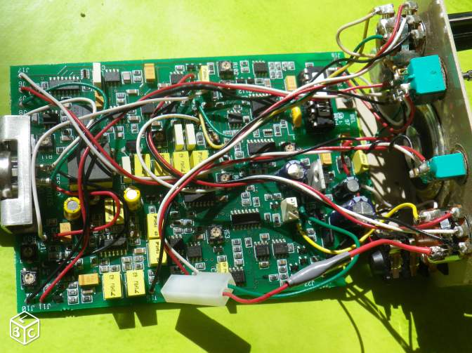

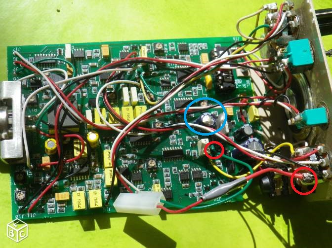

          Thank's , look at my Wolftrac pxcb (Have the seller pics) Waiting to receive at home ^^

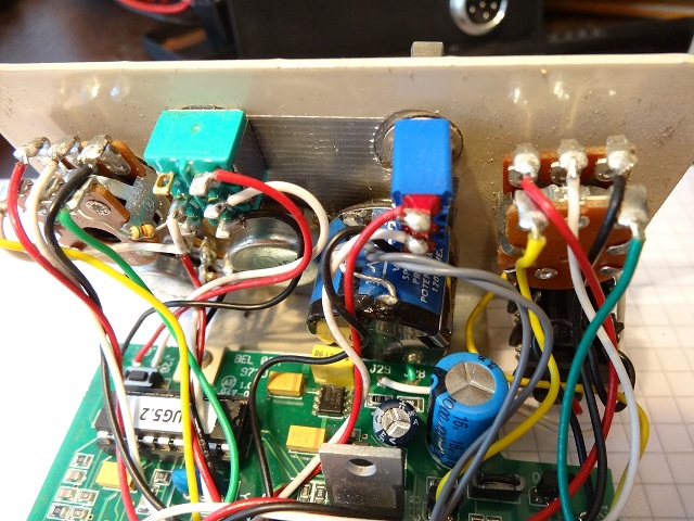

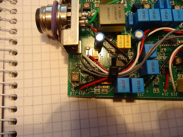

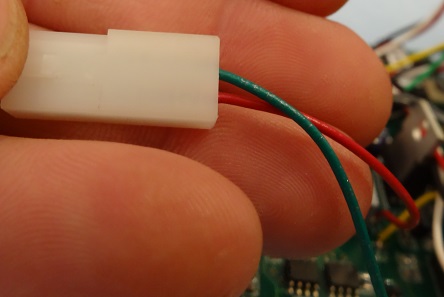

            First you have to change your batterie wires. I have marked them in your picture with red circles. The red wire is Bat- and the green Bat+. Some pictures from my lobo.
            The cap in the turkis(blue) circle looks poped up, you have to replace it.
              Okay , thank's for first diagnostic ^^
              Can you give me the Cap reference please ?
                It is 220 uF 25 V.

                          Check the supplies on the Op-Amps BEFORE you do ANYTHING!
                          I'll lay odds that the 7660 voltage inverter IC is the problem. Common problem on any Tesoro which has had batteries connected the wrong way around. Especially great as Tesoro do not include any reverse voltage protection on any of their machines. That said Tesoro make AWESOME machines, none too deep, but they deliver the goods again and again!
                            Hi I had a mate who burnt two lobos out. Both times I changed the low drop out 7805 regulator and smd lm392 close to the 7555 timer ic and they both still going strong.
